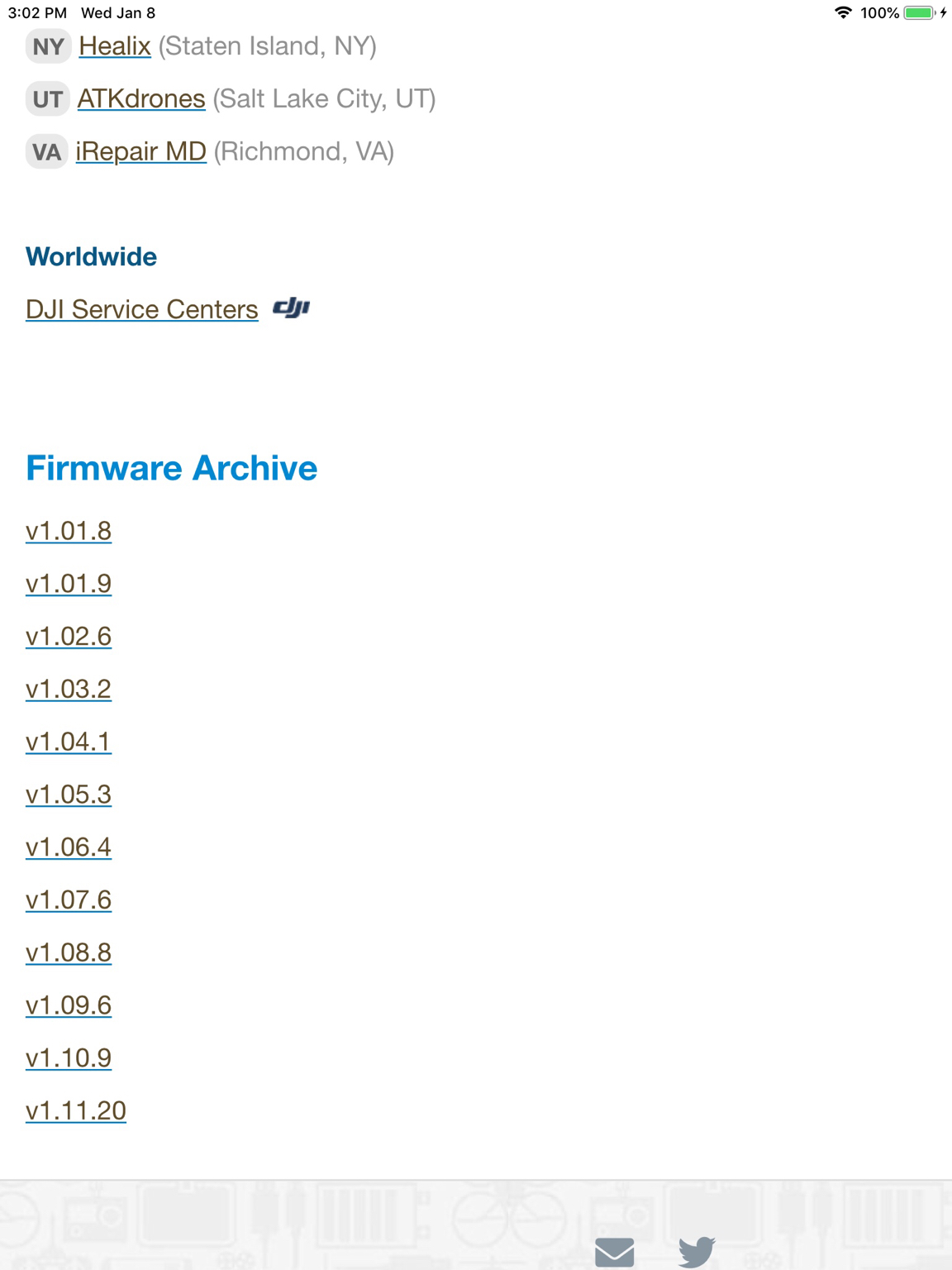

These are the firmware versions for the P3Pro on phantomhelp.com.
Reactions: KachemakDiver
Can i ask mate how u got them up on dji
> DJI has historically maintained an archive of FW versions on their site even though they don't always show links to them. For archived FW versions directly from DJI, follow the links in this post. Obviously use the links listed under your model. In your case use those listed under Pro.
