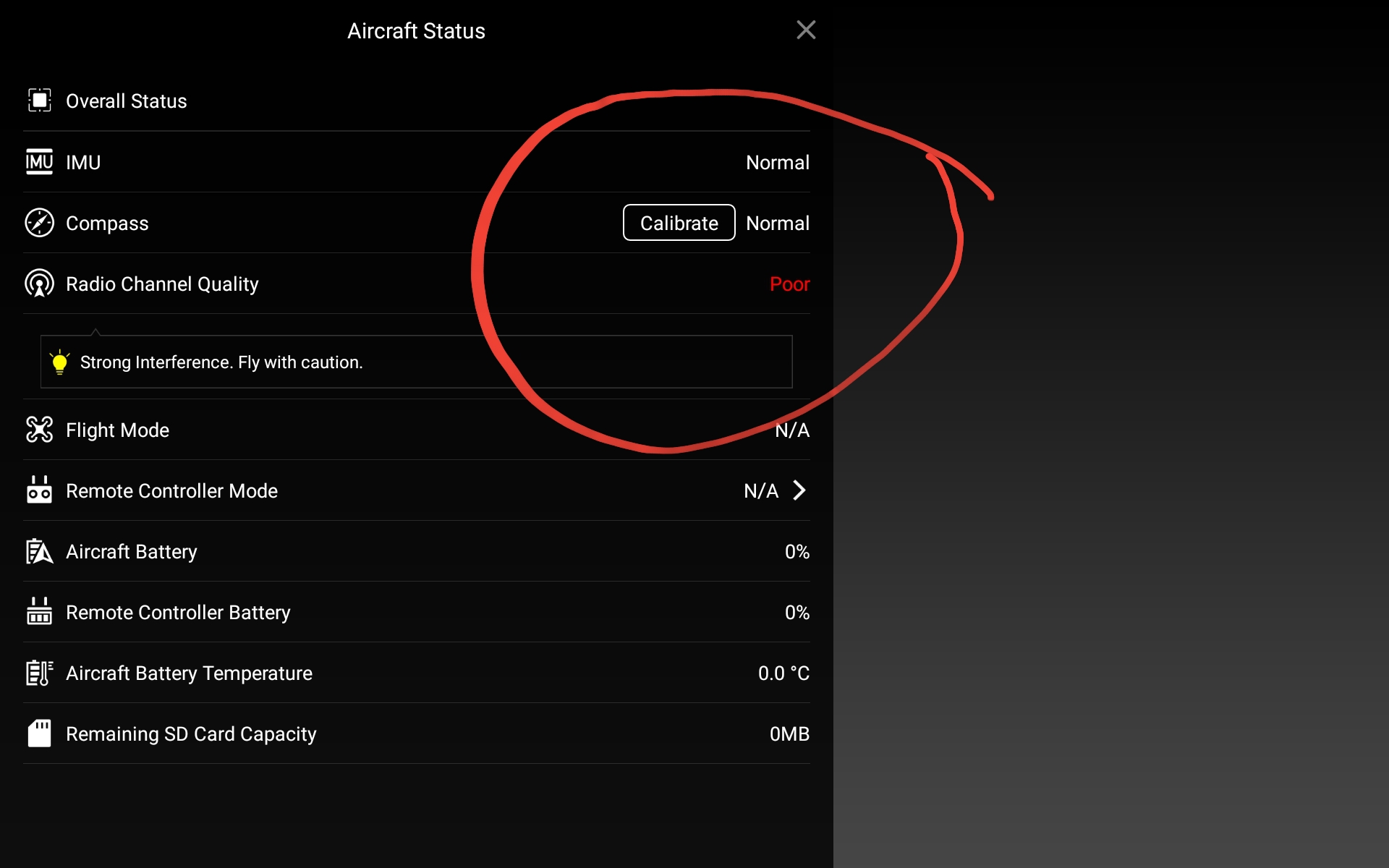

Yes calibration in open area if having a issue but should be fine at your house outside,,are you calibrating just cause it comes up when app opens or prompt on screen or a warning flash from your drone lights at rear,,if your getting atti mode when doin this ,your drone cant find satellites to get a lock ,,,mayby a screenshot of what you see to make you calibrate will help diagnose your issue,,,when it flys is it normal,if so the compass is fine,,if it all over the place and hard to control the compass needs doin otherwise dont touch it,over calibration not good either and hardly required...and dont calibrate inside the house.....added this picture,,,,is this what you see on start up ,,if so this is normal

Yes calibration in open area if having a issue but should be fine at your house outside,,are you calibrating just cause it comes up when app opens or prompt on screen or a warning flash from your drone lights at rear,,if your getting atti mode when doin this ,your drone cant find satellites to get a lock ,,,mayby a screenshot of what you see to make you calibrate will help diagnose your issue,,,when it flys is it normal,if so the compass is fine,,if it all over the place and hard to control the compass needs doin otherwise dont touch it,over calibration not good either and hardly required...and dont calibrate inside the house.....added this picture,,,,is this what you see on start up ,,if so this is normalView attachment 119057
Thank you for the explanation. Yes, this is the screen I get. Making the assumption that it tested the compass and the highlight indicates the need to recalibrate. Seeing posts showing a lot of Phantom 3 Pros with bad compasses in manufacture.
Apparently a newbie issue. Just not aware this is normal and needs no action.
Appreciate your and other’s response on this question.
What makes you think it is requiring you to calibrate the compass? We’ve seen others think the same only to realize later that it wasn’t so.
Making the assumption that it tested the compass and the highlight indicates the need to recalibrate. Just not aware this is normal and needs no action.
