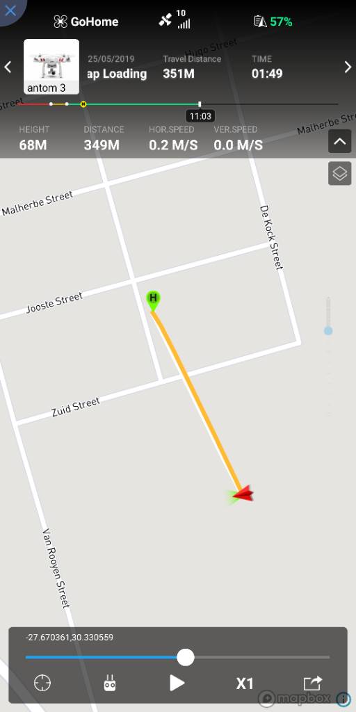

Mine did it too, sometimes even less than 100m, mainboard is fine... antenna connections on 5.8ghz signal gone bad, removed the glue on the connections, washed the u.fl connectors with isopropylol alcohol. And tested this weekend... Usually i got around 200m in an open field with a CE rc.. well i pushed it to 350m over the weekend.. might be a good idea to replace the antennas, which will be my next step.
