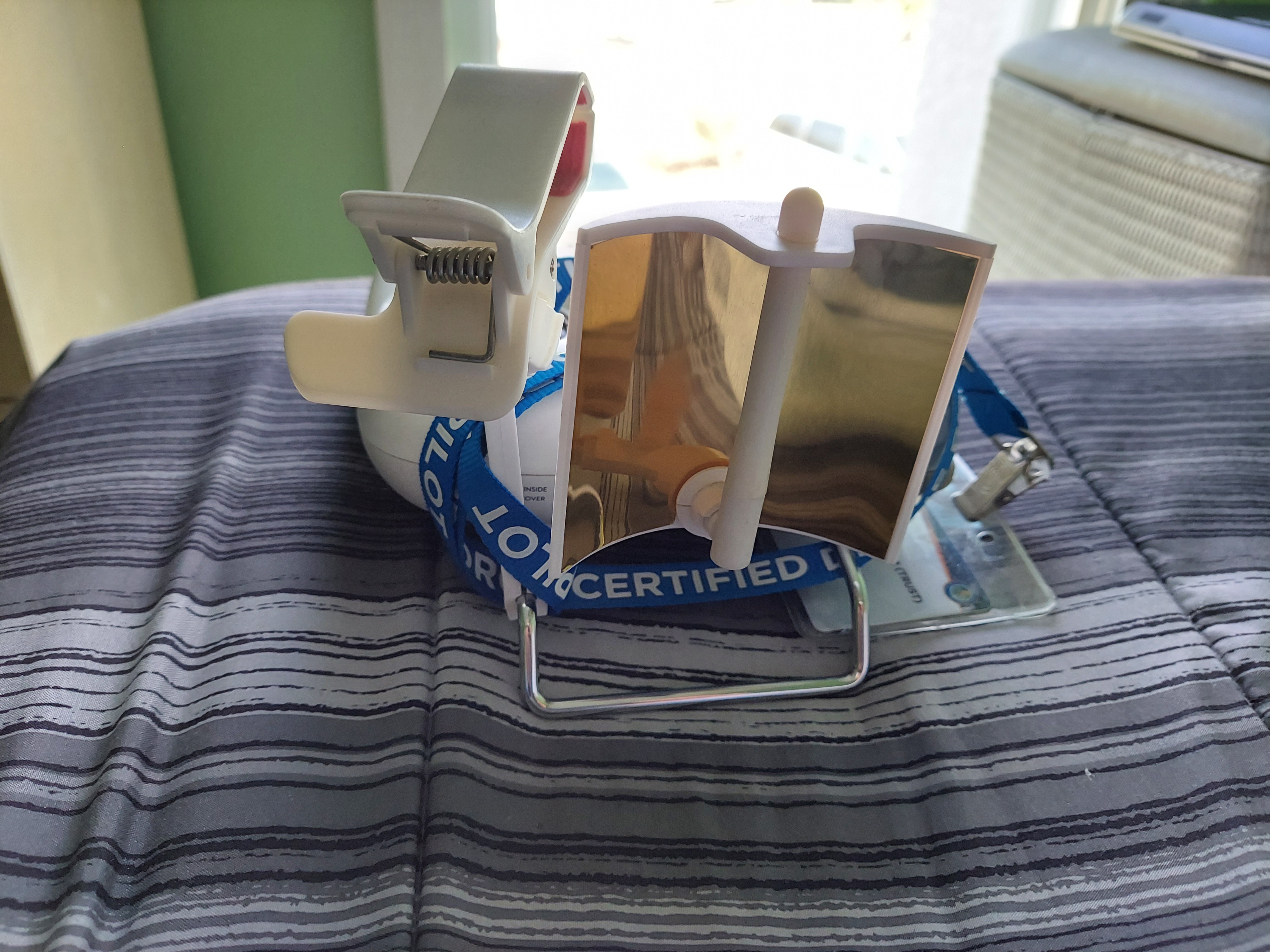

HI, I like flying the P3s down range. navigating by camera. Without a signal reflector at about 2000 feet (609m) down range it looses video not RC signal. I use a reflector about $4 on Aliexpress. At 400 feet (122m) altitude over a lake I get about 6850 feet (2088m), over the dessert and mountains about 5800 feet (1768m). Downrange I loose video feed before I loose RC control so need to return home because I cant navigate using the cam. A good quality signal and video booster may get you more range because this is a complex signal, as I understand it the RC signal is 2.4 Ghz the video 5.8 Ghz. My Mavic will fly significantly further but I prefer flying the larger P3s especially in the mountain winds where I need to go up 1800 ft to clear peaks.

I would go with an ITELITE as mentioned in post #2, but it's hard to find a good mount for the P3S controller.
The P3S is a lot like the P2V series. Control is 5.8 ghz. FPV is 2.4 ghz.
The control signal transmits from the stick antenna. The FPV signal comes from two patch antennas hidden inside the controller facing forward. This means the parabolic deflector will potentially increase range for control but won't do anything for your FPV.
In the photo above, the deflector is blocking the front of the controller. Not good!

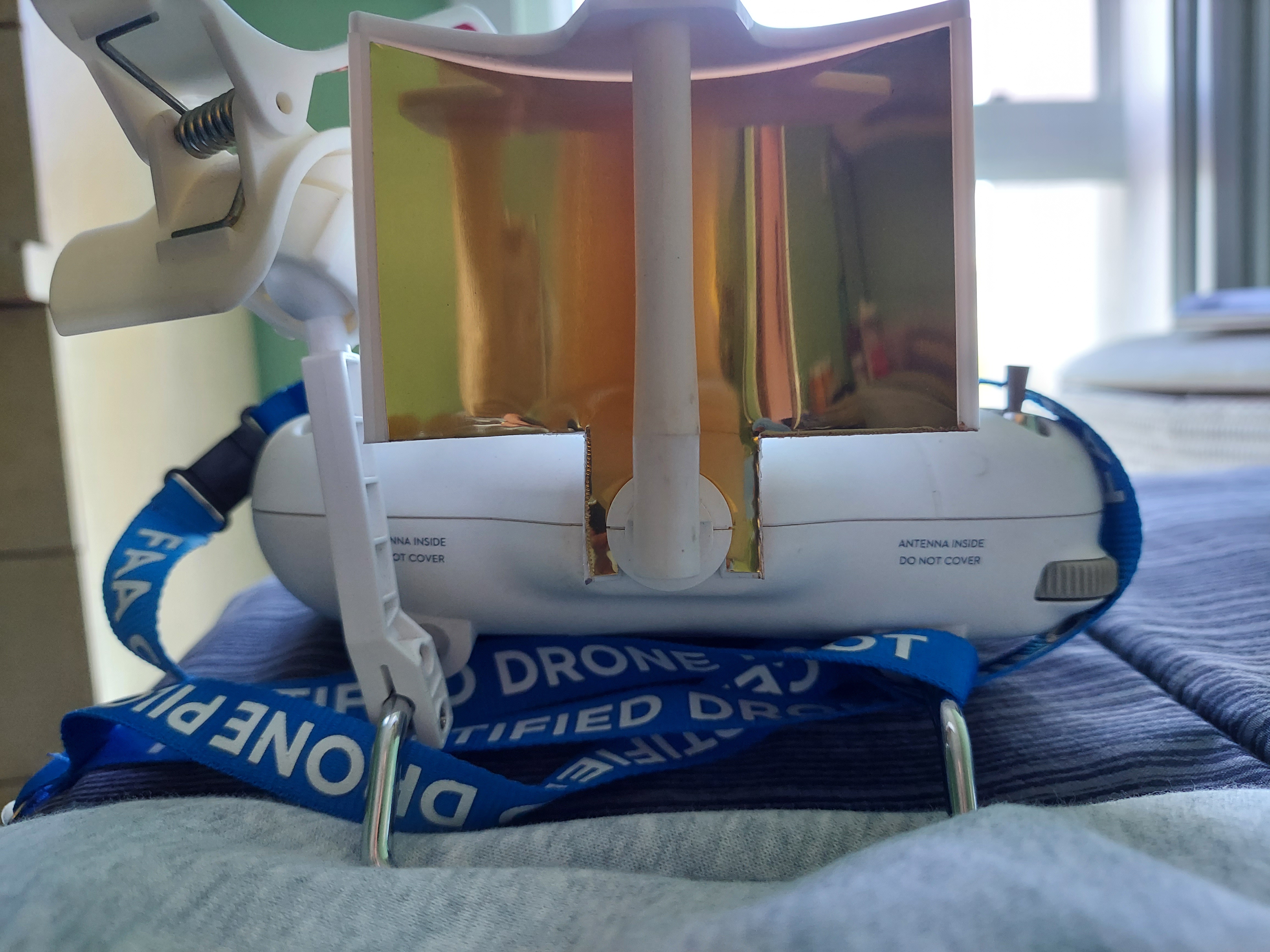

Thanks so much, I missed that. I cut the reflector back away from the 5.8 Ghz antenna. Now to do a full up range test next flight.
