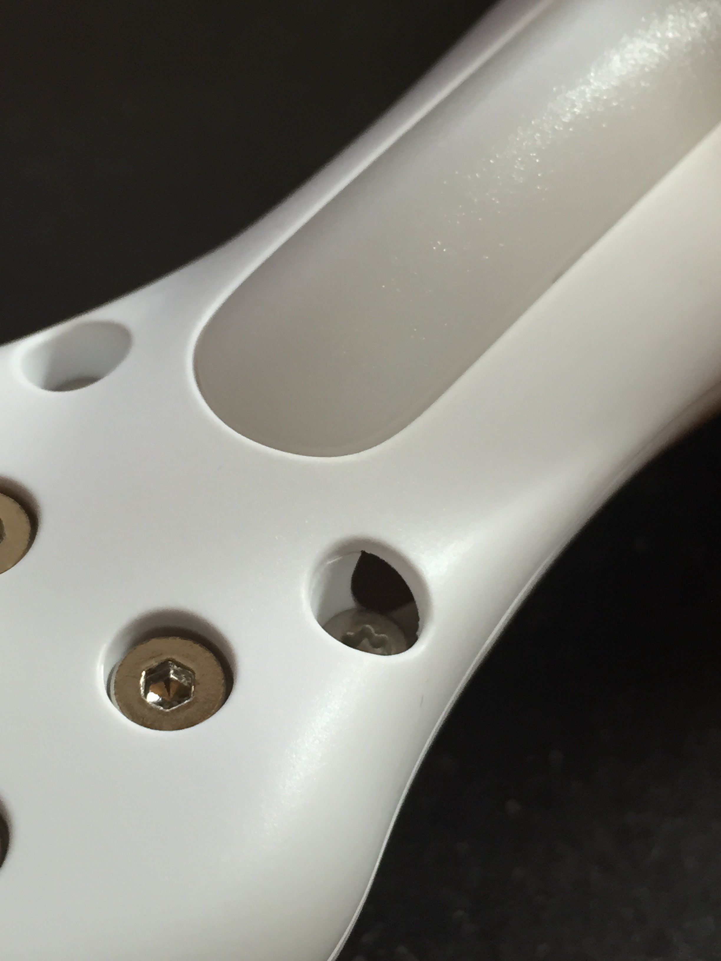

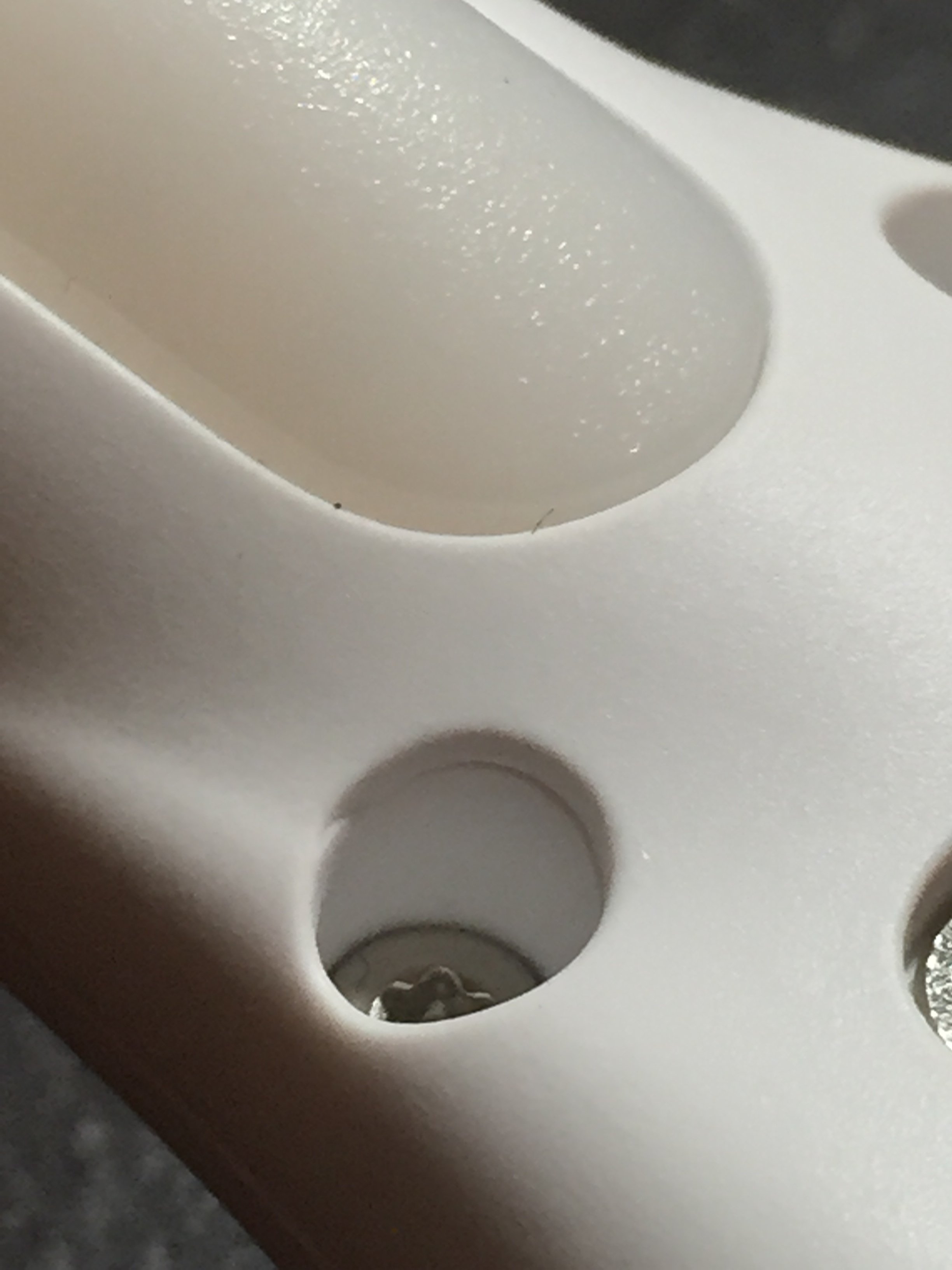

My P3 arrived yesterday. Flown it a few times for 10 minute flights. Looking at my rear arms one of the screw holes looks like the plastic is slightly different as if there was a defect in the mold. Similar shape to the photo above but not quite got a crack that I can see. I think I will cable tie all 4 arms to be safe.
Same with the new one DJI sent me. I'm ruing zip-ties just to be sure.
I'm the guy you're talking about. My new unit doesn't have stress cracks like I stated in the video, but the right rear arm, inside screw hole has some mold marks in the EXACT location my first unit cracked at. It's hard to see in the video. I wish you guys could all see my P3 in person.

Exactly the same as me mate, as shown in my picture. Will get the zip ties on today to be safe.
