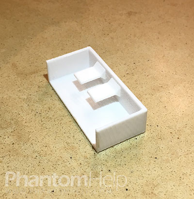

Can you disclose the thickness of the male plastic blades that slide into the female battery contacts? What is the thickness of the Phantom male brass contact in comparison? It appears the end of that plastic blade looks square instead of tapered like the Phantom male blade. Can you provide a closeup photo of the end of the plastic blade?
Interesting product, nice idea. However I'm hesitant to insert plastic into the brass contacts, introducing the possibility of plastic wear residue on the contacts over time. However I might be too **** on that concern, not sure. I've never seen anyone else do this, thinking there might be a reason. Too bad there's not another way to securely clip a cover over the contacts without the need to insert plastic into the female contact.
They are about .1 mm thinner than the blades in the Phantom.
Here's the model:
I wonder if having the spade "pins" a bit shorter would be a good idea. still enough to grab
I think I could make them a little shorter, but probably not much. I don't think that'll make them less prone to breaking though. I went through about 10 iterations until I came up with this design. Applying excessive force to the side of the plastic pins would definitely snap them off -- but, you'd have to be trying to damage them. They are pretty strong.

I like the idea of making them a little shorter. But I suggest consider making them .5mm or .7mm thinner and see if they stay in place, the thinner the better, while providing enough friction to hold them in place. I'd also recommend tapering the end a little for easier insertion, less stress to the Phantom contacts and less wear to the plastic that might leave residue. Something similar to this below, left side.
Thanks for the ideas. Keep in mind that making parts thinner often makes them more brittle. I'm always up for some experimenting to make the parts better though :)
I would also be worried about wear on the gold plating by the plastic which typically is rather abrasive.
