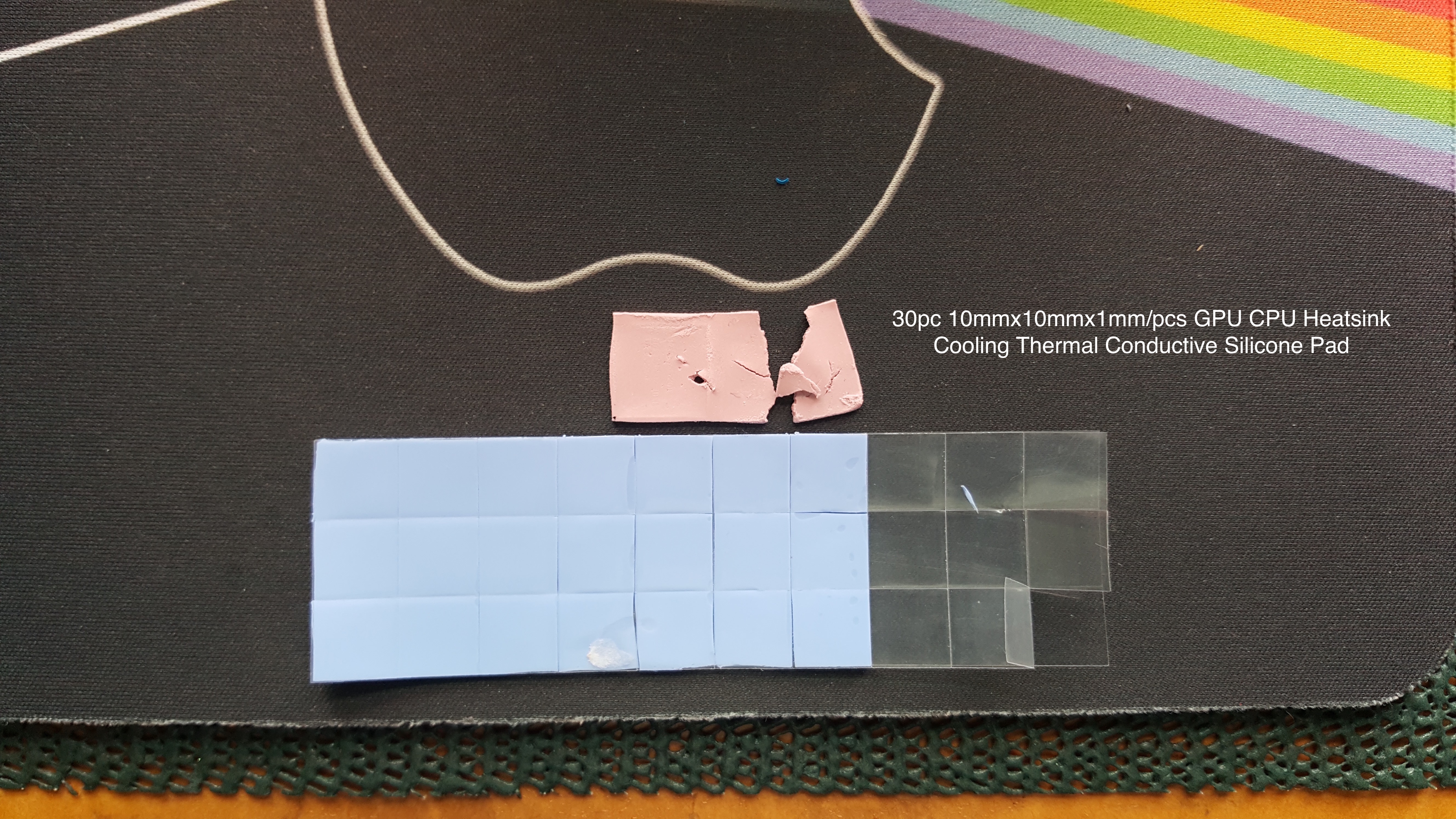

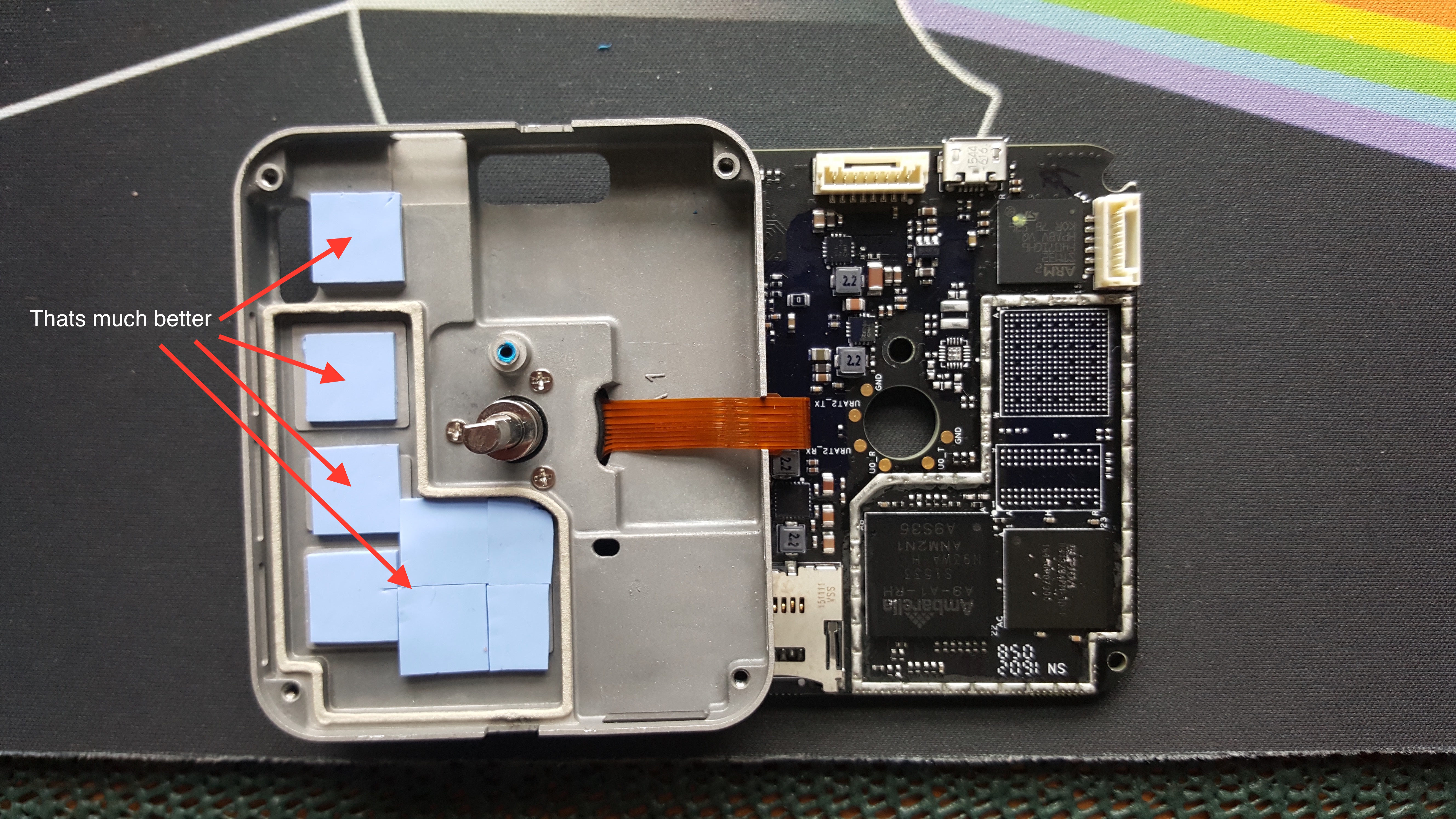

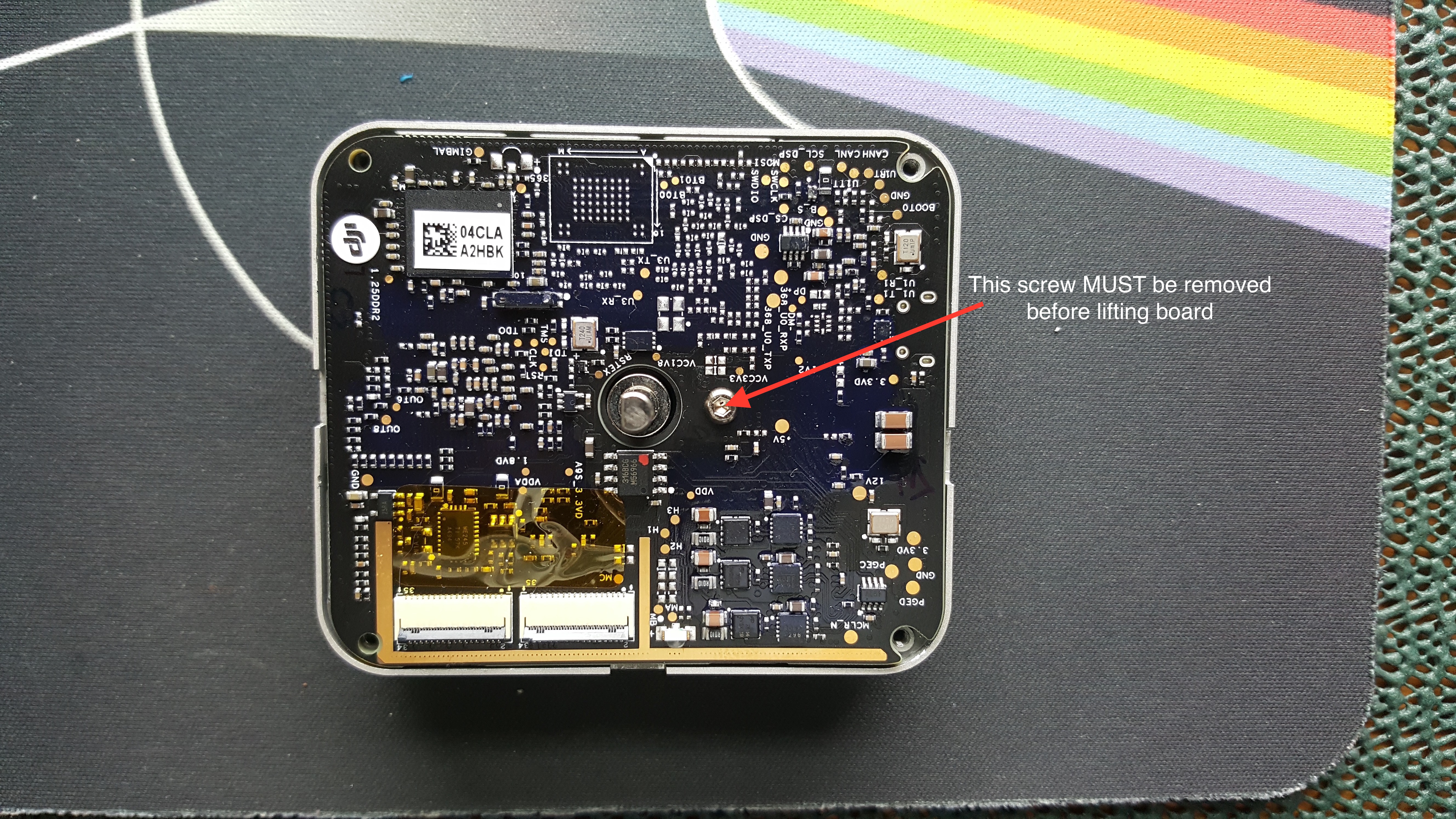

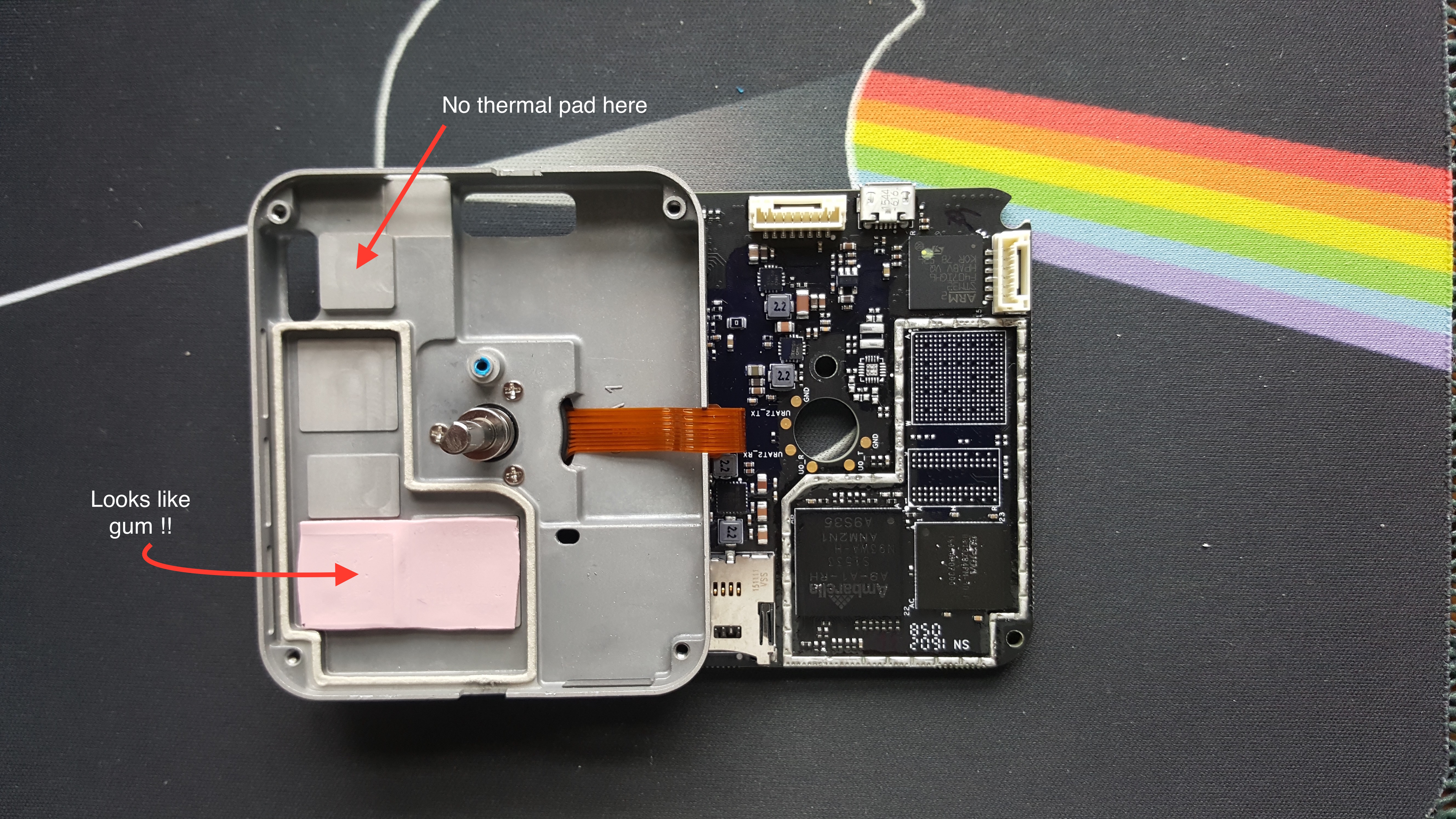

    I have a 4 month old Phantom 3 Advanced and I've noticed that the lag on my Nexus 7 2013 (unlocked & rooted) has become worse,about 4-6 seconds.
    After much interweb searching, I came across a piece by Godfear17 and his approach to the video lag which involved stripping down the gimbal and adding/replacing the thermal pads.
    The thermal pads were ordered off Fleabay for the price of a beer and I set about doing the job.
    It is not that difficult if you take your time. I have tested the video link to the tablet and can confirm there is now NO lag. This fix DOES work.
    I have attached a few photos which may help anyone attempting to have ago.

    I believe the Arm2 chip is overheating due to there being no thermal pad between it and the heatsink.

    So the assumption is there is no thermal bridge to take the heat from the chip to the heat-sink (which would then transfer it into the atmosphere)? That would definitely cause over heating on the chip for sure. Maybe the person responsible for applying the thermal pads had to take a PEE break and the production line didn't want to wait :)
