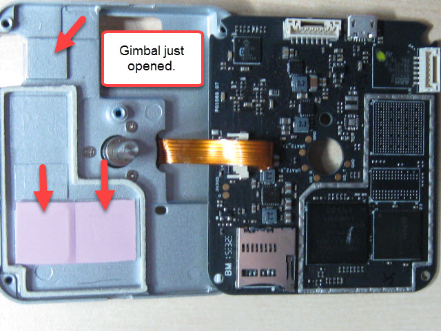

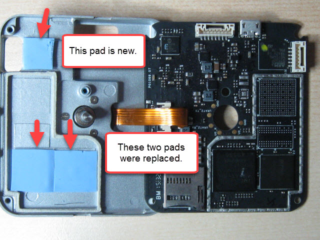

GodFear17; Update: I received my blue thermal pads you said to purchase for the fix for the gimbal. I opened the gimbal and added one pad, and replaced the existing two pads. I notice you did the same. My reasoning is that since they possibly skimped on not using one small pad, that they may have skimped on the quality of the existing pads. So, I replaced the existing pads as well. I put it all back together and took it out for a test. All went well. There were no problems. Fortunately for us in Southern California, it is cooler this week. So, as a result, I had no problem with lag as it was only 81F when I left the park. But, next week it will be up into the triple digits again. I will test it then and let you know the results. Thanks

Hi. Can you tell me if the task of gimbal opening is a simple one, and how the old pads are removed and the new ones attached. Visually what is the difference between the old and new pads? Thanks
Opening the gimbal for me was not difficult as I have been in the gimbal before. It does help to have experience and that would be a question that only you can answer based on your experience as well as your level of expertise in performing what I would call micro electronic repairs.
How old are the existing pads? I don't know because I am not familiar with what would constitute a new or old thermal pad or if it makes any difference in the use of that pad. The visual difference in the pads are the color. The existing pads were pink and the pads Godfear17 suggested I purchase are blue. Neither of them appeared damaged or worn.The pads also appear to be consistent in their thickness and quality. But, then again, I am not qualified to determine if I am right or not.
I'm sorry I can't be more specific and help you more with you questions. I am basically performing a repair and using information and objects for that repair that have been recommended to me. I did the repair and will next week when it becomes hotter, perform the test to determine the results of the repair. I will be posting back my findings then. Thanks.

Nicely done!! I was having lag even in 80 degrees at night but this fixed all my lag issues I suspect the arm2 overheating but could of been any of them but at some point even dji thought the arm2 needed a pad
