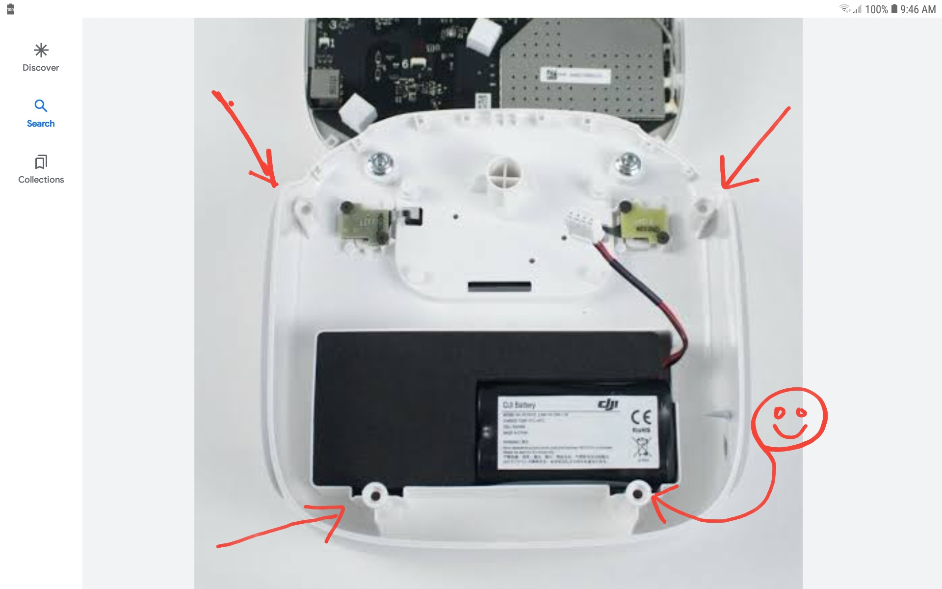

I see post about unplugging the battery in the remote & then reconnecting to resolve this issue but how do I do that please?

Pretty easy,,4 screws on back of remote, use ,multimeter to check voltage ,,its possible its voltage is to low for dji charger
