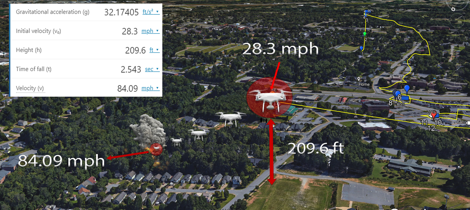

The data shows that your max. speed was nearly 40 mph.
The max speed for this flight was 29.3 mph
Is that possible?
In P-GPS mode with obstacle avoidance disabled, the drone can fly at 36 mph.
With a strong tailwind, it can go a little faster, getting close to 40 mph.
But in atti mode with a tailwind, it can fly a lot faster.
68.7 mph! Woah.
But...
I'm afraid I've got you beat.
The problem with that calculation is the assumption that the falling Phantom accelerates at 32 ft/sec²
Analysis of flight data from several Phantoms that fell without losing power has shown that they quickly reach a terminal velocity of 35-40 mph due to air resistance which you haven't allowed for.
The terminal velocity varies as the drone tumbles and air resistance changes with the varying cross sectional area it's acting on.
