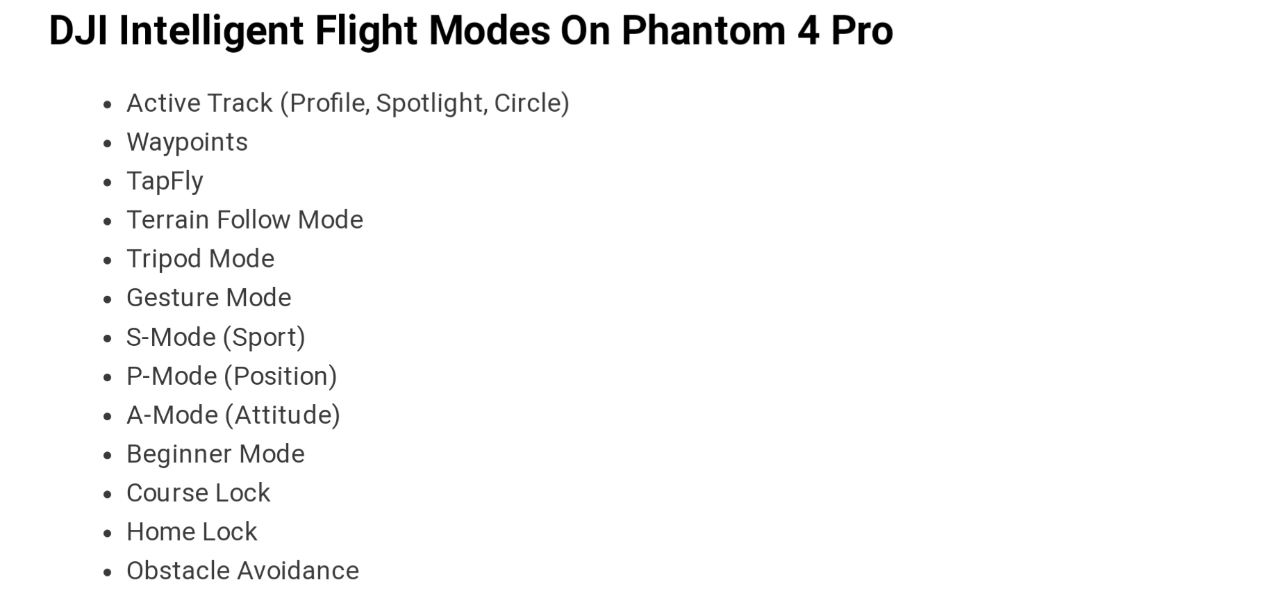

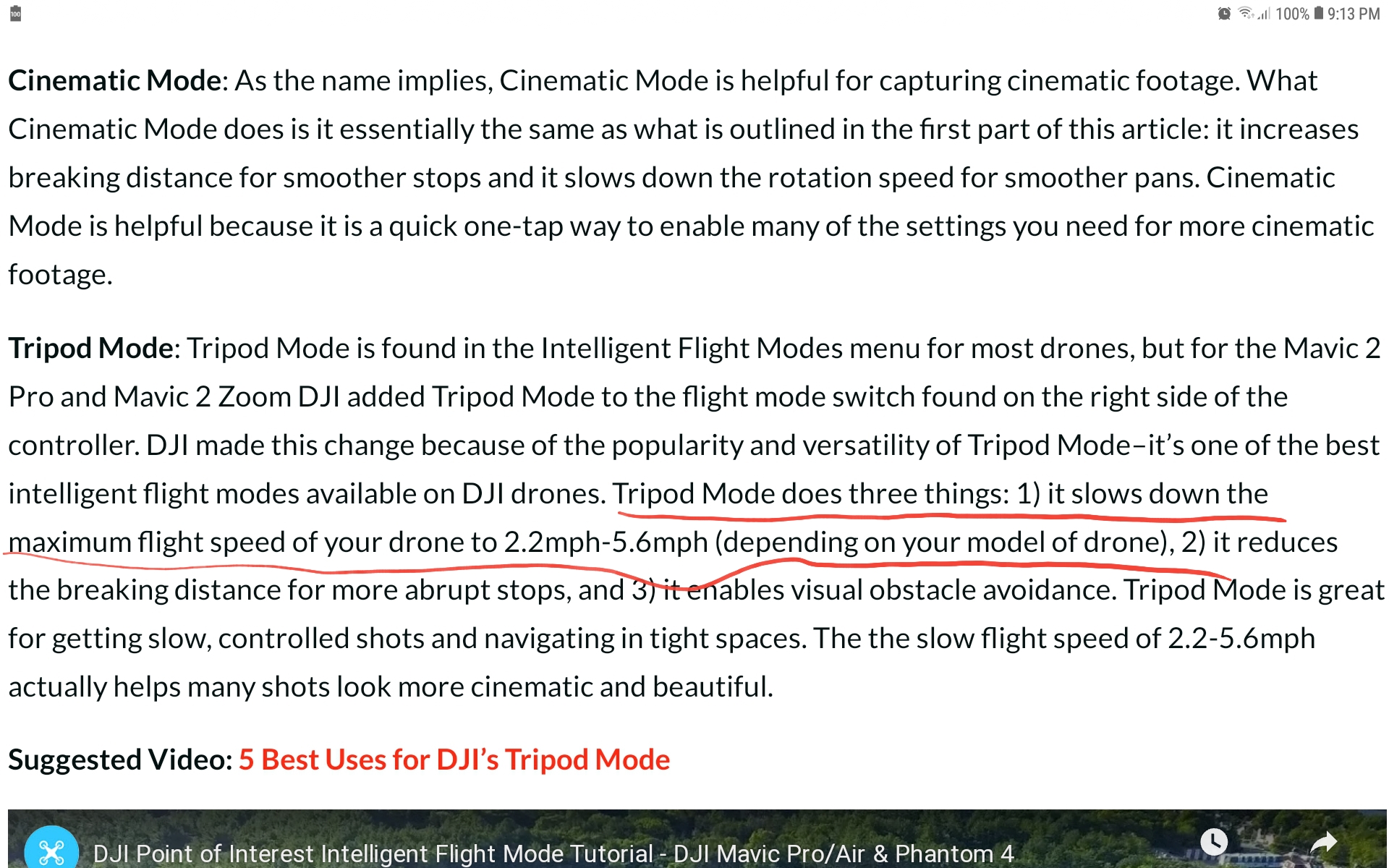

Not sure if this help or not but tripod mode,,there's no way to actually have a speed limiter
EXP Settings can control how much in stick movements but not a flyaway top speed except a CSC emergency shutdown in mid air if it even responds to the command in that situation........
.........?...?something like what your asking will need to be in the software for such a action from the drone,,,,,
Thanks @ianzone, I thionk that might be just the ideal option, I will be flying ina failry constrained area with infrastructure etc so this speed limit option would be simple and ideal. The requirements just ask for a speed restricted operational mode and I think this will work. I haven't really used the mode as yet...Seems a good fix
