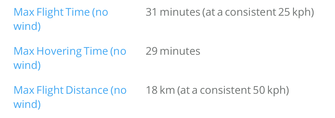

There is, as you orobably know, a lot more factors. Interesting that DJI actually quotes max distance and velocity to realise it for the mavic.
Other than flight time I couldn't find the corresponding values for the P4P. Indeed, aerodynamics, and efficiency plays here, where the m2 has advantage.
