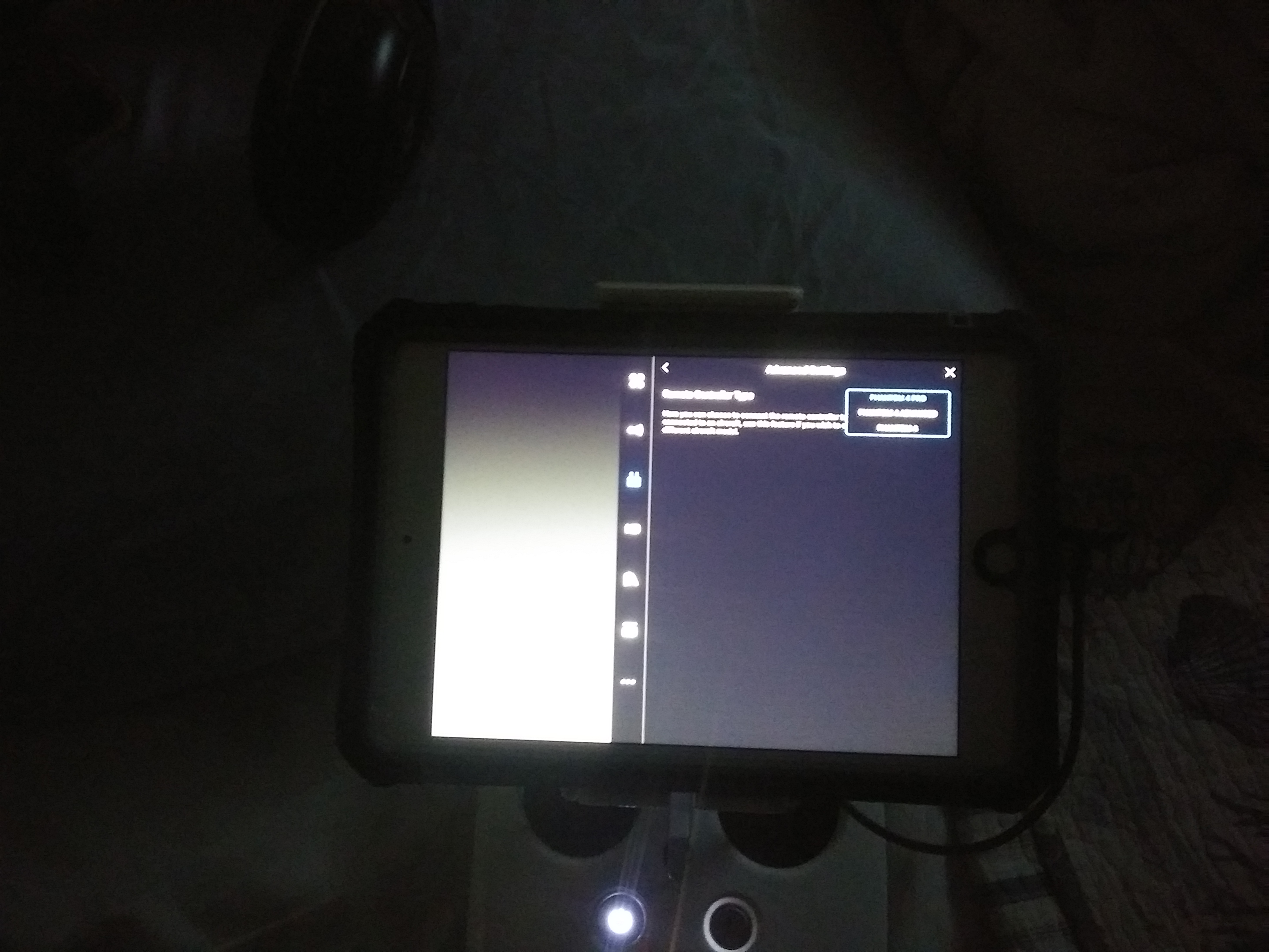

Also be sure your remote is set for P4P as it can be set to P4 and P4A as well. It’s under advanced settings in settings, scroll to bottom of page. Then go to frequency and confirm 5.8. Then link with app.
Not sure how to set remote to P4P. I selected P4P in the Go4 app. "Under advanced settings"...I looked under 'Remote Controller Settings' and there is no Advanced settings there. Maybe due to not connected to the aircraft. When I click on 'Remote Controller Linking' and it says "confirm frequency settings" with either 'Cancel' or 'Ok'. I do know it's 5.8 from some time ago when it connected. Since I am not connected, under 'Image Transmission Settings', "Work Frequency", it says, "N/A"

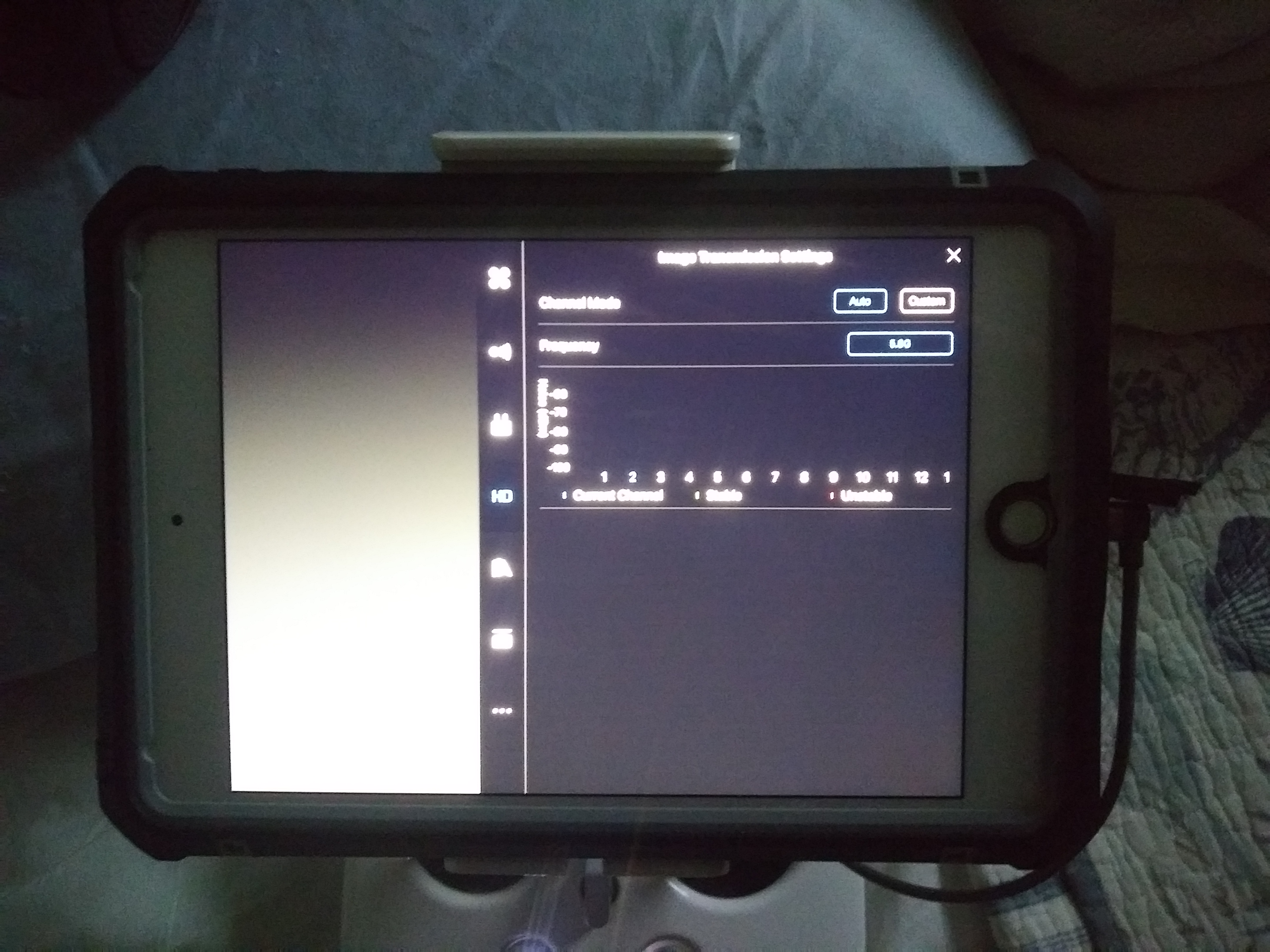

Sorry for bad pics but don't need aircraft only remote. You have to touch the one already on screen to see the choices. Only your selection then shows. Hope you find the answer

Under Adv settings touch the Phantom listed and all 3 P4’s show up.
Under image transmission touch 5.8 or 2.4 to show both.
P4P needs 5.8 to link. P4 needs 2.4 to link. When showing P4P in Advanced settings and 5.8 in Image Trans, it should connect following link steps shown in Go4.
Only Device and remote need to be on for settings, then link to P4P.
