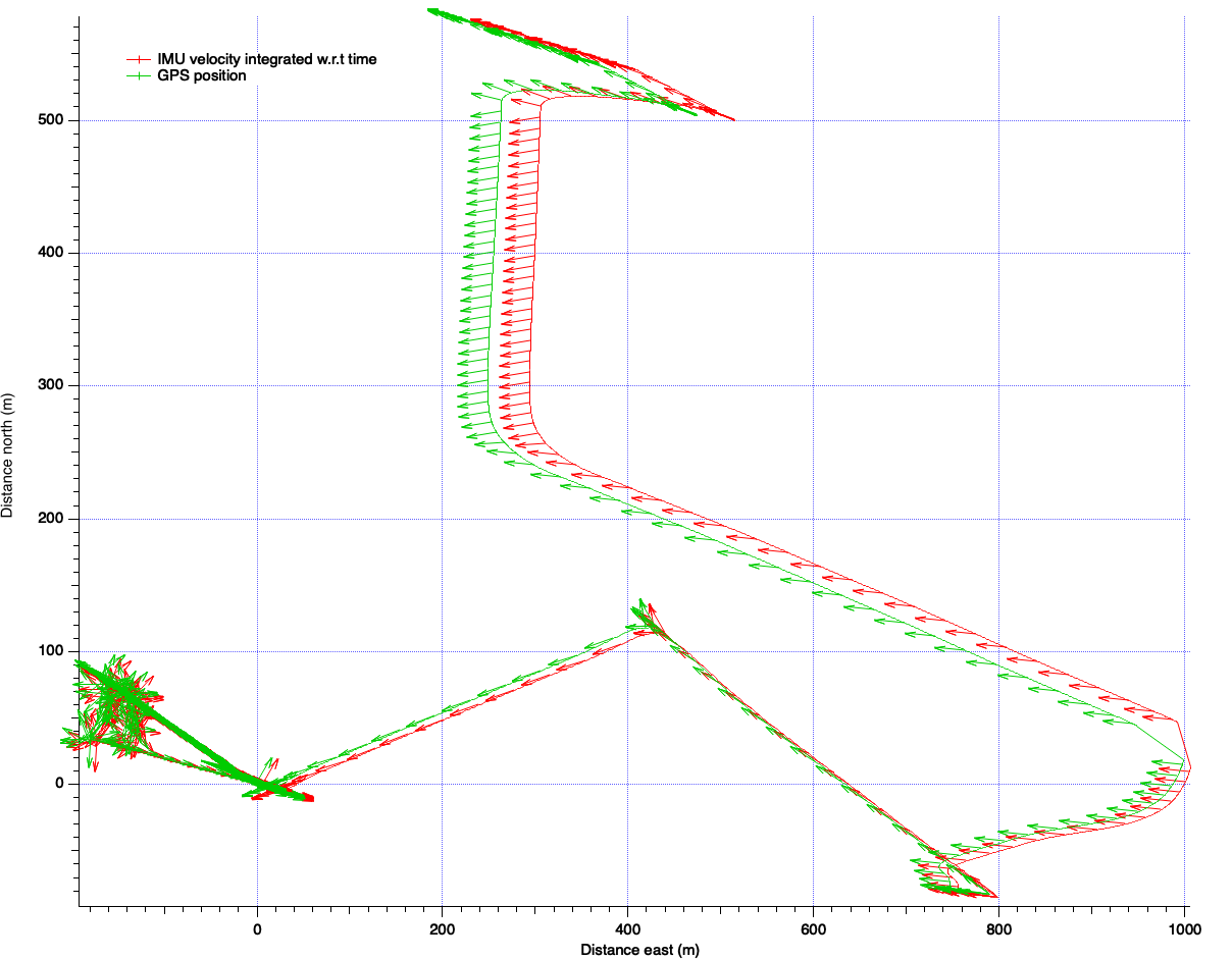

Thanks for the help. I have downloaded the flight records, into excel. Wow, a lot of data.
I departed from a wide open beach with good visibility, directly out to the ocean. Sand hills behind me. I can see where it went from a nice consistent 30.2m on the way back to me, and began climbing. No error messages. . On the way up, it was reading P-GPS until at 178m it changed to Go Home, although I hit Return to Home from the outset. At 215feet the message RTH Preascending, was recorded. At 186feet I went to ATTI mode. I briefly accidentally had it on sport mode, used to the P3 controller I suppose. That was for nearly a minute. No response. At 253 feet I see an entry: warnings:Mobile device CPU fully loaded. Related performance will be affected.
Then at 518feet the message changes to Go Home. Then "GPS position no match". At 560 feet the log says "RTH Cruise, followed by lots of "Cruise" messages, and "Braking to avoid obstacle". It didn't but climbed to 675feet. It is 948m away and not coming closer. There is an error in the log, "Cache Full".
In ATTI mode it starts to inch toward me and descend. Message days "In ATTI mode, change to GPS for safety". 495 feet and 650m away message changed to auto land. Then 1 message that says "Command Error". None of this is over the water, it had flown over my head and into the housing area behind me. 387 feet and 655 metres message changes to Forced Land. Critically low battery warning. It landed 616 metres away, but somehow had managed to find it's way back to the beach, skimmed the Sandhills and the battery died about 2 metres short of the water. A miracle.
So I can see that my iPad is a little too old, small, short on memory perhaps. At it's furthermost point there were a couple of messages telling me to adjust the antenna for better reception. I don't know what obstacle it thought it was avoiding up there. Maybe the bait dropper. Seems unlikely as it hadn't tried to avoid the bait dropper at any other time. The sun was up when this flight started. By the time it got back, the sun had set. I have read that sunset can confuse the sensors.

Your flight data looks like this: DJI Flight Log Viewer - PhantomHelp.com
the drone suddenly ignoring the remote, gaining altitude and flying off to wherever the mood took it. I am trying very hard to find out why.

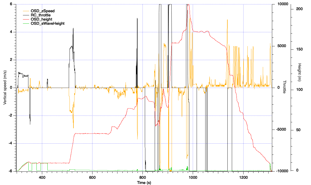

It looks like you had no problem with left/right control and the drone responded normally to left/right joystick inputs.
It also went up when you pushed the left stick forwards.
Your description is a bit vague but I'm guessing you were talking about the drone:
  • getting to the home point at 11:59 but not descending
  • not descending when you pulled the left stick down as happened at 13:33 and other times after that.
The reason for that shows quite clearly in the recorded data.
You had a problem with the downward facing sensors that indicated to the drone that it was almost on the ground.
The VPS has a range of up to 10 metres but even though the drone was much higher, VPS is showing very small numbers when it should have shown nothing.
This would have been visible on your flying screen the whole time.
This might have been due to a gimbal guard or something else blocking the view of the downward facing sensors.
You could have solved the issue in flight by disabling the VPS sensors.
Agreed - there was a major problem with the VPS height reading and it appears that the sensor was obstructed.
There is no point in trying to troubleshoot any further until that is fixed. IMU looks mostly consistent:

OK Thank you folks. You do have experience at reading these logs!
So, this takes me back to why the downward looking sensors thought it was almost on the ground? Why did it start climbing when, while it was out to sea, all I did, as usual, is hit RTH?
Your saying there was an obstruction to the downward looking sensors. This makes sense to me. Lets say they "saw" the bait dropper. In flight I guess it would think it was too close to the ground and so in P-GPS mode starts climbing? Trying to RTH would have the same problem then?
When it was flying out of VLOS into places I am not allowed to go, and the battery was dying, I was quite anxious. I could well imagine I could have made some joystick errors, as I did when putting it into Sports mode briefly. But still should have been able to bring it home in ATTI mode.
What did in the end enable it to get back to the beach, even if nowhere near the home point? I do recall being relieved at one point that I could see it was pointing towards to ocean, although I wasn't able to then just fly it back normally. At least if I could get it moving, then it crashed, or I crashed it, it wouldn't be on a populated area.
I saw a few messages about obstacle avoidance. But not many. Do the downward looking sensors create those messages, or did a bird fly by?
I am now growing more suspicious that the bait dropper was what the downward sensors picked up on. It was mounted under the camera, where I thought the angle of view of the sensors wouldn't see it (else they'd see the camera first), and after perhaps 20 flights configured like this, the drone behaved perfectly.
Thank you for your fast analysis. I appreciate that you have explained what went wrong.
