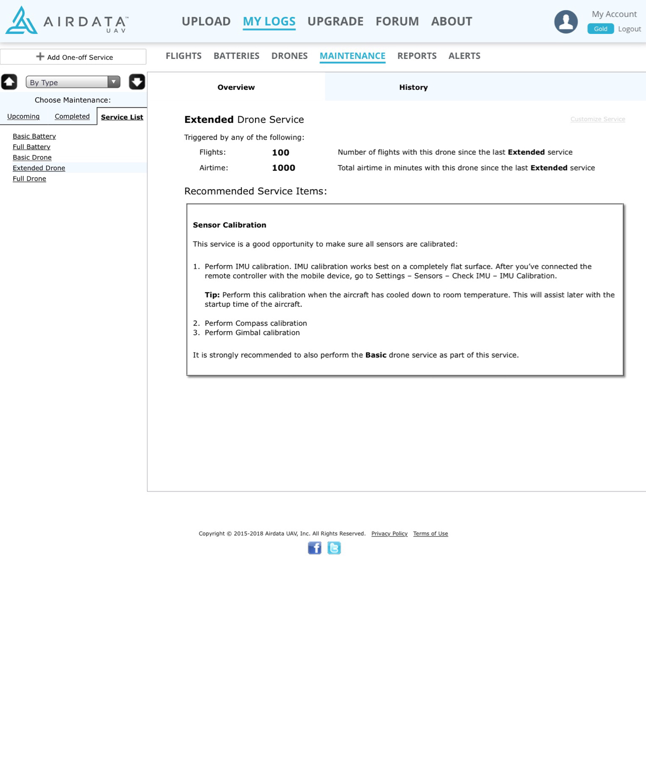

I recently subscribed to Airdata UAV gold plan. They have a drone and battery maintenance schedule. The drone has three levels of maintenance, Basic, Extended, and Full. On the Extended they have you performing a IMU, Compass, and Gimbal calibration after a certain number of flights or Airtime.
After you upload your all your flight logs you’ll see total log time as well as your total airtime.
