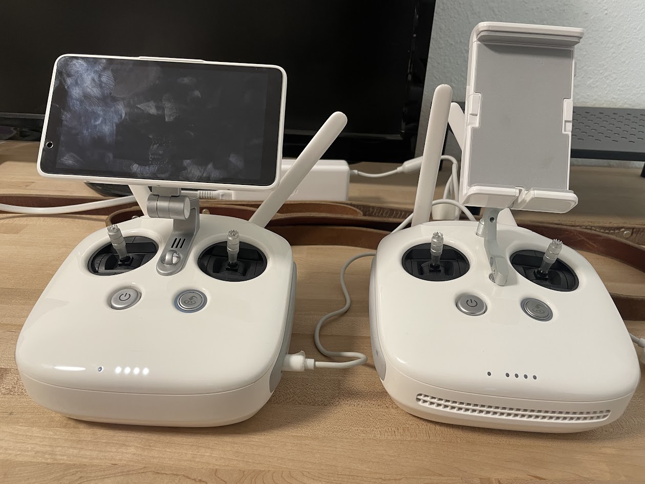

I purchased a used P4P+v2 and the controller has a built in screen. I'm not happy with the built in screen and want a more accessible interface so I purchased a controller that does not have a screen that I thought would be compatible and I could use a tablet.
BUT. I was WRONG. I actually have a P4P+, not the version 2. So... my newly acquired ebay GL300L will not sync with my drone. I feel deflated.
Can someone confirm some stuff?
WM331A is P4P+ (NOT v2.0)
If I buy a GL300F, will it sync with my WM331A?
I'm quite certain this is right. But the Phantom 4 world seems like a maze. The logo on my P4P+ is silver color.
Next... does anyone have any suggestions about what I can/should do. Or does anyone want to co-miserate in purchasing equipment that they didnt end up needing? I hoped to keep costs low.....but..... I'm finding that is easier said than done.

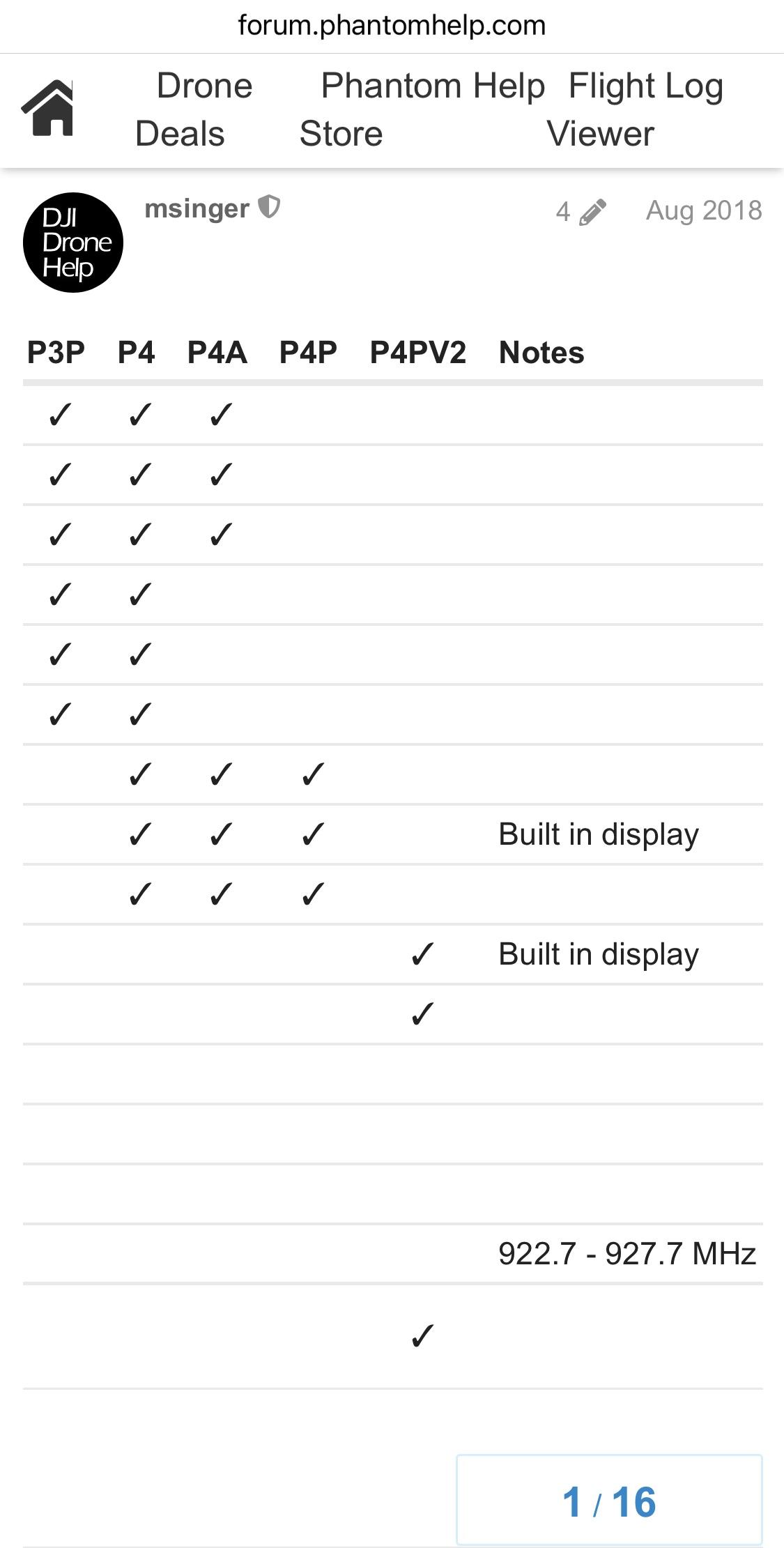

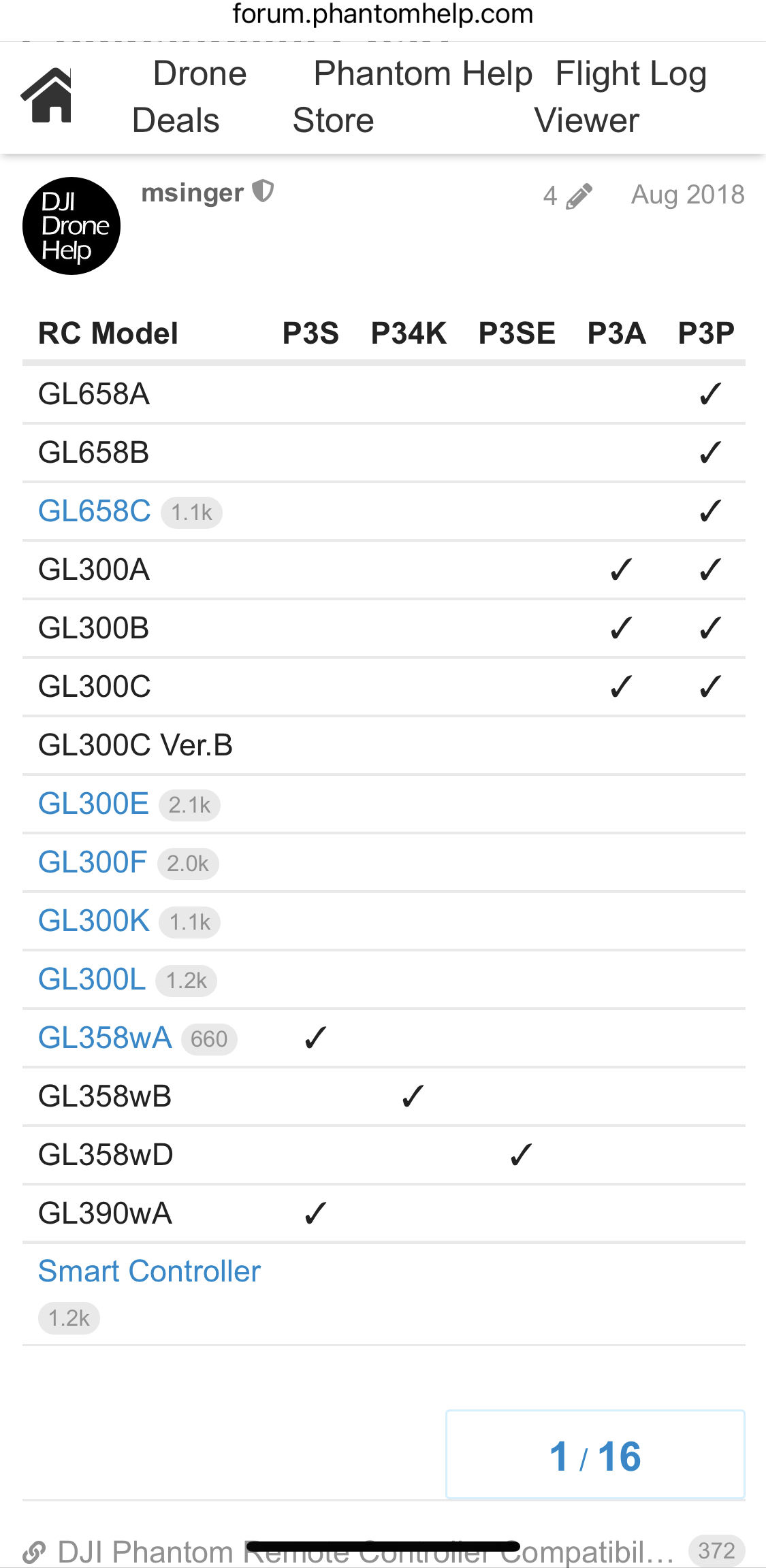

It is quite a maze of compatibility.
I came across this table a while back and I have referred back to it many times. I have it bookmarked.
If you search for dji-phantom-remote-controller-compatibility-chart “phantomhelp” 1058 you should be able tI find the link.
I’d post the link here except I believe posting links to external sites not permitted. I’ve attached screengrabs. (Admins don’t beat me.)
