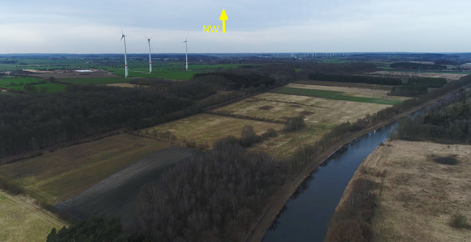

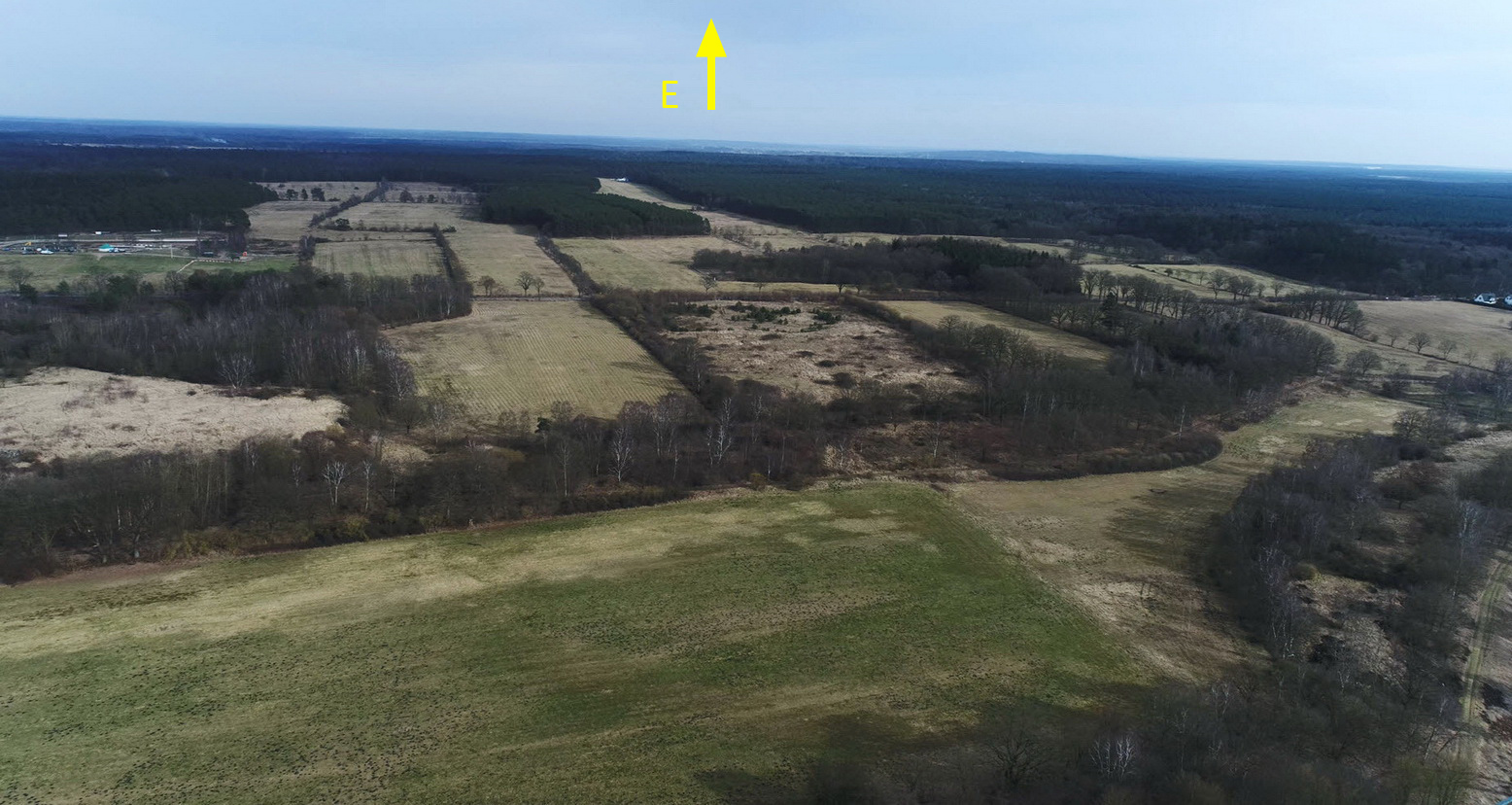

I have the problem with tilting on the P4P since I bought it a few weeks ago. If it would only be constant I could live with doing manual gimbal adjustment once per flight. But my tilt depends on the compass direction.
See pictures. First screenshot looking NorthWest, second = looking East. The second shot is the same flight, same position, just higher up.
But it's not that it's always tilting while facing east. Sometimes it's vice versa :-(
