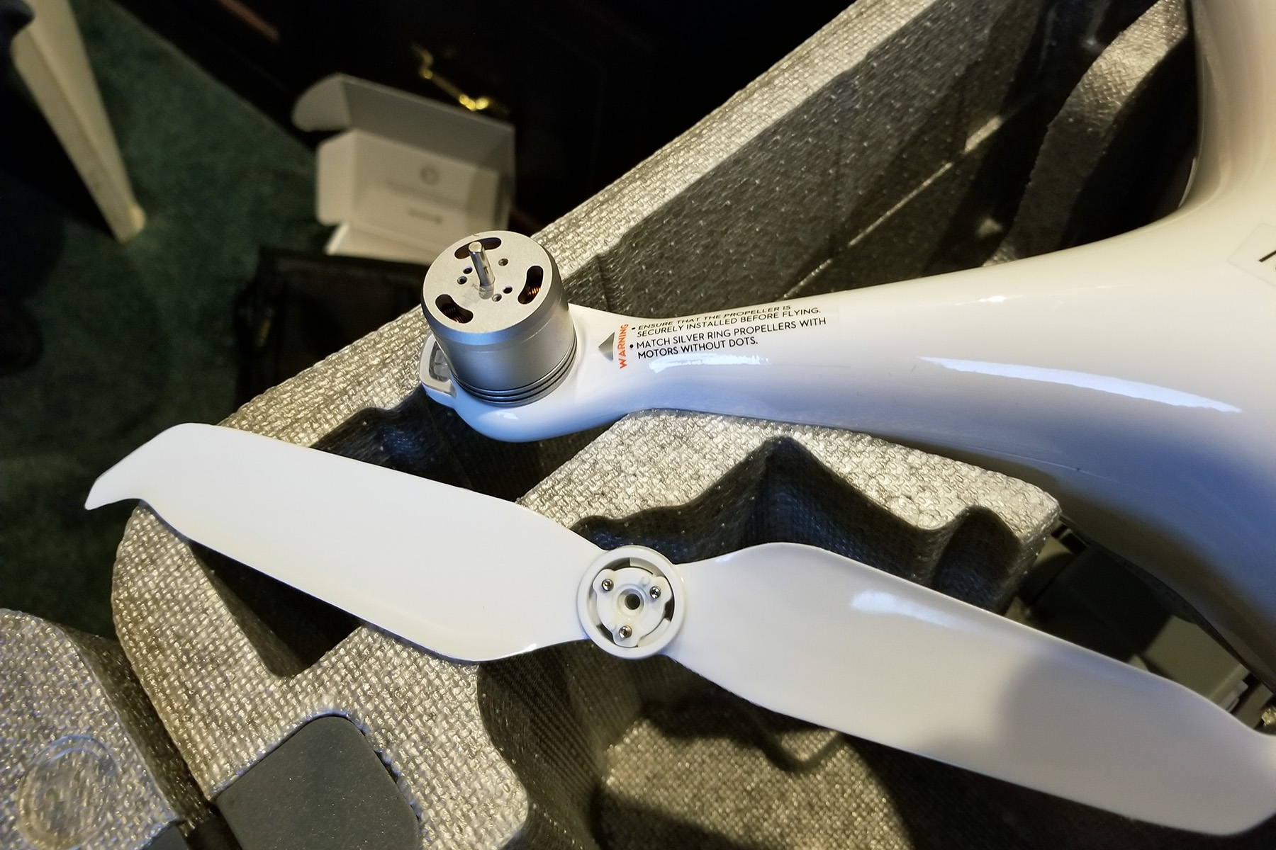

Was running some Litchi missions and while landing on the second mission the P4P began spinning/undulating and crashed into grass about 25' (7.5 meters) from the launch site. Physical damage seemed to be limited to landing gear/antennas. Would have probably been much worse if crash was at landing site (which was concrete). Sent to DJI for repairs. Prop came off in flight and was able to recover the prop with the mounting plate still inside. Appears the three screws either stripped or backed out due to vibration. It was my second flight of the day (about 6 minutes) and part of my preflight routine is to "jiggle" the props to insure they are tight; they were. Wondering if anyone else has had this problem.

Sorry to hear about your trouble. I imagine DJI had a good reason to stop using the tried and true P2/P3 screw on props, maybe they couldn't handle the P4 braking but that system is scary.
Will check mine and might add a small drop of Locktite to those screws while I'm at it. Thanks for the heads up, REStewart.
Reactions: chiuki
It's a very rare incident.
That's definitely not normal and looks like those screws can't have been tightened properly to start with.
The drone looks like new, how much flight time is on it?
The "system" is fine, but it has to be tightened properly in the factory to work.

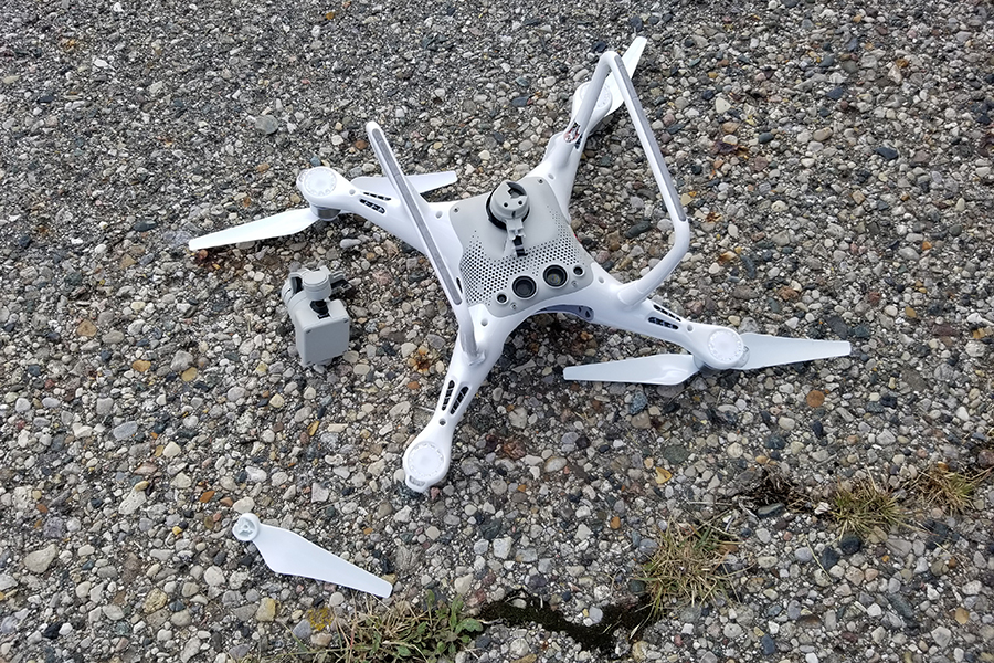

You ain't gonna believe this!! Got my refurbished P4P late last week. Went out and took it up for a test drive; probably 20 minutes or so. Ran it through a test sequence I've developed to be sure all the critical functions are working. All seemed fine. Was careful to check the props and how they mounted. Again, all seemed fine.

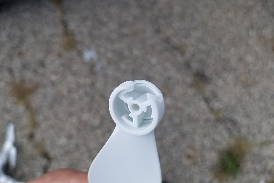

Following day went back to the location to continue my Litchi missions. Set up the drone loaded Litchi and hit go. Drone began ascending normally and at an elevation of about 30 feet went into a spin and came down on the roof of the car and bounded to the pavement. I used the props that DJI sends with the repair and it looks like one of them simply failed. The drone is on its way back to DJI; can't wait to see what they say. I did claim a manufacturing defect in my crash report. Important note... did not hit anything.
I GUESS I HAVE TO AGREE WITH MR. ROOTMAN NOW!!!
Pics below. Note the failed propeller was found about 25 feet away and moved to be included in the photo.
