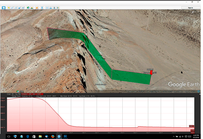

KML planning always scares me. Sometimes Google has an odd offset that doesn't work out so well. This animated GIF shows where the bird flies inside a mountain even though the KML wall shows it going over it. Needs a lot more buffer clearance.

Yes, once exported you can use Google Earth to analyze an elevation profile of your flight path. It will clearly show you potential issues with waypoint positioning and altitude settings.
