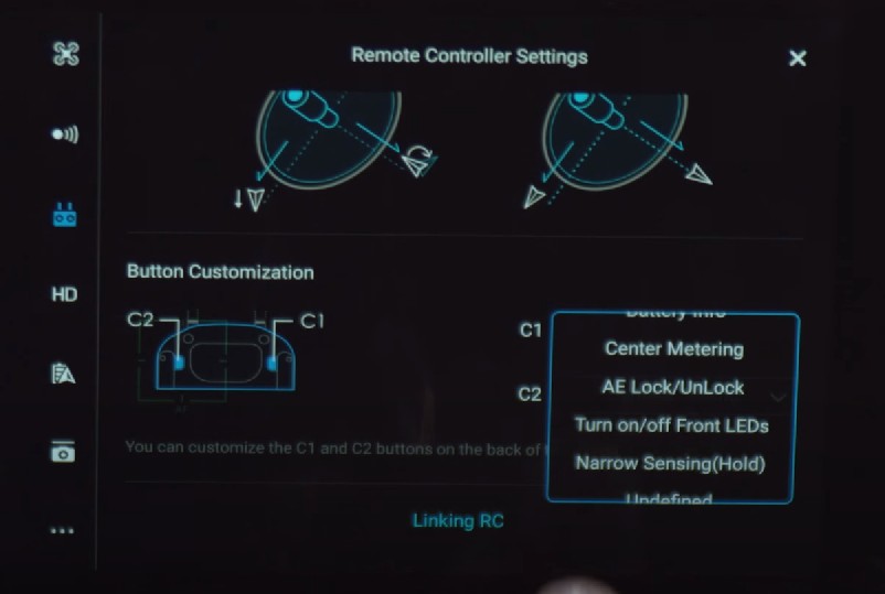

when flying a P4P into close proximity to objects, isn’t there a sequence on the controller buttons that you can tap or hold down that will allow you to fly into tighter areas?
thanks. In advance for help here.
Thanks for that tidbit!
for some reason I thought that I read a long time ago that if you pressed c1 and c2 simultaneously it toned down the collision sensors.
It's an intelligent flight mode called "Narrow Sensing"

That is it! Thank you for sharing!
This has been around for while, We used it quite a few times , Its not made for going thru tunnels or hallways or anything that has great depth to it as it just froze.
It is good for making it more stable and flying thru 3 to 4 ft areas such as the Y or any Narrow gap that is not deep.
I dont think they ever fixed the Freeze as far as I know so you need to watch for that.
