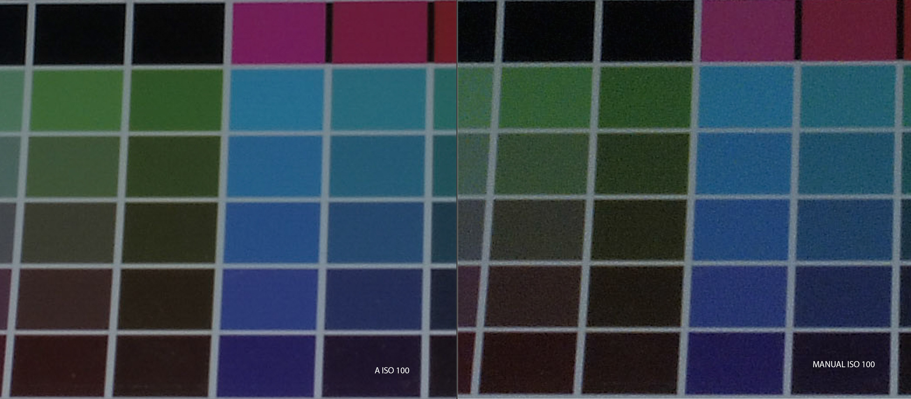

Well, I actually went through and did a complete, controlled test, and boy was I surprised..
I have latest firmware, apps etc. All shots baselined at f5.6 with ev0 iso 100 and iso 400 (to leave wiggleroom for all thinkable aeb adjustments and get comparable noise.). Controlled lighting.
My findings are (and I have repeated these, but please someone else do this as well).
Exposure metadata are recorded the same during aeb both for raw and jpeg. Same exposure-settings (aperture/shutter/iso) but with a added Exposure Bias for each shot. These are consistent and correct.
A-mode ISO 100: aeb almost works, that is 4 out of the 5 shots have the correct exposure with consistent noise. The exception is + 2/3 and + 1 1/3 which are the same. We end up with four out of 5 different exposures. (this is not a problem for aeb with 3 shots)
A-mode ISO 400: aeb works, that is 5 out of the 5 shots have the correct exposure with consistent noise.
M-mode ISO 100: exposure values are different on all shots, but the noise varies horribly. Not sure what is going on here. Further, both +2/3 and +1 1/3 exposure are darker than reference?
M-mode ISO 400: exposure values are different on all shots, but again the noise varies horribly. The same exposure for ISO 100 might actually be worse than 400 (??)
I have added a comparison for same exposure values (subjectively) for manual and aperture at iso 100
For shutter priority, all shots come out the same (so not working at all).
Conclusion: AE 3 shots seems to work for A mode. 5 shots works in some cases. M mode wildly inconsistent and unusable. S mode unusable

Ok - so this is interesting, Your findings are what I've been basing my commentary on. I shot my test shots in M mode but using AEB and got horrible noise as you found. I stupidly assumed that shooting in Manual would be the best option. I think (still) in manual it's using electronic gain to change the EV.
As for your finding with the shots in ISO 100 with the +2/3 and + 1 1/3 being the same - it's possible thats because at the settings the camera was on there was no more headroom for exposure, so it just took 2 the same after trying to get the +1 1/3

That hasn't been my experience, depending on the definition of "working properly". Shot yesterday in AE mode and, while LR did not have the RAW meta data for the different exposure settings, the light curves were definitely different. So I did get three different exposures in AEB. Just saying....

I just did some 5 bracket tests in both dng and jpg (not dng +jpg) and things looked pretty normal to me. It appears the bracketing shot order is different between jpg and dng for some reason, but the shutter speed is changing and the resulting exposure looks as I would expect based on the respective shutter speed.
I tried in all modes (auto, a, s, m) at iso 100.
Shutter priority does not seem to be respected in that it always brackets based on shutter speed. I've had other cameras that would use aperture or maybe iso to bracket when in S mode, but that should not be a problem. In most cases I'm not too concerned with my shutter speed as long as it's fast enough.
