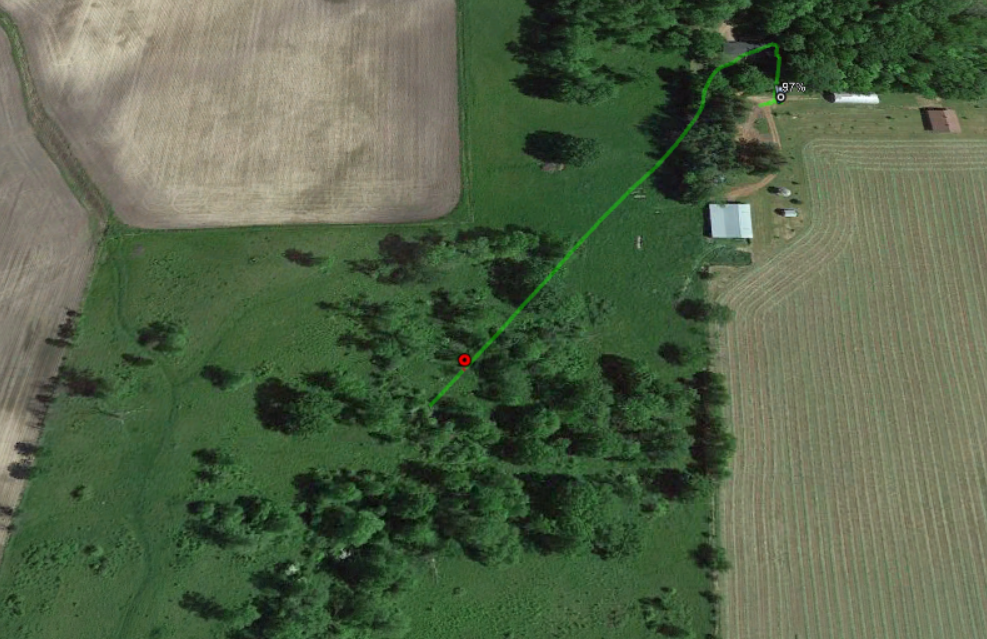

Taking a quick look at this data, I see no warnings ( Other than the High Wind ) the log abruptly ends at 1:19....in a tree clustered area according to the GE data. Right now I would suggest a sudden power loss. Have you looked in that area? Give me few minites and will post a GE profile.
In the area below with the red indicator ( That was the high wind warning )..................As unfortunate as it is there have been numerous power loss's recently on the P4's. Primarily due to the battery loosening in flight. I can't be certain from this particular data set but that is what it appears to be.
In the area below with the red indicator ( That was the high wind warning )..................As unfortunate as it is there have been numerous power loss's recently on the P4's. Primarily due to the battery loosening in flight. I can't be certain from this particular data set but that is what it appears to be.View attachment 99389

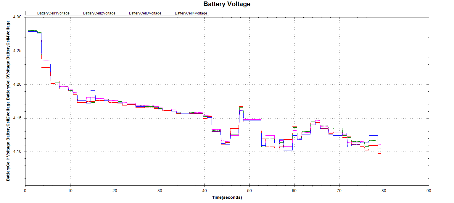

Here is a plot of your battery. Notice the data just simply ends.
Reactions: TopView Imaging
That does look like sudden power failure - possibly the dreaded battery disconnect. The aircraft DAT file would be the only way to confirm power failure since the telemetry has neither fast enough sample rate nor low enough latency for the voltage drop to show up in the txt files.

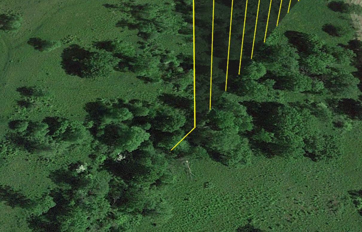

It shouldn't be that hard to find - it will have fallen pretty much straight down at the last recorded location, and I'd expect it to be within 10 m or so of there:
45.814526, -92.919875
Agreed with @sar104, In this image the extended bottom path line is approximately 50ft from the last reported position. Taking in to account that your forward travel at that point was 25.3mph, the AC would have fallen at an angular path, so is should be just a bit forward of the actual last location, but not much. This is assuming very light to no wind.
Good point - I had overlooked how fast it was going when it shut off.
