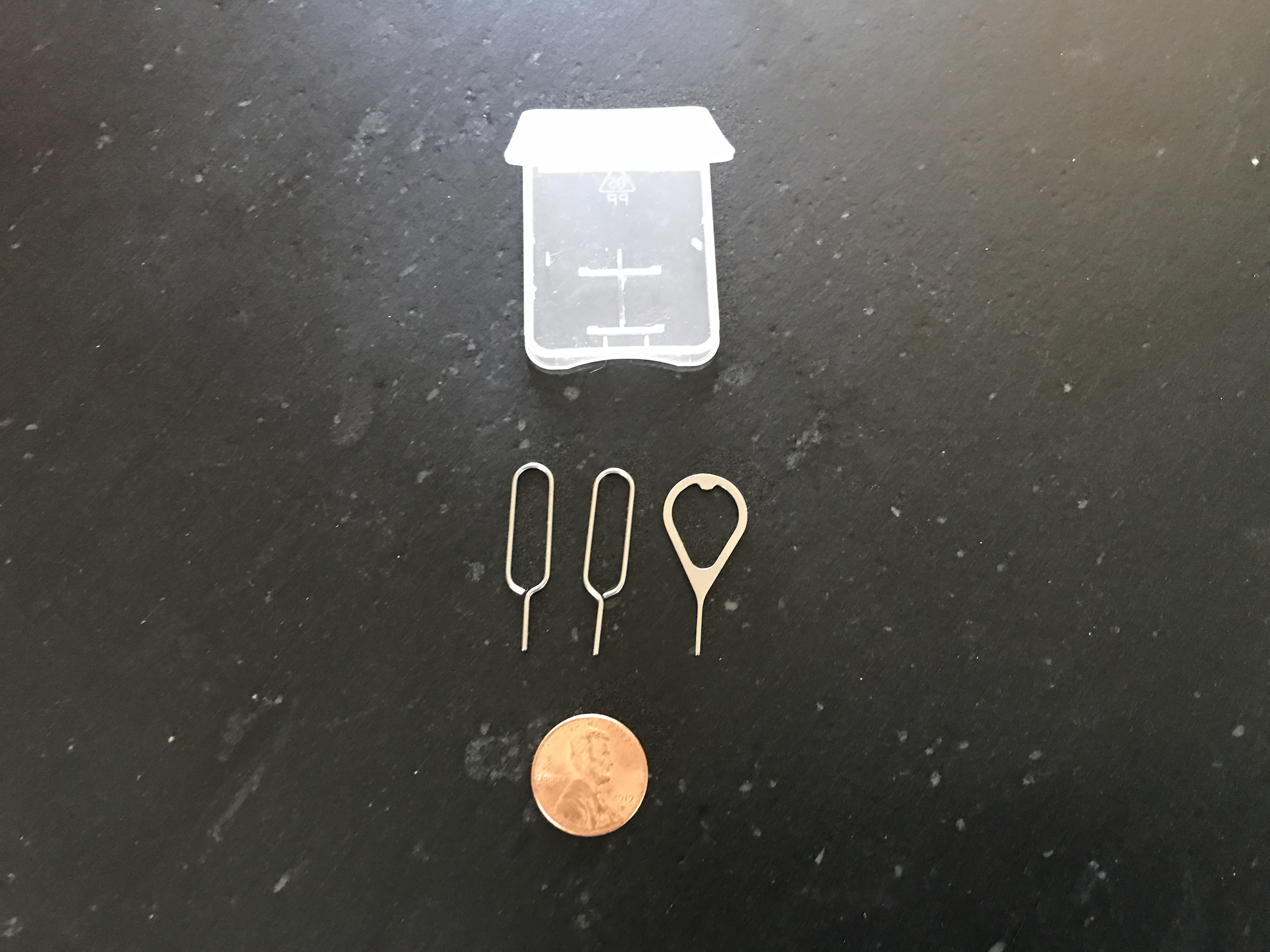

Glad you got it working. These little gems go where I go.
Maybe an Apple product? They work for removing the SIM card from an iPad and they work well on link buttons!
