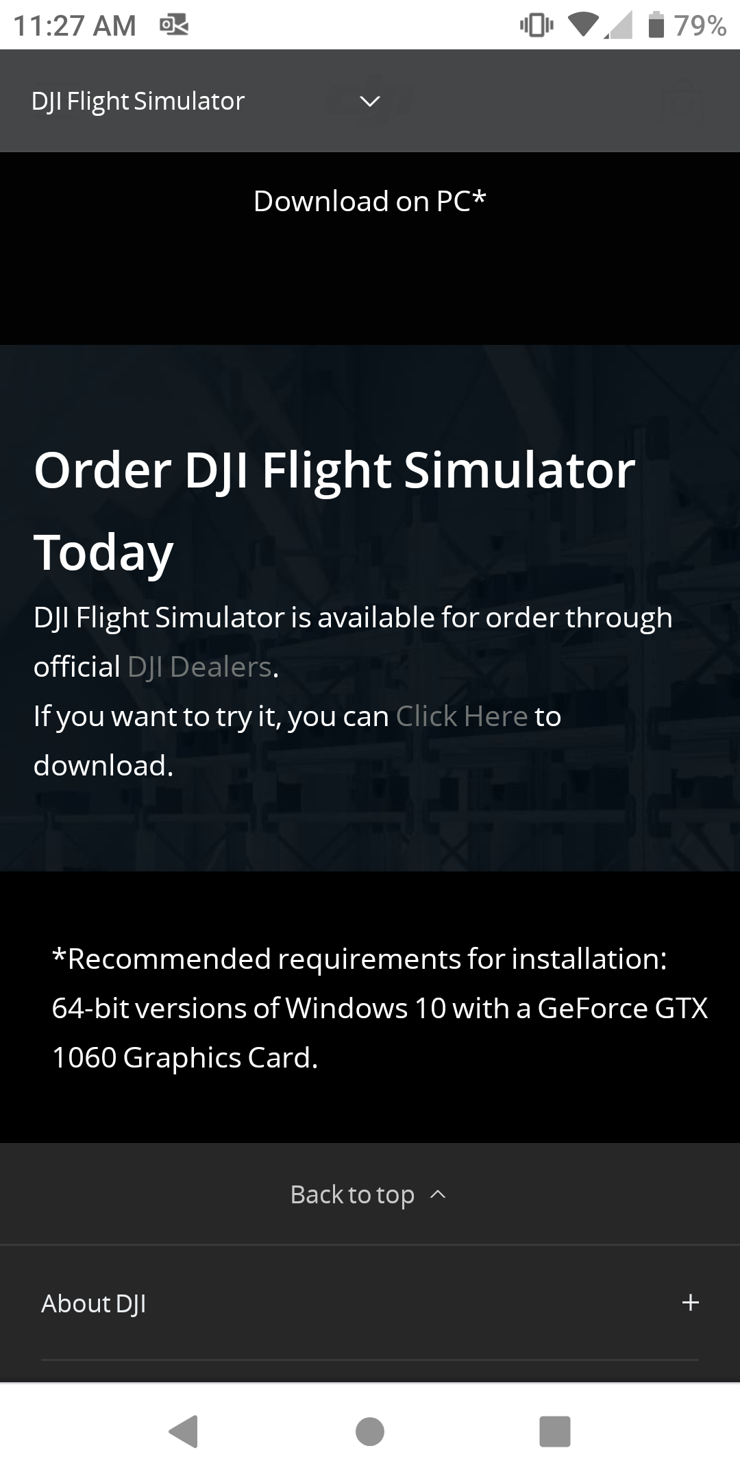

4)When I purchased P4P I planned to wait a week and learn app and as much as possible before first flight. I was glad to hear dji had a simulator. I looked yesterday and no simulator...really?
Has dji removed free flight simulator just to offer it for sale? See link (if link is even working or available)

The A2 version linked to in post #4 should work on Win10 computers. It also includes the simulator.
Works on my tablet with Windows 10 installed:
