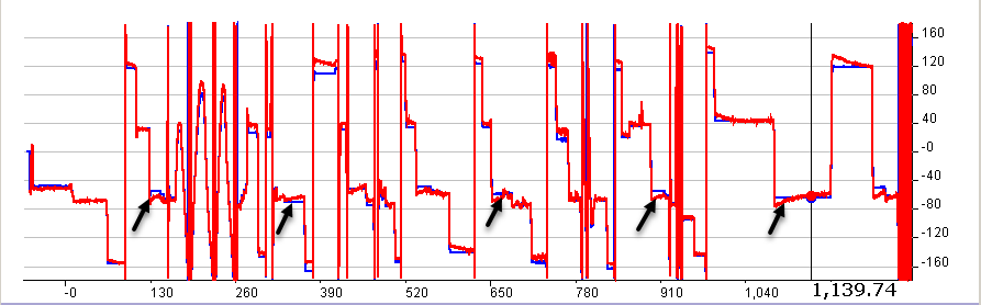

Looks to me like the compass may not be calibrated properly. Have you recently added some external device like a tracker? Before you calibrate can you do a test? Turn the battery on but don't start the motors. Hold the P4P at arms length and then you rotate 3 or 4 turns while standing in place. Try to keep the P4P level. About 10 secs per rotation. Then provide the .DAT for that "flight".
Do the same test after calibrating.

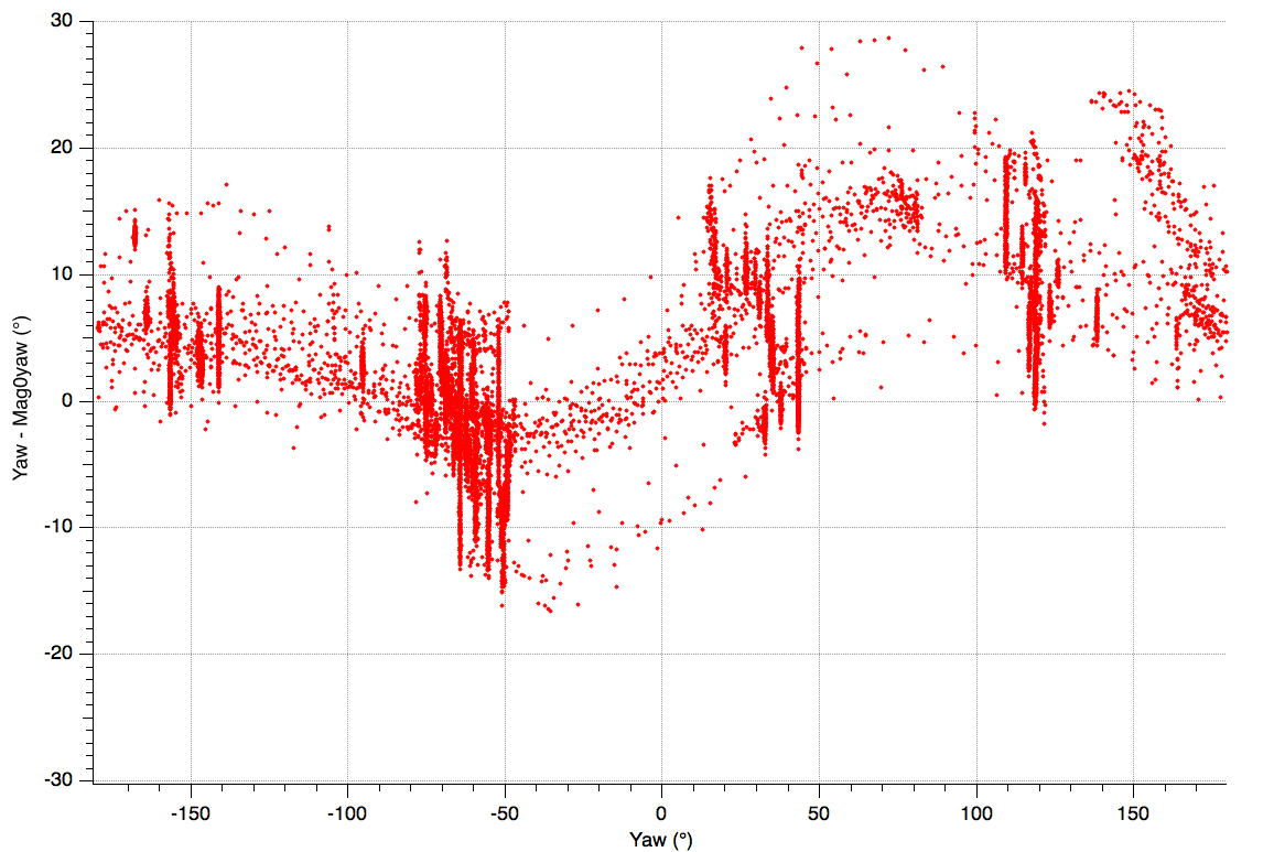

Here's why I suspect a bad calibration. When the P4P comes to rest in the interval [-40°, -80°] the correction required is a CW rotation. Outside this interval a CCW rotation is required.

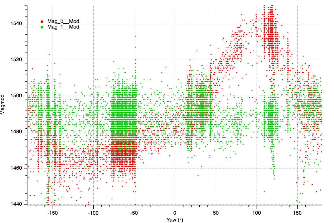

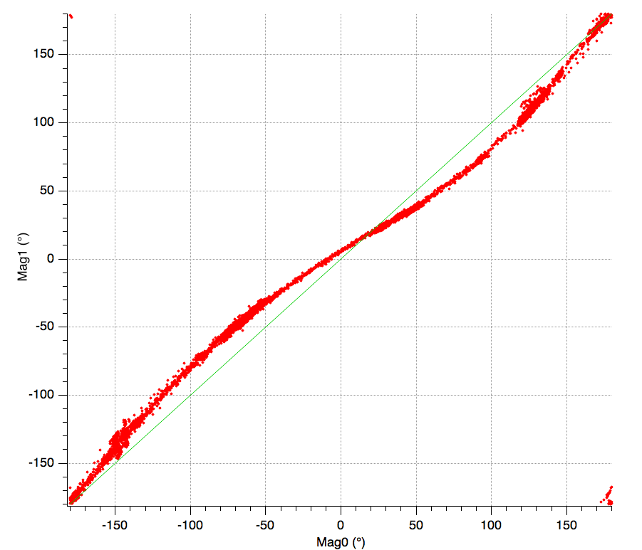

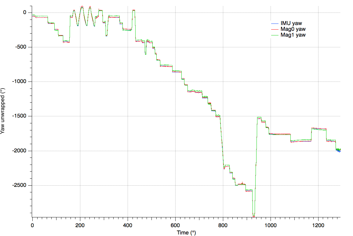

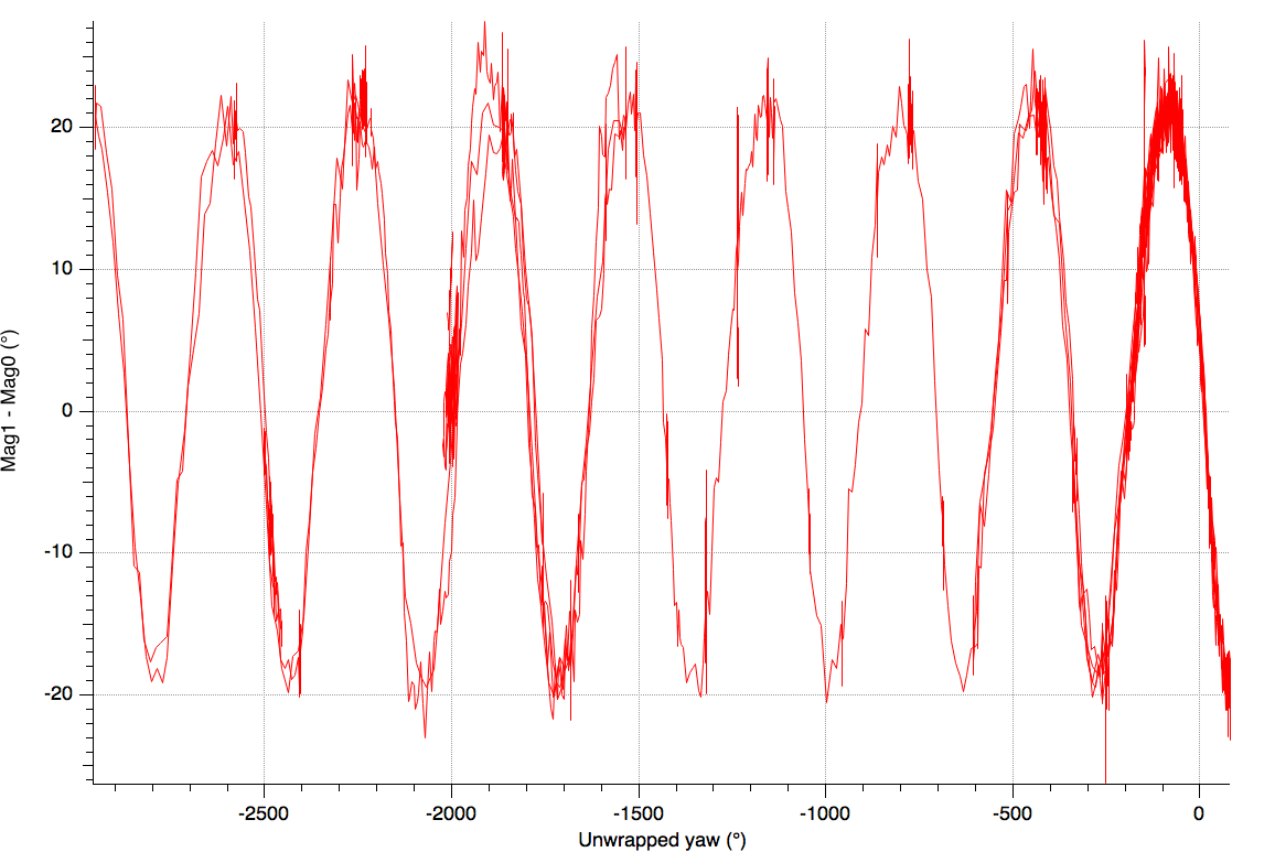

I think there is a compass problem, which may or may not be the root cause of the behavior. The IMU is using compass #1 (Mag0). Looking at the unwrapped values of the IMU yaw, Mag0 and Mag1 shows an obvious periodic discrepancy in the mag values:
Hard to discern the pattern there, but plotting Mag1 - Mag0 against unwrapped yaw reveals the periodicity:

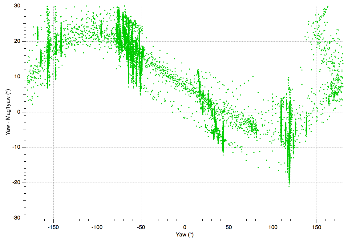

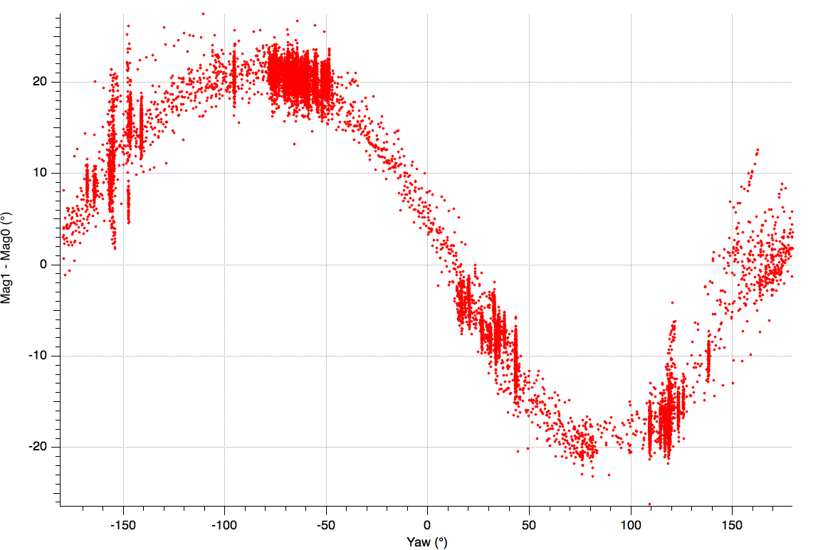

A scatter plot of the same quantity against wrapped yaw shows the likely reason for the different behavior that you noted between - 40° and - 80°, which turns out to be the maximum in Mag1 - Mag0:
Mag1 against Mag0 shows the same deviation in a different way:
Comparing mag mod values for the two compasses:
The obvious periodicity in Mag0 suggests to me that compass 1 (Mag0) has the problem (or more of a problem) than compass 2 (Mag1).

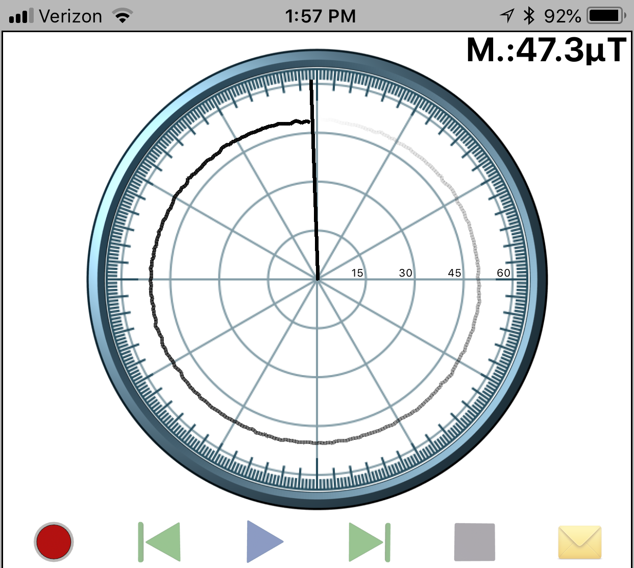

Here is a screen shot of me checking the area for the testing out with a gauss meter. This was a slow 360° turn of the subject area:

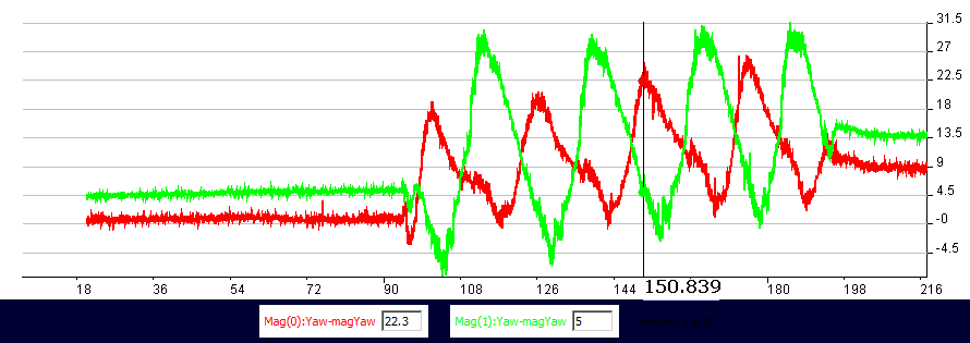

I think I see what you're saying. Except why is it just Mag0 with a problem. It kinda looks to me like Mag1 also has the same problem roughly 180° phase difference with Mag0. This from FLY014 where @brantel rotated the AC about the Z axis 4 times.
Looking at Mag0 - Mag1 hides the fact that Mag1 also shows periodic behavior since the two extrema coincide but they are 180° out of phase.

My suspicion that Mag0 is worse than Mag1 is due to the large variation in Mag0_mod with yaw. If you compare Mag0 and Mag1 individually with yaw then they do both show periodic offsets approximately 180° out of phase:
However, since the IMU is using Mag0, yaw is primarily informed by Mag0 and so is not an absolute baseline. As a result, even if Mag1 were exactly correct it would appear to have a variation with precisely that phase relationship with Mag0. That is certainly not definitive proof that Mag0 is bad and Mag1 is good and they could both be bad, but both cannot be good. It also doesn't rule out other IMU issues on top of the compass issues.

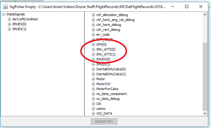

Question for you wizards, why do the DAT files not have 2 IMU data sets since there are 2 of them? The Mavic Air Dat files have 2 of them but as expected only one compass.
Question for you wizards, why does the DAT files not have 2 IMU data sets since there are 2 of them? The Mavic Air Dat files have 2 of them but as expected only one compass.
Sure about that? You're right the .DAT doesn't have the record types associated with the second, or third, IMU.
Per @sar104 's analysis, that Mag0 has a problem, you could try this. Move a screwdriver close to Mag0 and the P4P should switch to Mag1. (You'll be able to see this happen by looking at the Go App). Then try a flight and see if you get the Yaw drift behavior
Here is the Mavic Air Dat file options to pick:
I know the Mavic Air has 2 IMUs. But, your .DATs have records for just 1 IMU.

I get what your saying now, the P4P 2.0 does not have records, the MA does. Got it. Weird DJI does that.
