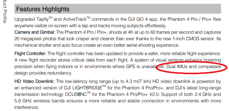

Do we know if the P4P v2 has 2 IMUs? They only put one IMU in the Mavic Pro.
Well I sure hope so because if they did not there will be a bunch of ticked off people. The manual claims it has a dual IMU.
I can't imagine them putting a dual one in the Mavic Air and a single in the P4P 2.0.
I guess anything is possible though. They have changed some significant stuff before and not been up front about it.
There are also two sets of gyros, accelerometers, and compasses that show up on the sensor status page.

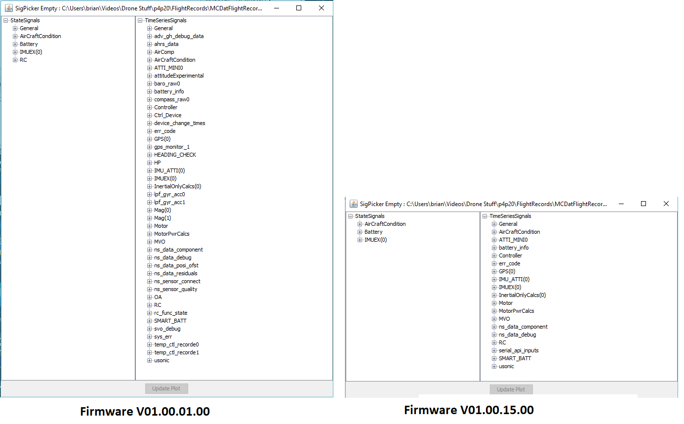

It appears they also changed the DAT file log format that gets recorded on the mobile device. They removed a ton of data fields!
