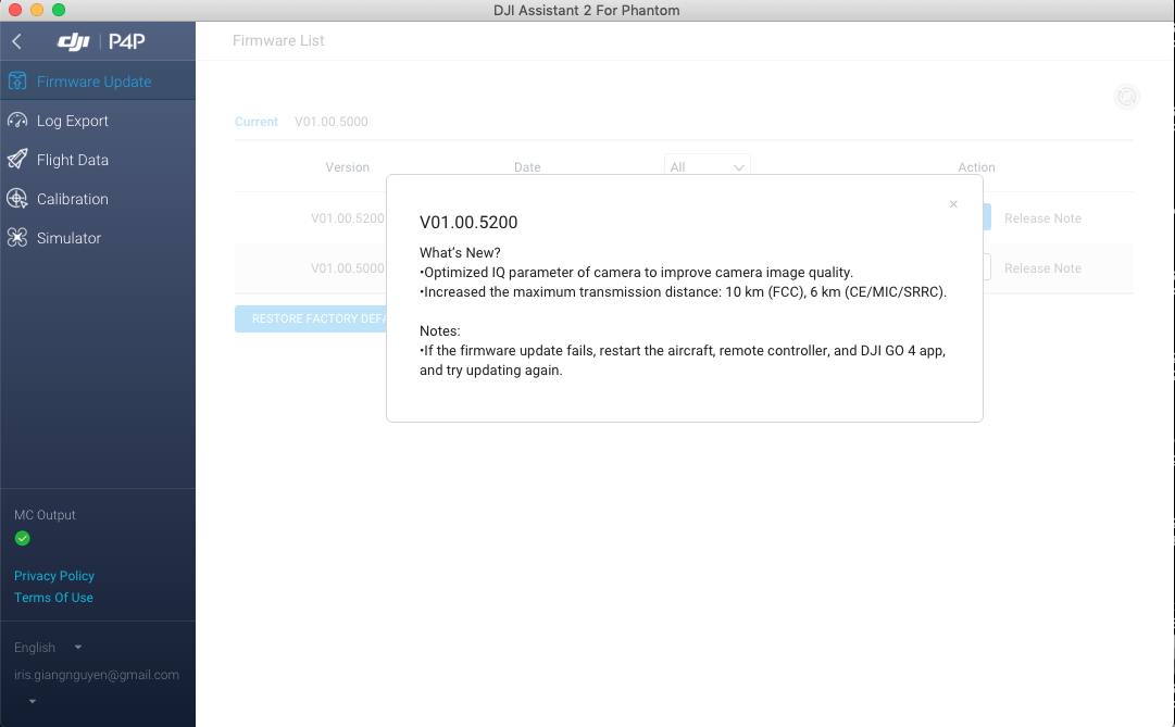

I see the new firmware on dji assistant 2 for P4P v2. Has anyone tried to update this version yet?

Research. I think I saw something that mentioned some camera focus issues. I’ll see if I can find it. Flys fine on the .500

after update mine simply stopped sending video transmissions and i cant rollback firmware either help
