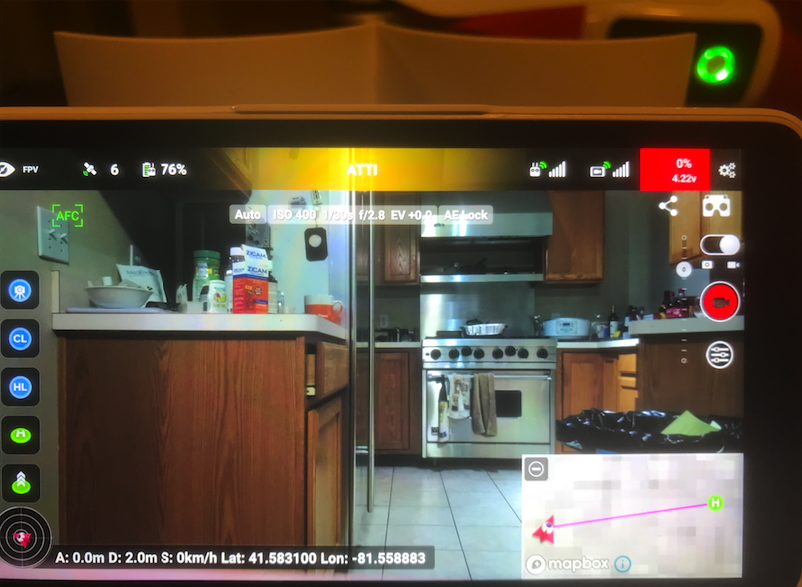

I did not find any great links. But this is what I did:

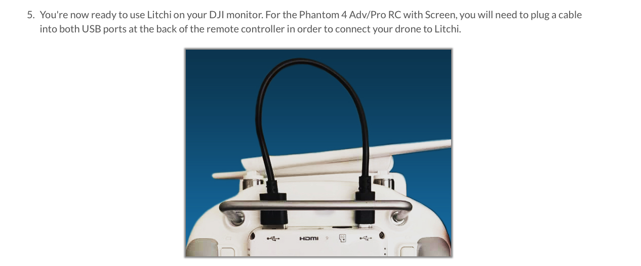

1) Updated the firmware of the P4P+ Remote Controller. I downloaded the latest firmware from DJI's web page DJI Phantom 4 Pro – Specs, Tutorials & Guides – DJI I unzipped the file, put it on a micro sd card, inserted the micro sd card and rebooted the controller. I now have firmware 01.04.01.00 on the controller
2) Went to DJI CrystalSky - Litchi and followed the intructions to install Amazon Appstore and subsequently Litchi from Amazon Appstore. Finally with right controller firmware this went smoothly
I also updated the firmware of the drone and the DJI Go app. I have not tested any of this yet as I just got it installed and the weather is bad here right now. But at least I got Litchi to install...
