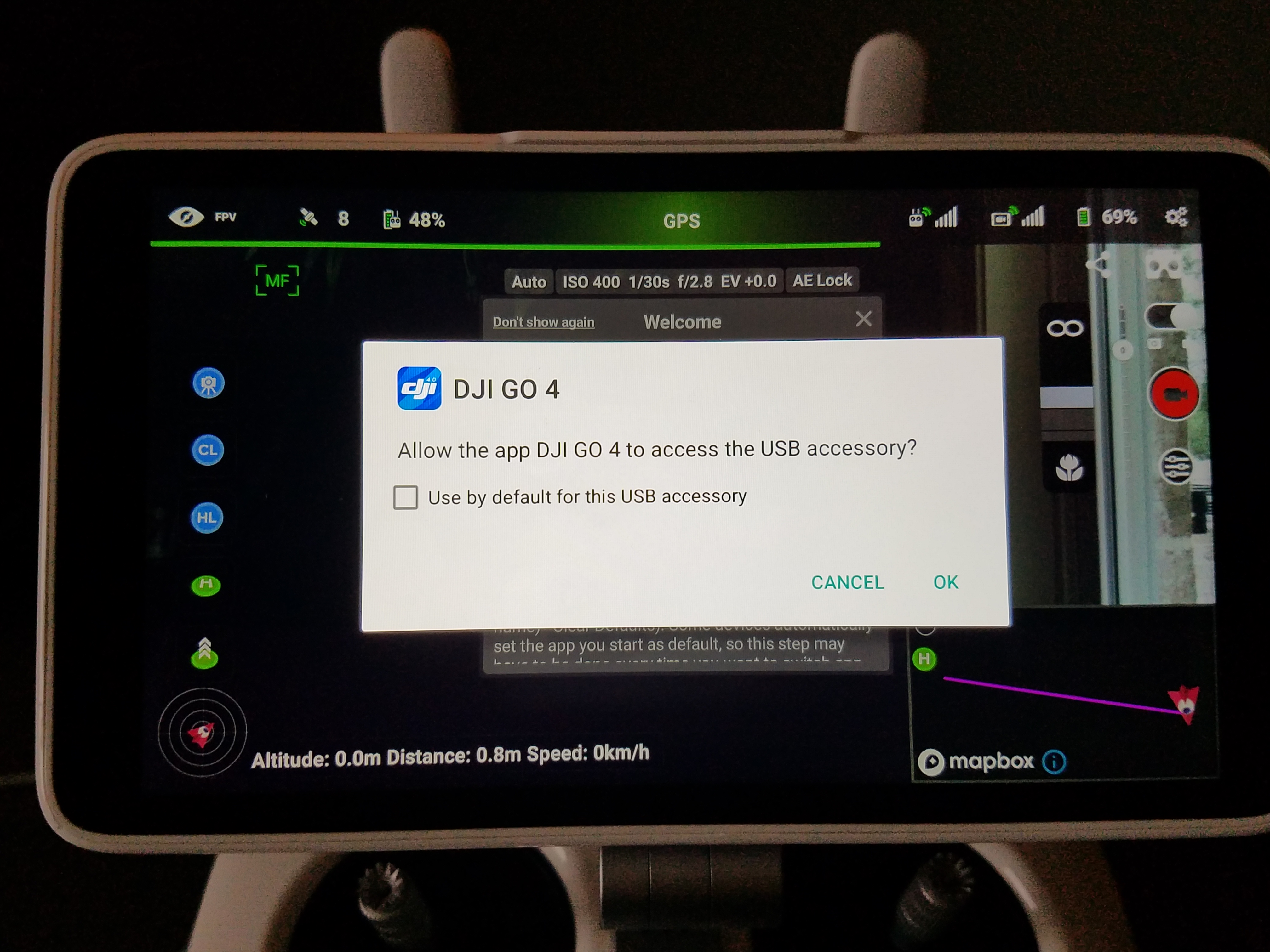

Thanks! It worked! I also get this pop-up below. Show i ignore it?

I too run litchi on p4p pro plus, works great, i did have to try a few cables before finding one that worked. Trouble was in cable not app or controller. Gkad you got it working.
