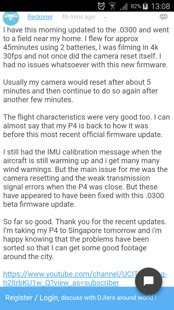

New firmware beta 0300, fixes the errors of recording in 4k.
Seems to fix most other issues too.
