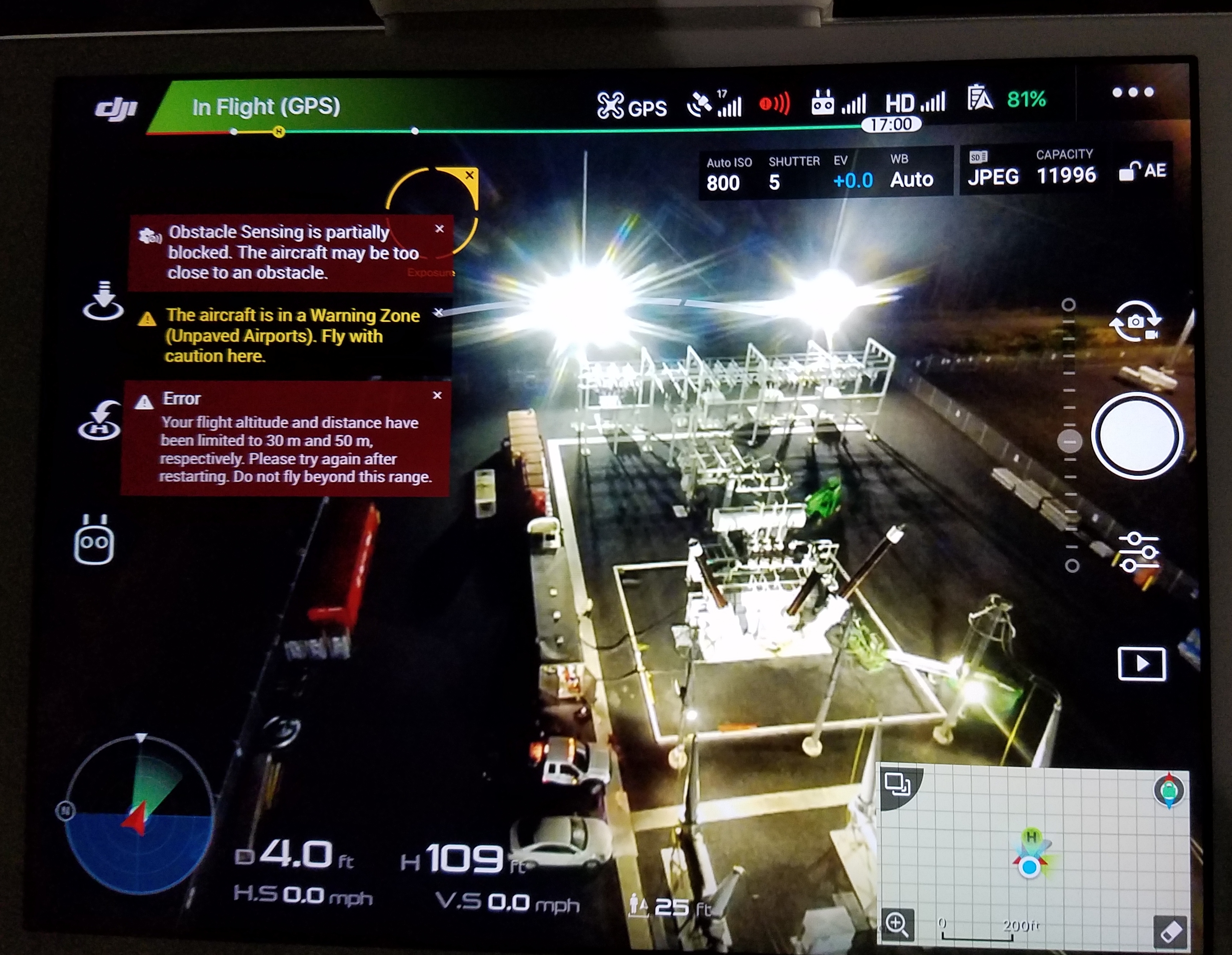

Hello all, after flying my drone at version .0503 it would still fly unstable, yoyoing up and down. i installed version .0602 and the flight is morw stable. now i have new error messages see screen shot
. Anone have a suggestion? is there a factory reset that i can just hit a button and go back to the out of box settings? it flew great then.
Sorry here is a pictute of my errors
