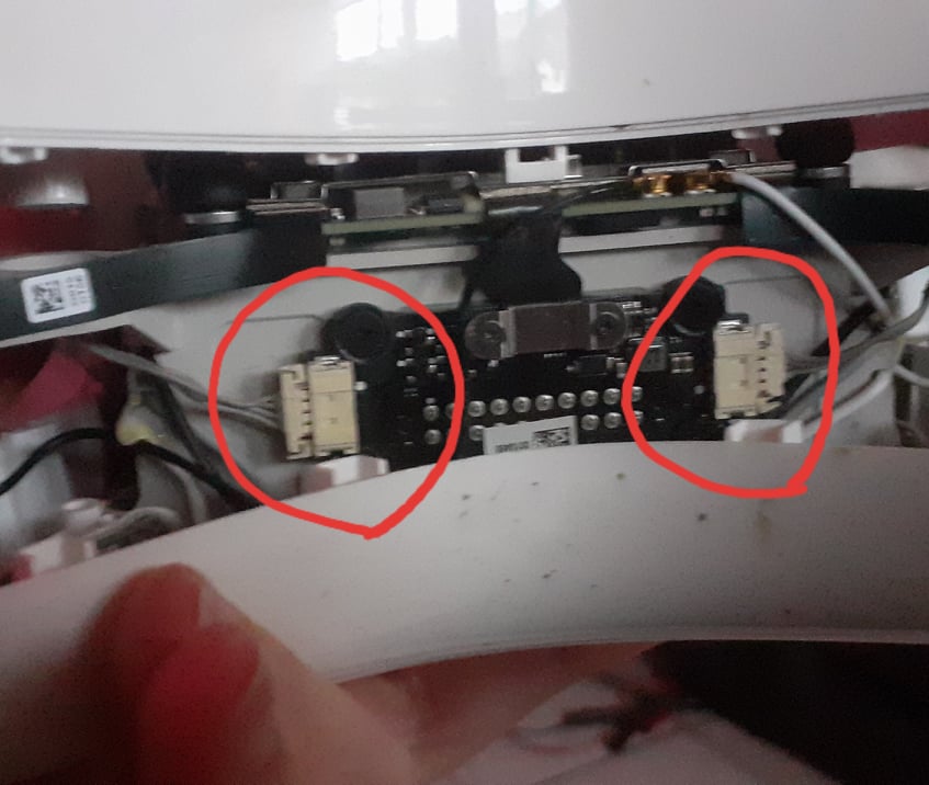

Hi,
I have a client's Phantom 4 Advanced on me that has been crashed, and required a shell replacement. However, after I replaced the shell, I noticed a Compass Disconnected error. I've encountered such problem before, thought replacing the faulty leg would solve this as well. Not in this case. No matter which leg was connected, brand new out of the package or the original one, I got Compass 2 disconnected. According to DJI Go 4, Compass 1 is fine whichever leg is actually connected. To top it off, it even says Compass 1 is operational, when none of the legs are connected.
I guess I'm going to need to replace the frontal board, but it has these weird connectors that break immediately when I touch them. How do I disconnect these? See pic attached.
Any help would be really appreciated.
Thank you
I have disconnected those before but it has been a while. I seem to remember that you pinch together the outer edge. Some type of clip release?
