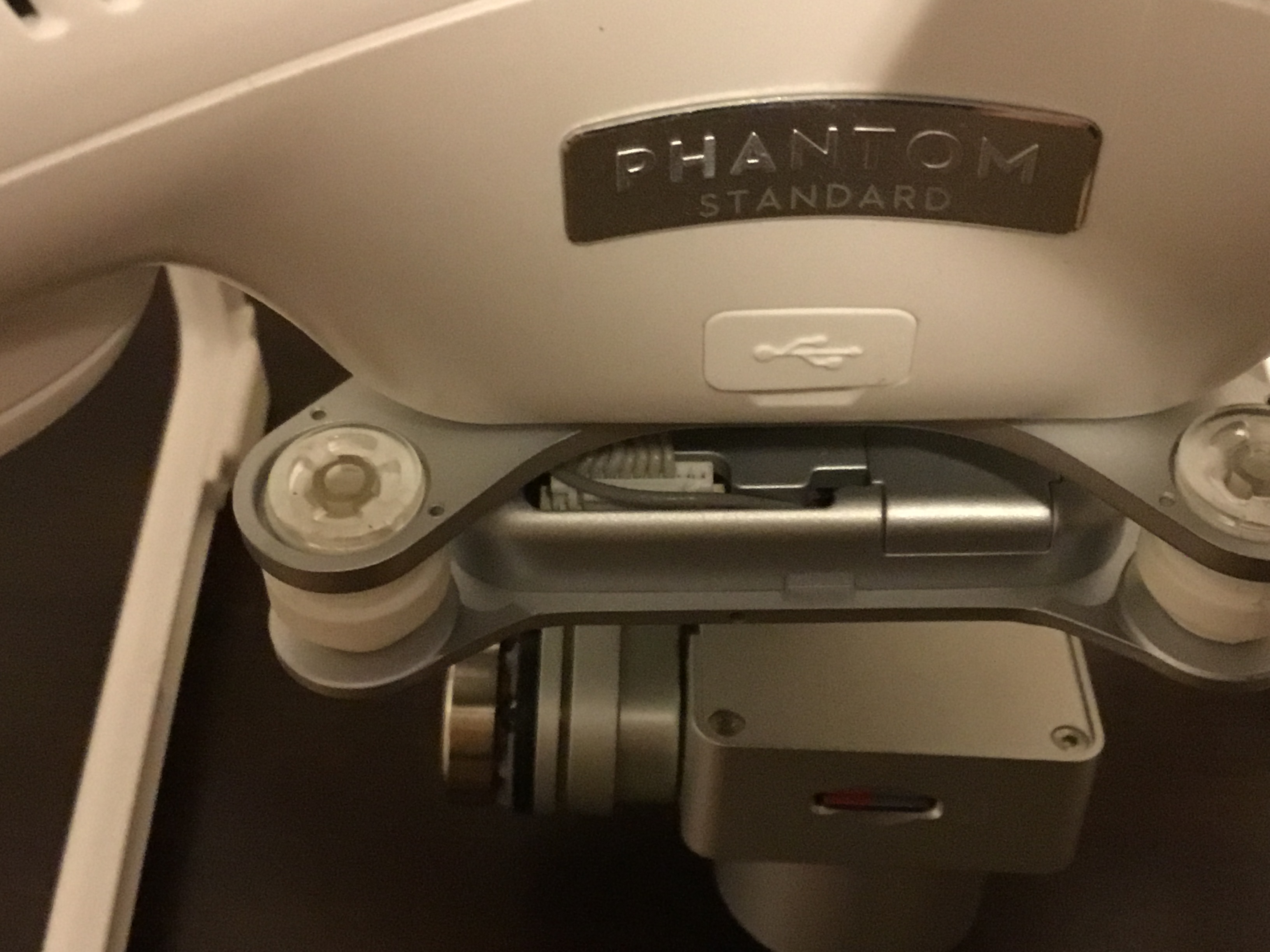

Thanks. Well it did bounce and kept flying. Gamble calibration failed. I checked all the gimbals. The move freely with no binding. I check what I could see without taking apart. Is that the white plug in the picture.
Yip that's the one,,you can drop gimble grommets to unplug and reinsert,but if gimble calibration not work I would take that gimble off and fully inspect
