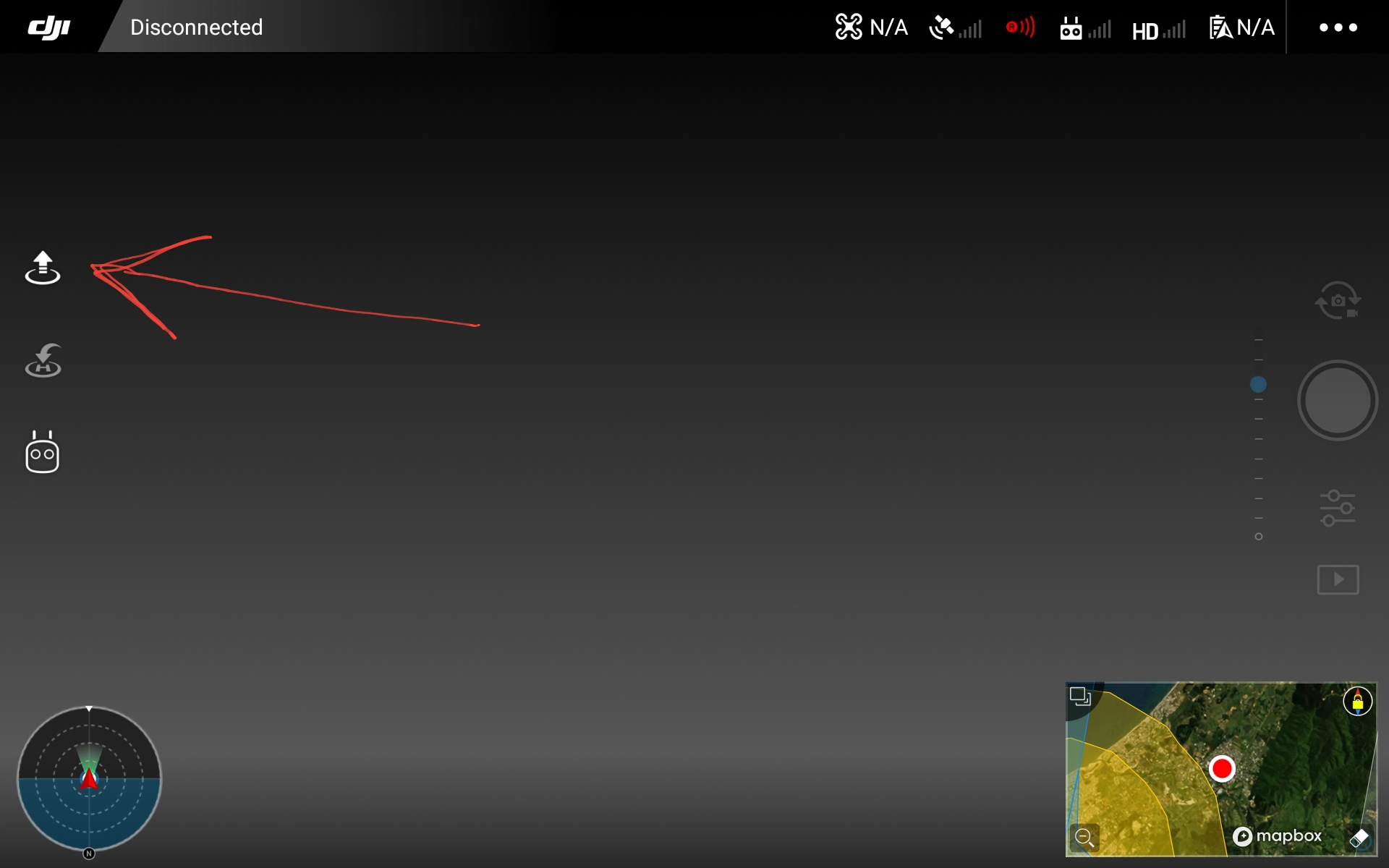

1. in the quick description you can see a button that initiates the landing from vertical hover over the ground, similar to the landing function of the DJI Mini.
- however I do not see this button in the screen. At any time. The only option available to me is "return to takeoff point and autoland - (the emergency option of return should be this).
-> how do I get this button, I can currently only land manually, I don't like this as much as I do with the Mini and this function should be there.

Welcome and merry xmas
In app this logo is auto take off and auto landing ,,
