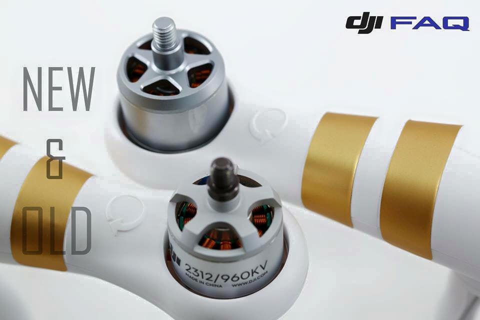

It’s easy to identify which version of motor, old is 2312, new 2313A- 960 vs 800kv if I recall correctly. Motors are not interchangeable between mainboard versions.

Indeed it is a typo on the model numbers, thanks. The part numbers are a different story- DJI P3-094 & 095 (CW & CCW).
Are they? :)... Oh dear oh dear!... I think it's the other way around!!
For 2312A, part # 95 is the CW one and # 94 is the CCW one.
Precision in all things... ;)
Only joking with you, of course.... :):) (But they are the other way around...) :(+:)
