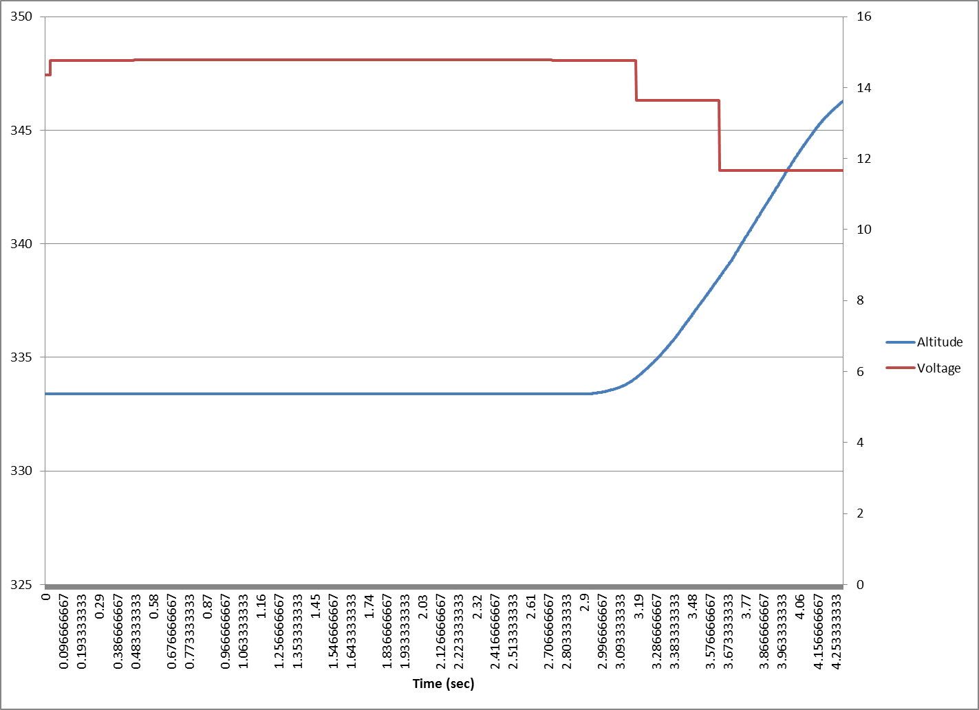

So sorry for you crash. Looking at the flight data I can add some possible insight/help/explanation.
When he powered on the voltage was at 15.1 V or 3.76V. At this point this is the only information the Phantom has to determine the SOC for the battery. From my experience flying from a full pack that is about where the Phantom estimates the remaining charge to be around the 54%. As he took off the voltage dropped rapidly. It was below 14V at about 3 second and I figure he had maybe 1 second to notice and land (see chart below). As Luop mentioned I not sure why the SOC of the of battery didn't change, unless is sets based on the starting voltage and then uses current integration from there or is not re-calculated frequently....
I just looked at another DAT file and noticed capacity did not change for about 8 seconds....so perhaps it does not update that often, what do you think @BudWalker, how often does remaining capacity update?
The amount of energy taken from the battery before crash was very low by my calculations, like less than 1 Wh (the battery is 68 Wh).
It does not appear the initial assessment of the battery's SOC was off based on the voltage, but it seems that the Phantom did not determine soon enough that the SOC was not accurate....
In the .DAT the remaining capacity is a 1 Hz signal. Same for all the other battery data.

My P3S crashed from 9m height onto concrete yesterday - sudden power cut mid-air. The drone was only about 10m away from me. (screenshot attached)
Prior to flight the battery was 100% charged.
At the Point of the power cut the drone had just gone into automatic landing due to low battery, but there was still 1:51min worth of battery left. It was the maiden flight.
Any idea why this could have happened? Is it likely that the drone was faulty Prior to the Crash?

Thank you gentlemen for your posting of the data results.
Looking at the battery voltage shows what more than likely happened. Voltage dropped to below required level thus shutting down the system.

Here is the log from the dat:
You will note that battery capacity indicates 54% at end of flight (red bar on chart) but voltage per cell is between 2.84 and 2.93v. A lipo indicating such low voltage means battery is empty - so again this is an error/bug in the smart battery thinking it has 54% remaining capacity when it should be 0%.

This isnt only happening to flights with day old batteries though, while there are plenty of those reports, this happened to my bird & others w/ freshly charged 100% bat w/ the relation being its happening a few seconds into the flight
I have just found another piece of information on my flight that ended in the crash: the voltage of cell 1 dropped below 3V which caused the pack to shut down, see screenshot attached.
