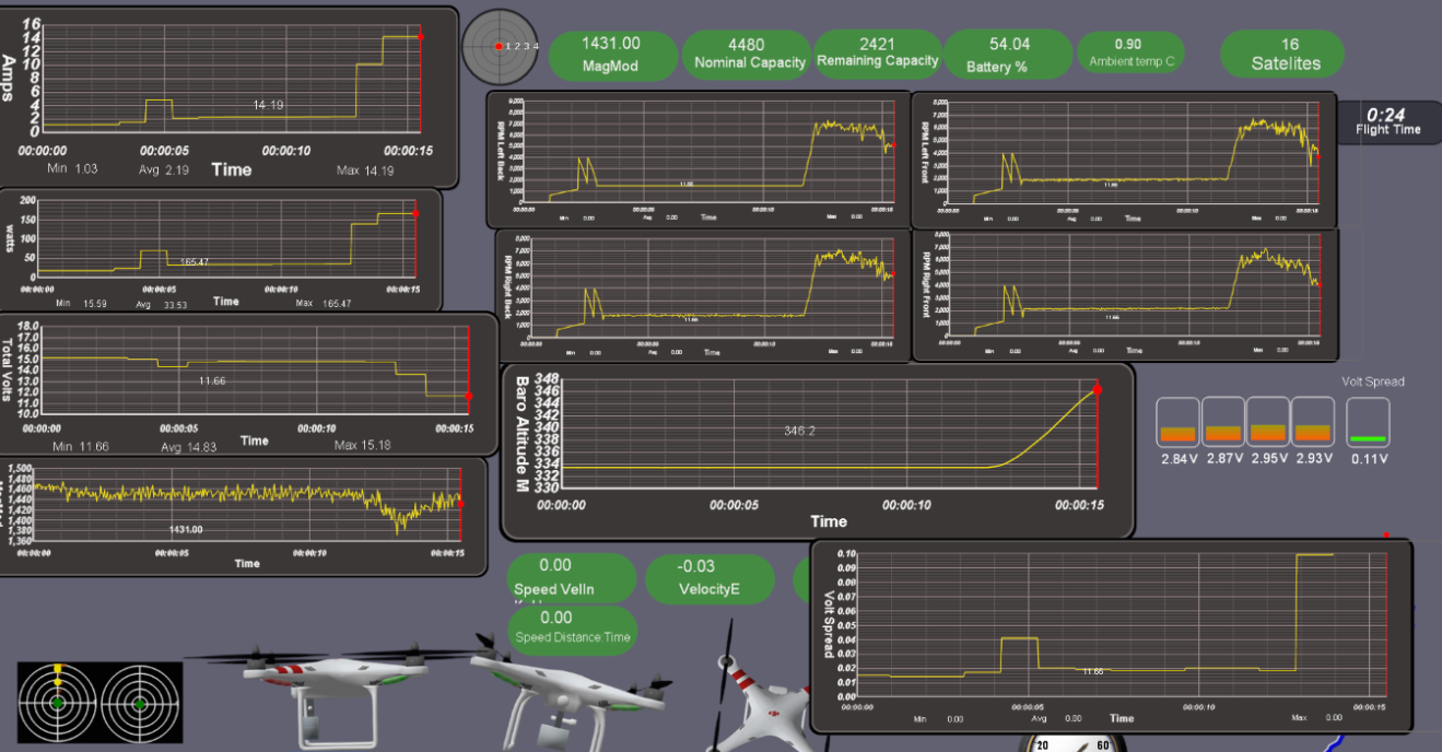

    Flight Log video.
    Notice that the only stick movement is during the liftoff. No other input. Maximum altitude was 41' straight up (with a little horizontal wind drift movement).

    Here is the log from the dat:
    You will note that battery capacity indicates 54% at end of flight (red bar on chart) but voltage per cell is between 2.84 and 2.93v. A lipo indicating such low voltage means battery is empty - so again this is an error/bug in the smart battery thinking it has 54% remaining capacity when it should be 0%.

    So sorry for you crash. Looking at the flight data I can add some possible insight/help/explanation.
    When he powered on the voltage was at 15.1 V or 3.76V. At this point this is the only information the Phantom has to determine the SOC for the battery. From my experience flying from a full pack that is about where the Phantom estimates the remaining charge to be around the 54%. As he took off the voltage dropped rapidly. It was below 14V at about 3 second and I figure he had maybe 1 second to notice and land (see chart below). As Luop mentioned I not sure why the SOC of the of battery didn't change, unless is sets based on the starting voltage and then uses current integration from there or is not re-calculated frequently....
    I just looked at another DAT file and noticed capacity did not change for about 8 seconds....so perhaps it does not update that often, what do you think @BudWalker, how often does remaining capacity update?
    The amount of energy taken from the battery before crash was very low by my calculations, like less than 1 Wh (the battery is 68 Wh).
    It does not appear the initial assessment of the battery's SOC was off based on the voltage, but it seems that the Phantom did not determine soon enough that the SOC was not accurate....
