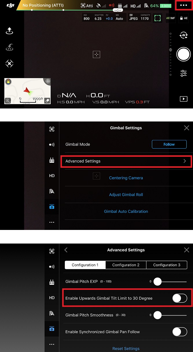

Hi Guys
I've recently noticed that my gimbal only operates 90 degrees between level and straight down.
It's missing the 30 degrees up.
It used to go up and there's been no crashes or updates to affect it.
Any ideas?
Thanks
Phill
You'll only be able to tilt it up if you enable the following setting in DJI GO:
Thanks msinger
I'm sure it used to do it before.
Dunno why it stopped but there's now a blue dot on the indicator where it stops.
There used to be a red dot at the top when it went all the way.
Thanks msinger
