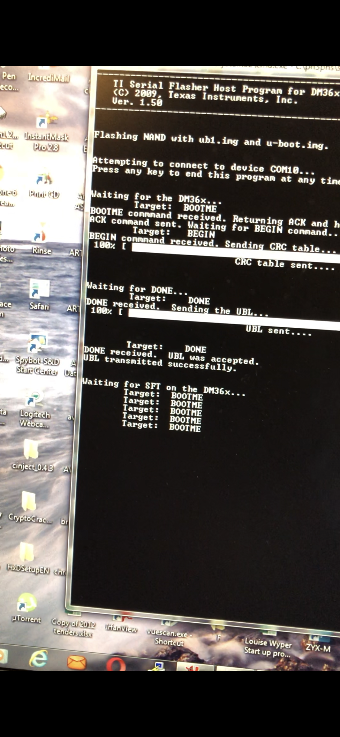

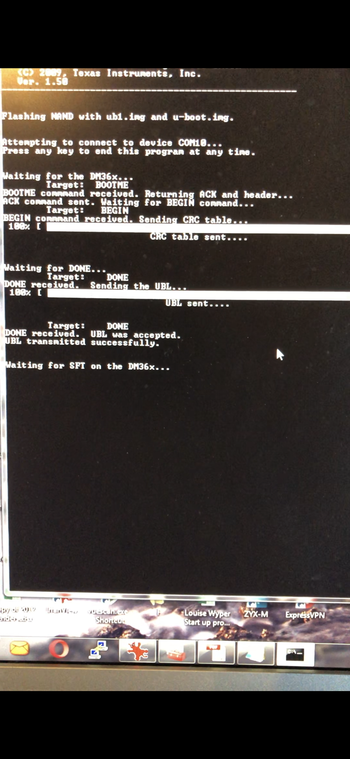

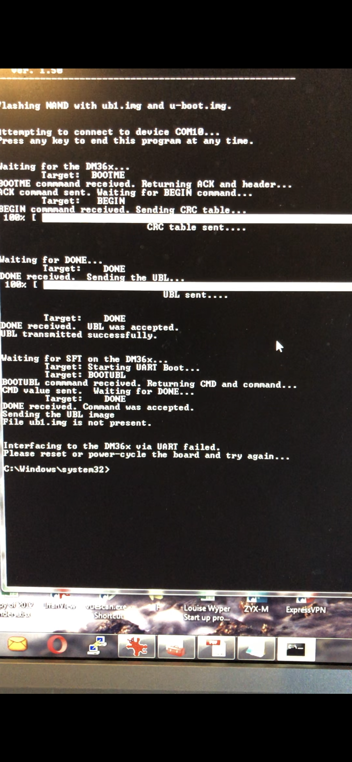

Is this a success or has it failed on ubl1.img I have triple checked the image name.

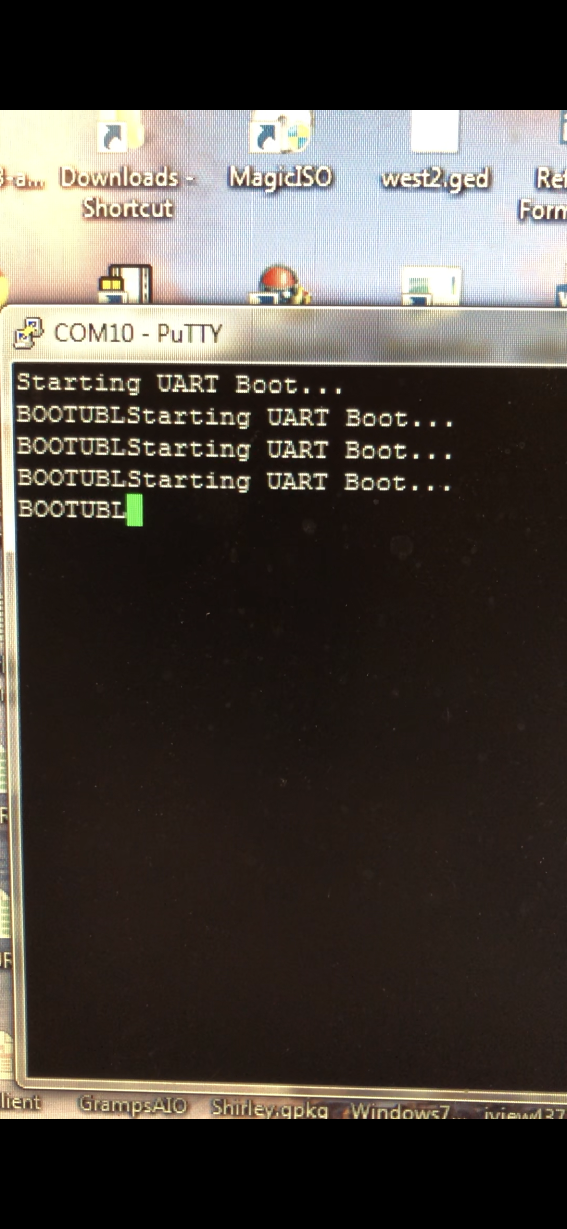

The other part that I dont get is that unless I have board powered up before I start Putty it crashes Putty with a com error. So if i boot by connecting ground or 3.3v Putty crashes. Its Usb 2 port which appears only to support 500mA, so is this the likely problem. Am i best to look for something with Usb 3.0 socket or a powered hub ?
It failed. I've seen other people complaining about this error too. They claimed the file is where it should be, has proper privileges, and they tried shorter directories or placing the files in root dir. But the problem persists. No idea why; issue with C# libs? It worked for me.
Oh right, maybe that's the problem. I used external powe brick, as the device needed more that 1 Amp of current. I guess if you connect to 3.3V line it may need less, as it will not power Ambarella and STM32.

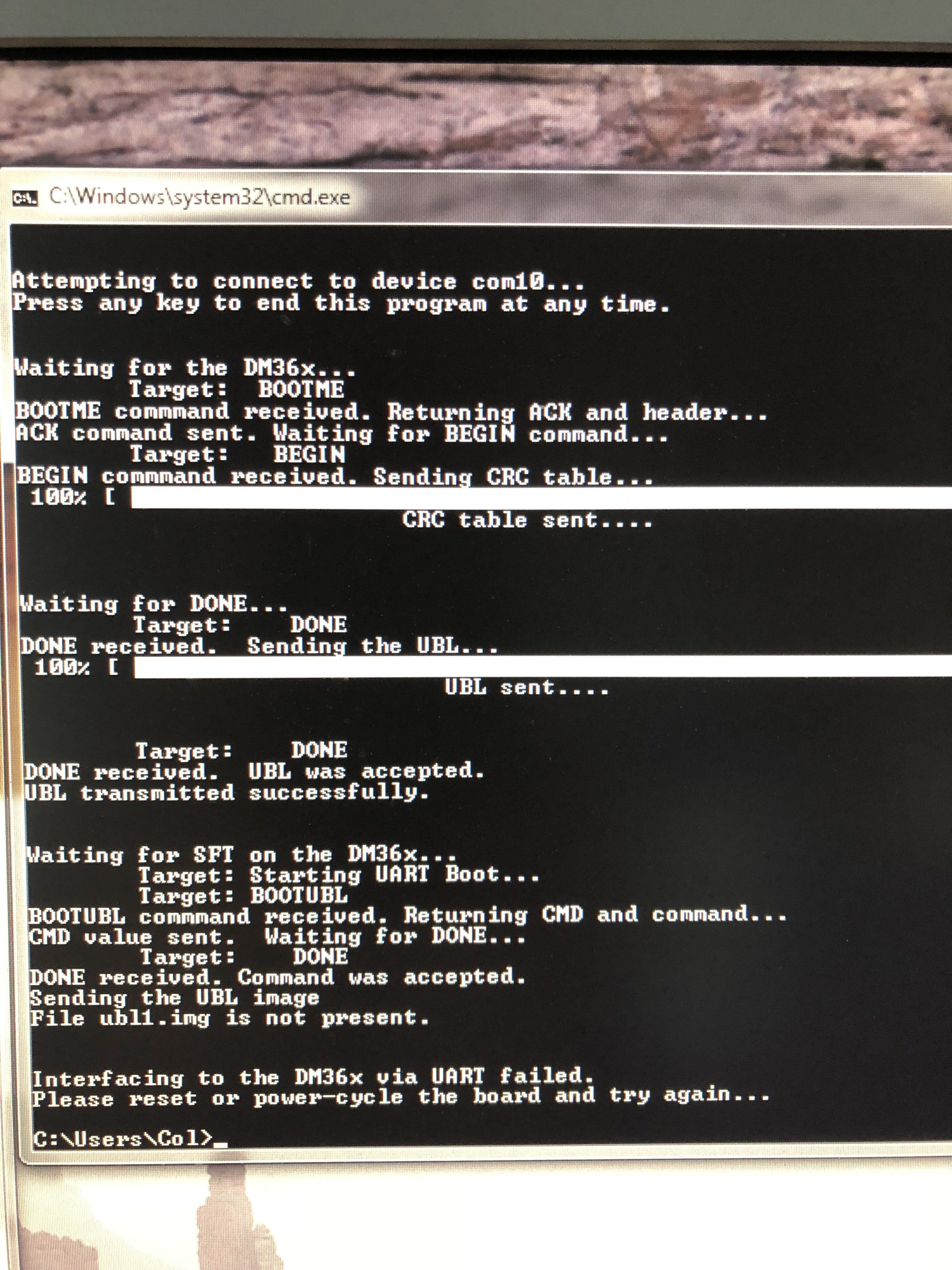

Bought a powered usb hub. Renamed the file copied it to root. Checked the properties. Still no joy. Does anyone have a solution to it. Can’t see why it’s not seeing file. Are we sending the exact same line both times should second time not be different ?

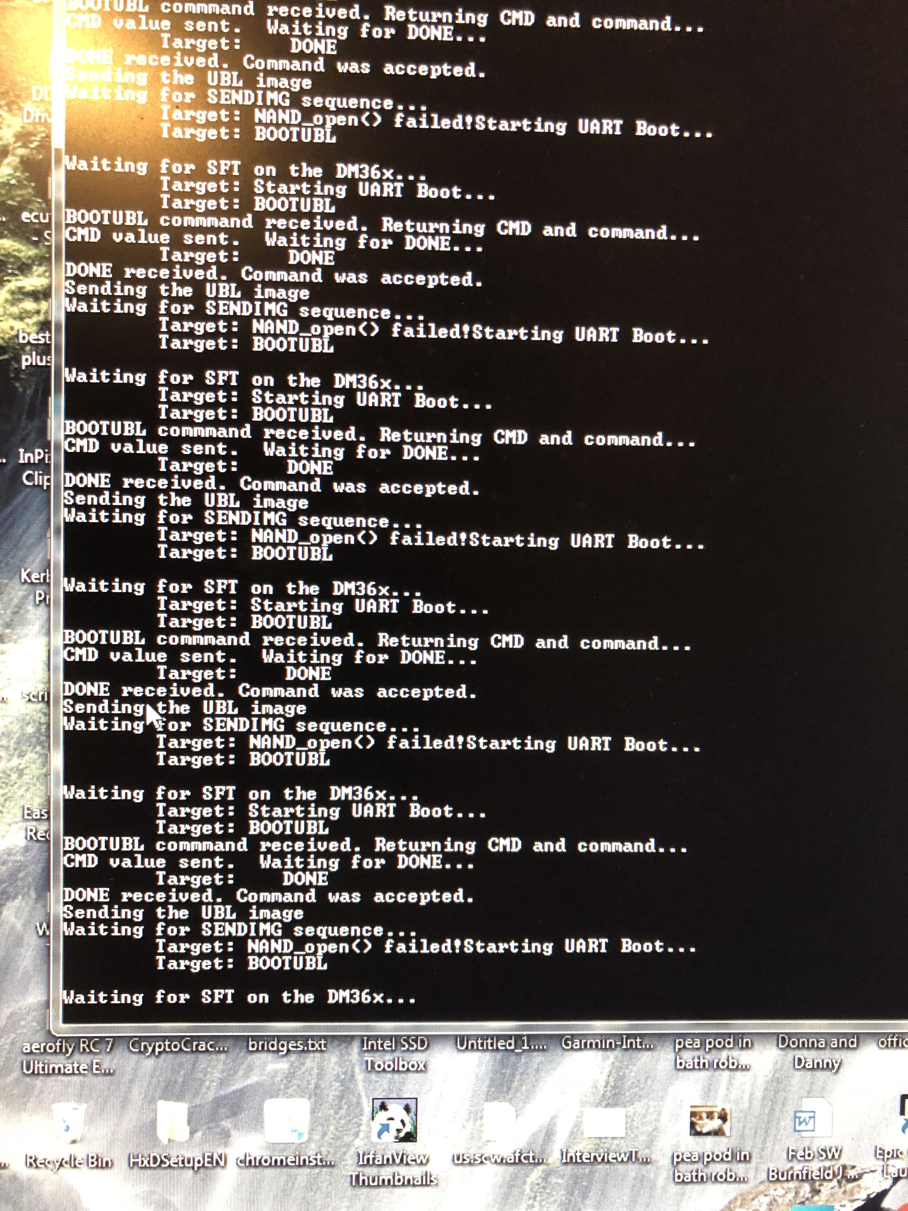

Just to add copied the image file to c:\users\”current user” seemed to stop file not found error now I have a new error nand open<>.

Then you have the issue I described here:
Fixing flash in DM365 chip within Ph3 Pro gimbal
Sorry, no go without new NAND. You may try rebailing first, though.
Also, after replacing NAND the FPV will only work at 8fps - a fix for that is now being developed; hopefully it will be as easy as connecting to a PC and running a command.
