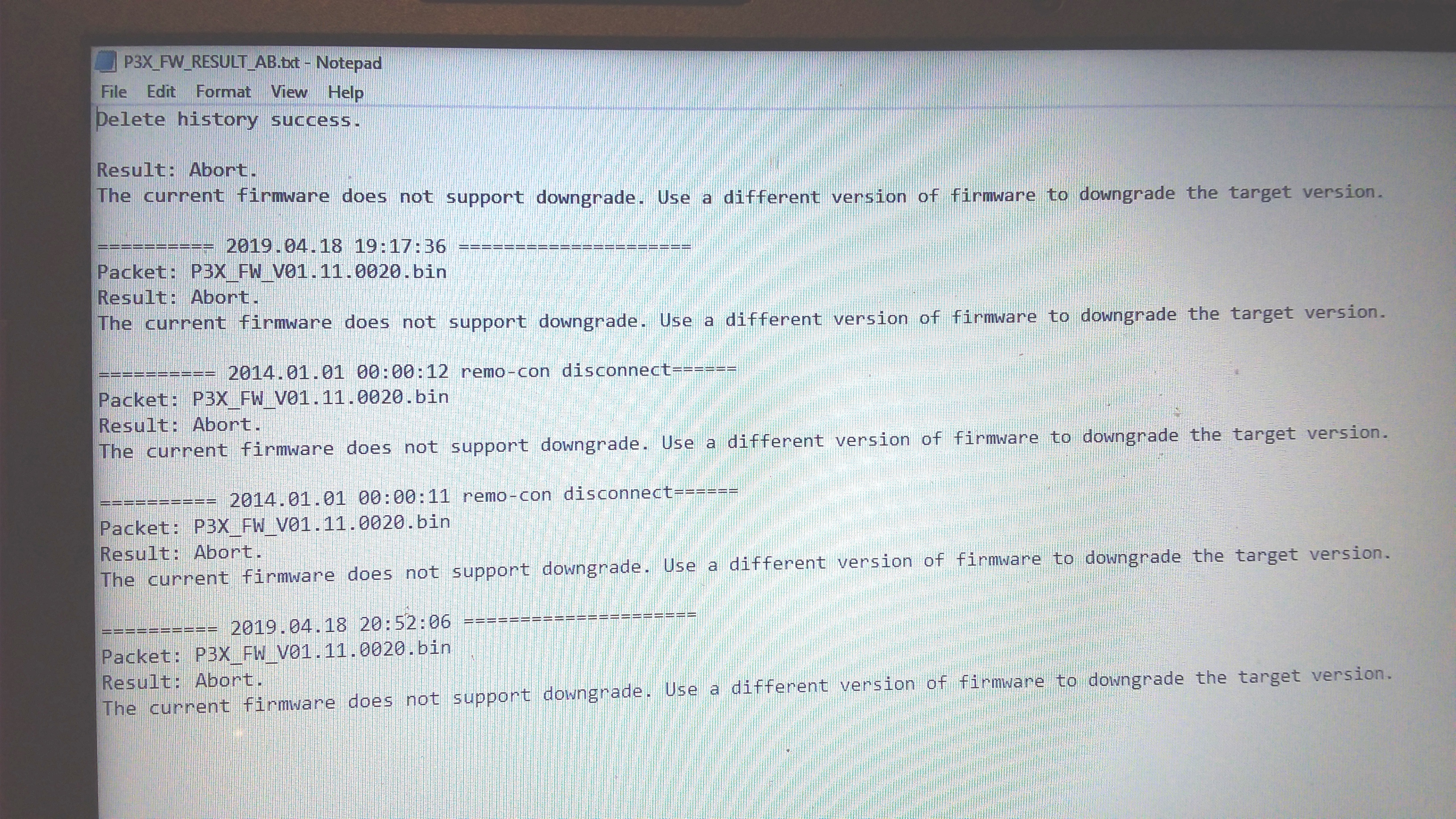

Good evening all. I finally bit the bullet, and traded my 7-year old Phantom for a factory-refurbished P3P. By now, I have spent many days trying to get copter, remote, and batteries to update, but to no avail. I'm using the DJI Go app, version 3.1.52 (downloaded beginning April 2019), and have found out that the copter has firmware version 1.5.30+ and the RC has firmware version 1.9.3.
As instructed, I put the most current bin file (1.11.20) on the root directory of my SD card, and tried to update the copter, RC, and batteries. Nothing meaningful happened (and I think I watched every tutorial on the internet by now). Interestingly enough, my app tells me that all I have to update is my battery. When I try to do just that (after turning off the RC and app), nothing happens, but the txt file informs me that the update has been aborted because it won't allow me to downgrade the firmware (see screenshot).
So this is a bizarre situation: my copter and RC have older versions of firmware, but the app has no problems with that, and I can't update them. The app wants me to update the battery, but I can't do that either.

I suspected you had FW v1.11.30 based on your other posted log, and that is indeed shown in the portion of LOG_AB you posted. Your log is missing a great deal of individual module information.
DJI had been officially providing a new FW version to select users who say they saw ESC issues after the update to 1.11.20.
They were providing a tweaked version (1.11.30) on a case by case basis as you can see here:
Firmware v1.11.30 for ESC error??
I don't know if they are still offering it directly to people as they were in the past and as far as I know they never made it widely available. A few people here were a bit irate about it not being posted on the DJI website for everyone. Now it seems that DJI has been using v1.11.30 when refurbishing units and not letting buyers know about it.
Some who were given the tweaked FW by DJI directly made it available via a download link on both this forum and also the DJI forum. I archived a copy of 1.11.30 in case I ever needed it in the future, though I don't expect to ever update beyond the older FW versions I use currently. These second hand 1.11.30 FW files may be legit, but since I didn't get them directly from DJI I wont be sharing them here. You can easily find links in a search of this forum (and others) to download a copy of 1.11.30. The most popular one here seems to be through MediaFire.
If it were mine, I would try getting that .bin and using it instead of v1.11.20, but you have to make that call for yourself.
Of course, it's a risk to both use it from an unofficial source and also to use it if it will mask a more serious issue with your AC.
Since you bought your as a refurb from DJI, maybe if you contact DJI they will give you an official copy of v1.11.30.
Again, your call to try that or not.

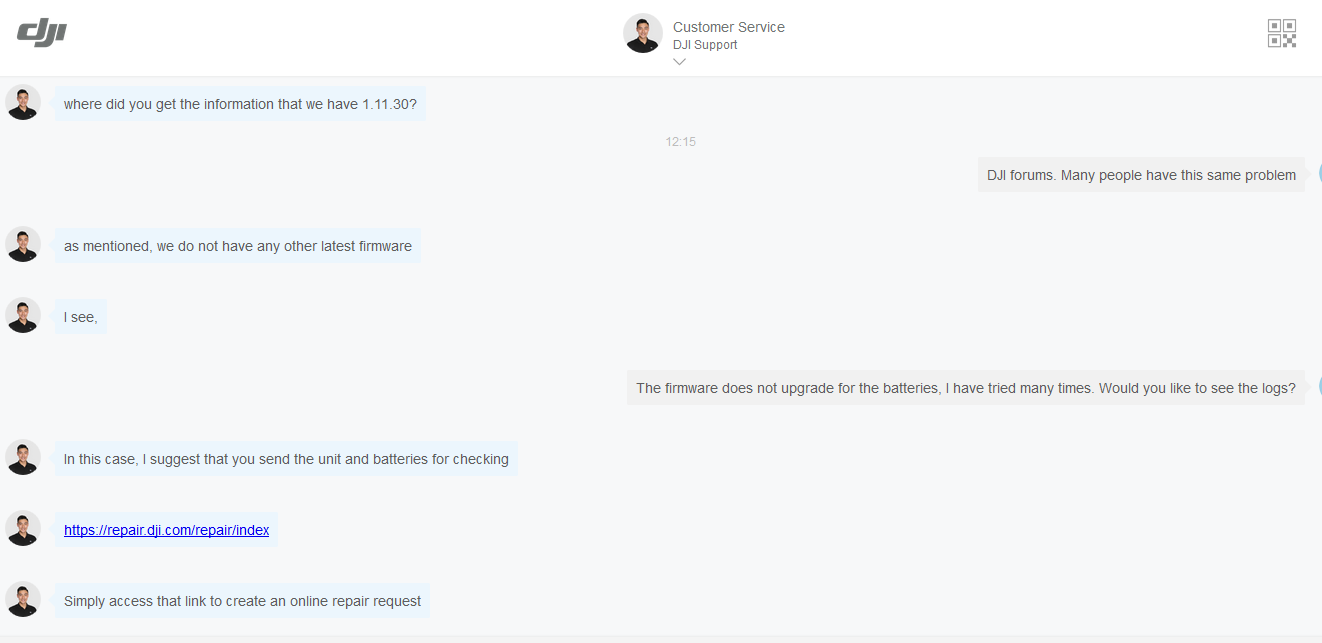

I contacted DJI and their customer service person denied that there ever was a v.1.11.30, and encouraged me to contact their repair people to have the unit sent back to them for servicing, which is ludicrious:

I have no idea what to do here.

Thanks for the tip, I'm giving them one last chance to respond to the email i sent them, since I'm making a serious effort to keep this all within DJIs system, if at all possible. Three questions, if you don't mind:
