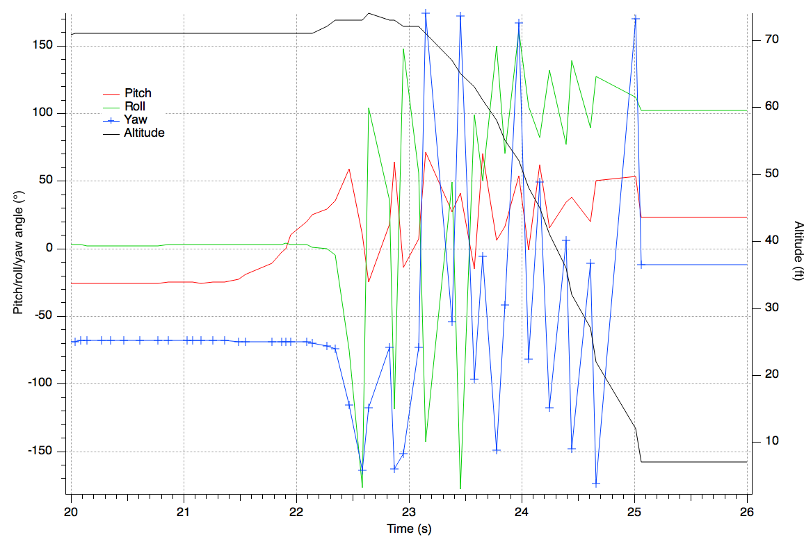

It looks like it lost the left rear prop at around 22 seconds, causing it to pitch back, roll left and yaw left. Game over.

Thanks To All of you for your valuable insights and amazing knowledge. I was flying fpv manual to attempt fireworks photos aeb with Table Mountain in background. Could not get to location shown on map after crash as high concrete breakwater prevented me so AC lost. So could not see if prop lost or retrieve sd. Sar104 how did you generate the graph? I am sure I lost a prop. Being self tightening find it strange it didn't dislodge earlier. Tks All
My conclusion as well, and you beat me to it @sar104 .........
I downloaded the .csv version of your log file from the PhantomHelp website, imported the data into a data analysis program, and then compiled the relevant data into that graph. Looking at the pitch, roll and yaw data is the best first step to figure out these kinds of events, and the signature of a lost prop is quite distinctive.
