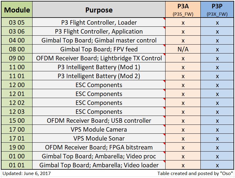

So to me it sounds like your OFDM board is having issues and may need to be replaced or has something disconnected. I say that because your log_ab file shows as failing for module 19.
Reactions: JoBe
Do you know what a mean module 19?
OFDM board.
Read this post and then that members follow up posts:
Downgrading firmware on P3P from 1.10.9 to 1.7.6
Also, for more info on the modules and their firmware, click here.
