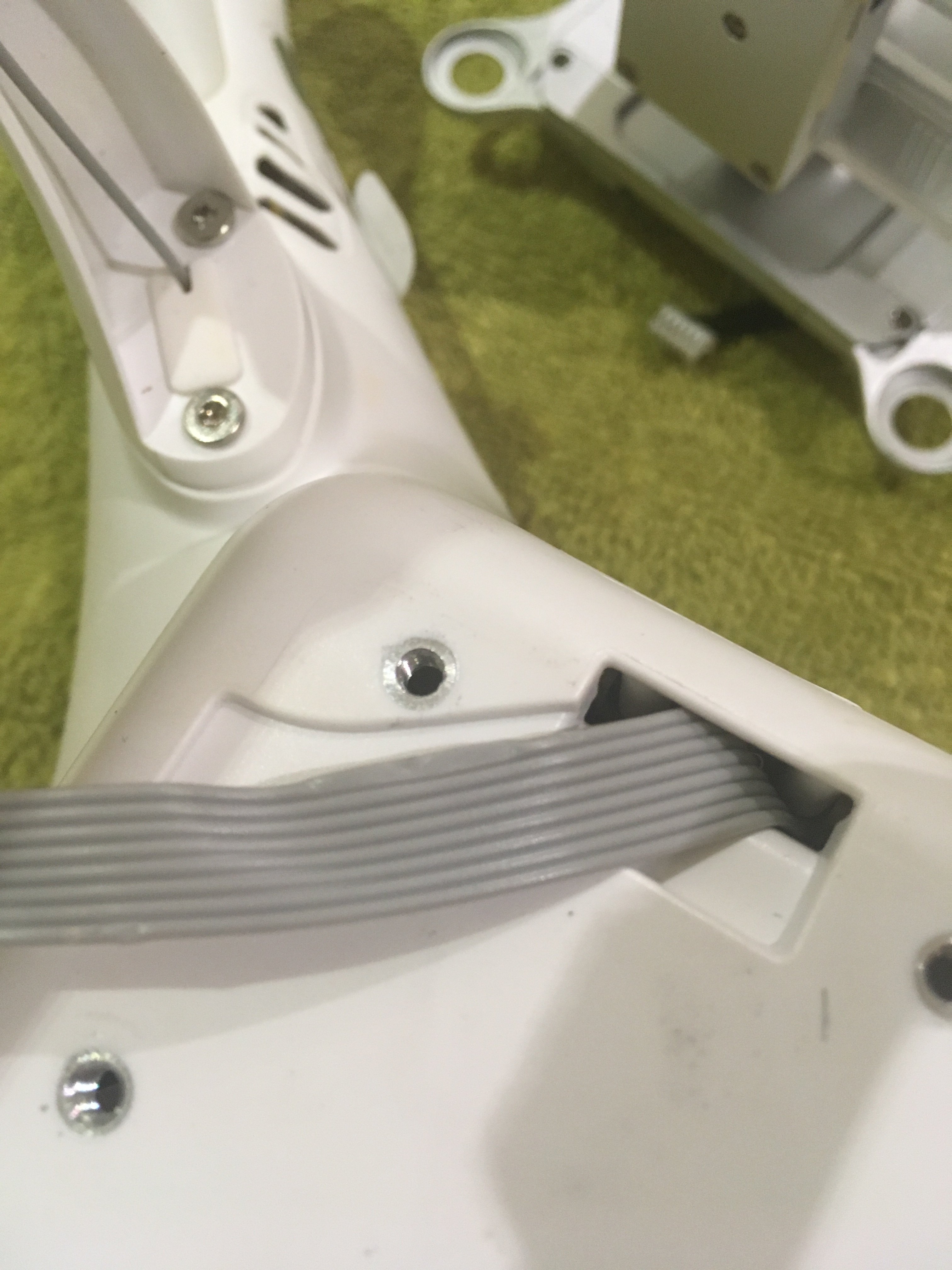

Hi guys.
Just about to strip the bird down to wipe the connectors with alcohol wipes and look at this picture !!!!
It looks like the previous owner has not put the ribbon in the right place and squashed the outer copper strand
Hi guys.
Just about to strip the bird down to wipe the connectors with alcohol wipes and look at this picture !!!!View attachment 103929
Absolutely chuffed to bits. Placed the cable in the recess and immediate fix.... still going to order a new cable and replace. Have you guys got a decent YouTube video on how to get into the unit to replace the main cable!!!!!
Good job! Seems like 90% of the image problems I read about are related to that ribbon cable.
