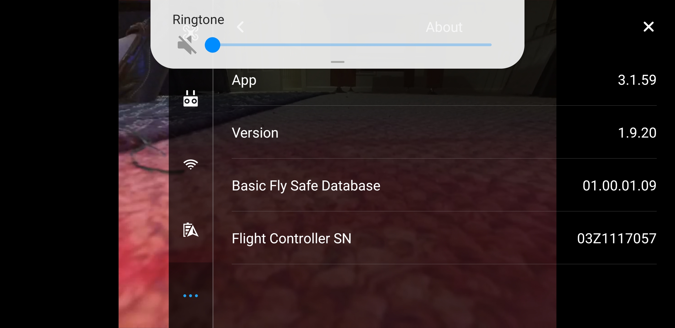

I was wondering if the OP's GoApp was the latest version. I'd wager that some firmware versions and GoApp versions don't play well together. Probably designed that way by DJI. That's pure speculation on my part however.
My app reads 3.1.50. OP app is 3.1.59. I have not used that tablet in a while and as such I'm sure there is a pending update.

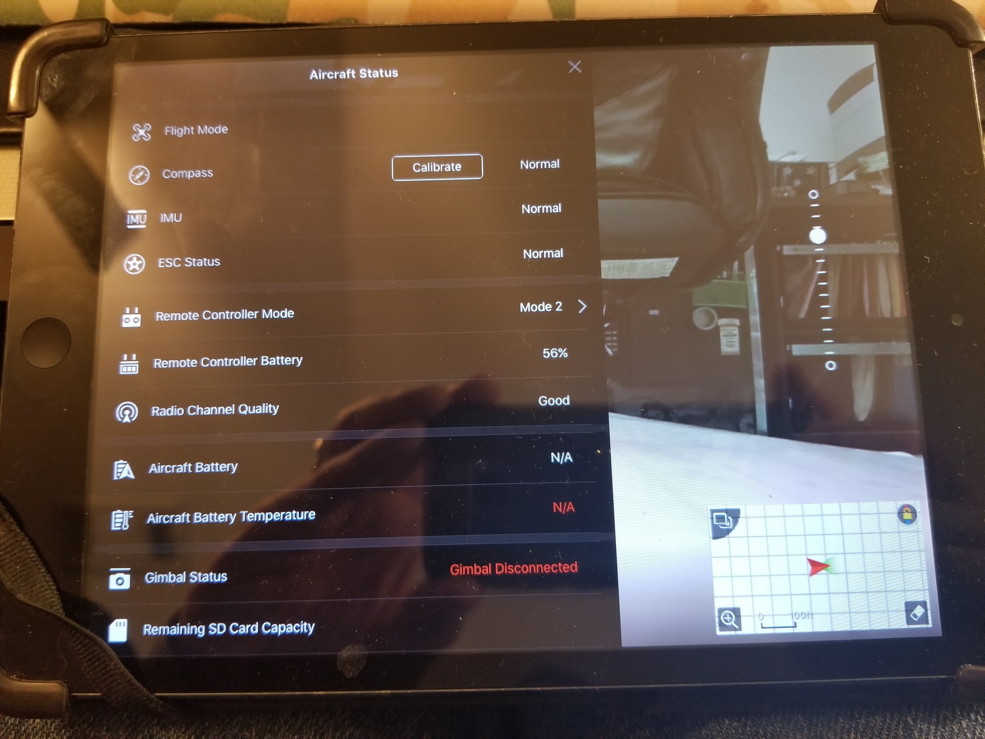

Here is my Flight Status Screen. Does the "Gimbal Disconnected" message give a clue?
Drone Nerds thinks its my motherboard and wants me to send it in for repair. Not sure what to think of that - will the repair cost more than a new drone? And i have no original packaging to ship it it.

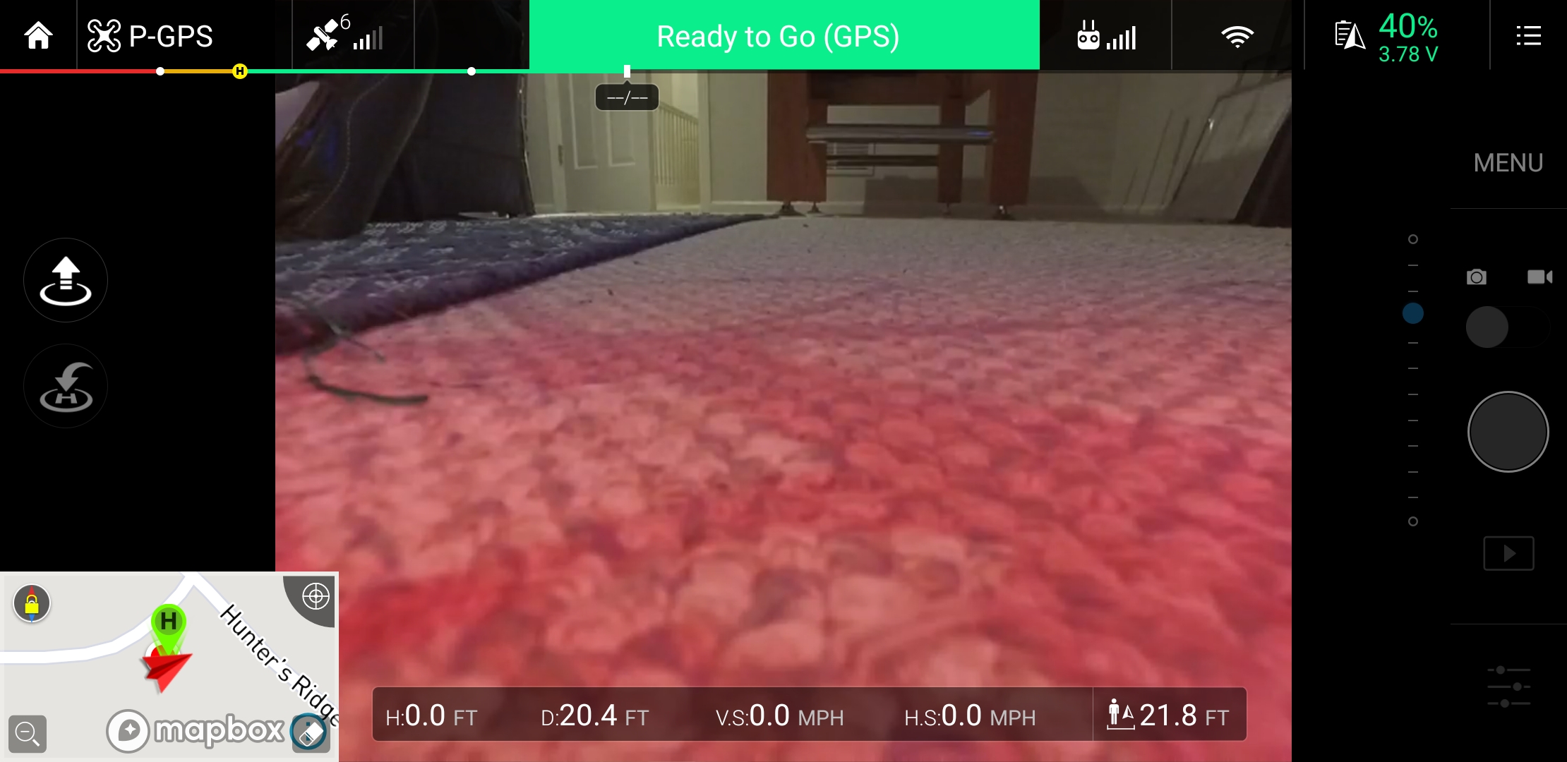

One other bit of evidence. I also fly it with my cellphone, a Samsung Galaxy S8. Again, i have reloaded the GO App several times.
On the Samsung, my camera screen and menu appear but shadowed in background and not operable to select. It is non-operational - just a background
icon that will not permit it to be selected.
On the Samsung, my camera screen and menu appear but shadowed in background and not operable to select. It is non-operational - just a backgroundView attachment 118203View attachment 118204 icon that will not permit it to be selected.
