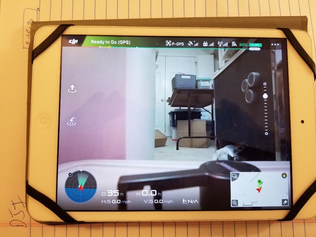

As you can see, on my iPad Mini 2, there is no camera icon, no camera menu
Can still fly and get all good connections and signals from bird and RC.
In response to CaptainMileHigh's suggestion, how do i go into 'settings' and reset camera settings?
The camera menu above where the Record button should be located is also not appearing, Isn;t that the camera settings menu?
I'm at a loss here. The app tells you if no SD card. I wonder if the app thinks there is no camera attached?
I went through the app again and can't find anything that might be a clue.
Yep. I'm trying to troubleshoot it too. I use a IPad mini 2 also, so it looks the same as mine. He was all powered up (ready to fly) so the full camera menu should be there, and not grayed out.
If it’s even similar to a P3P, you should be able to tap on the green Ready to Go at the top of the screen and it will show whether it is detecting an sd card. Along with other aircraft information.
I powered up one of my P3S's in the house a few minutes ago and could not duplicate his screen. Even doing the swipe up or down to go to full screen worked as it should and the camera screen returned as normal.
I'll keep looking for a fix for BMac15's issues. Need to get that camera menu back somehow.

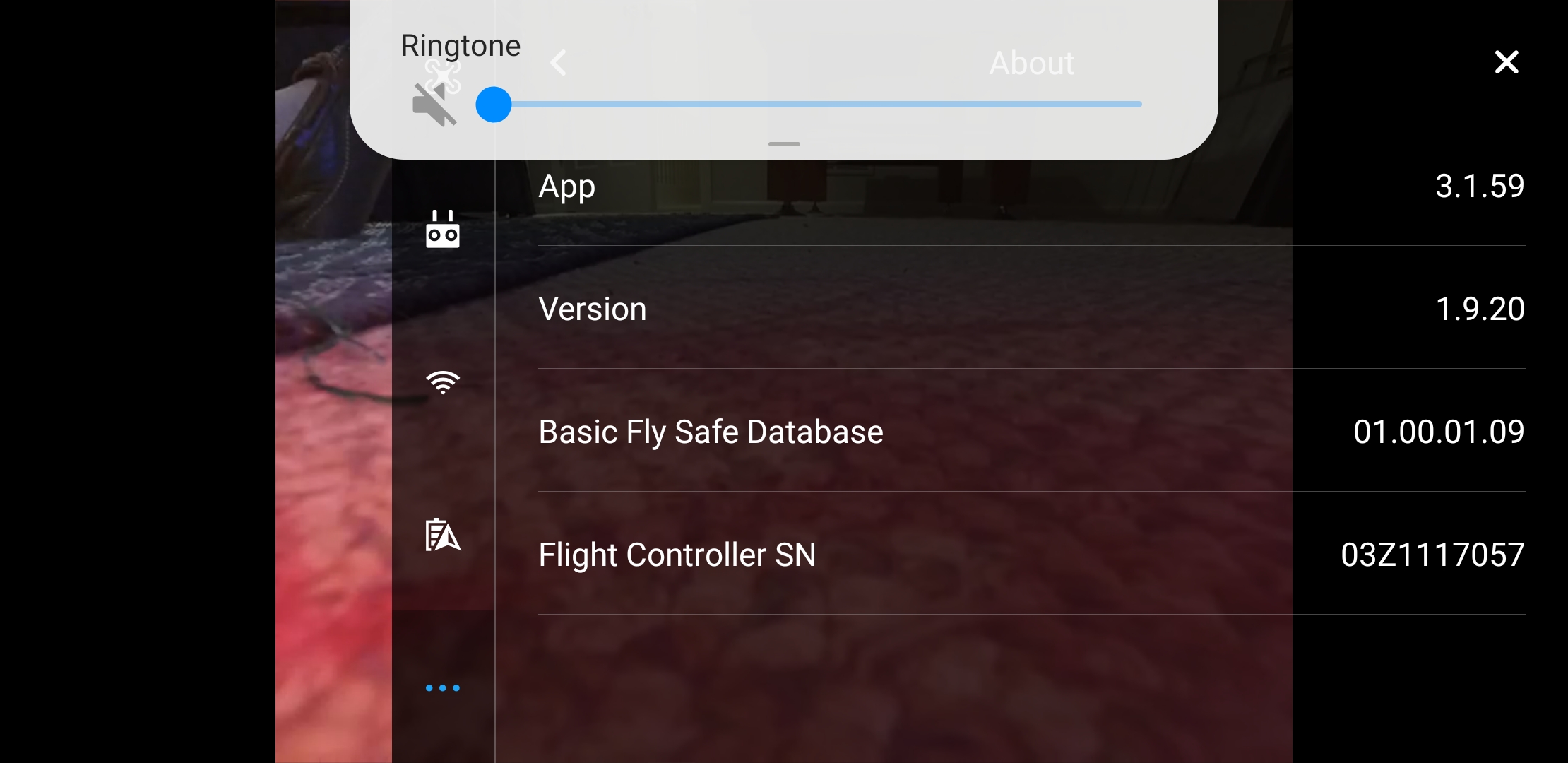

The firmware seems up to date. Mine says 1.9.2.0+. Can't remember what the plus sign means. I wonder what happens with a different app. Any chance you want want to purchase Litchi and gave it a try? It might narrow down the issue. And just to be sure, this happened prior to the attempted update?
I was wondering if the OP's GoApp was the latest version. I'd wager that some firmware versions and GoApp versions don't play well together. Probably designed that way by DJI. That's pure speculation on my part however.
