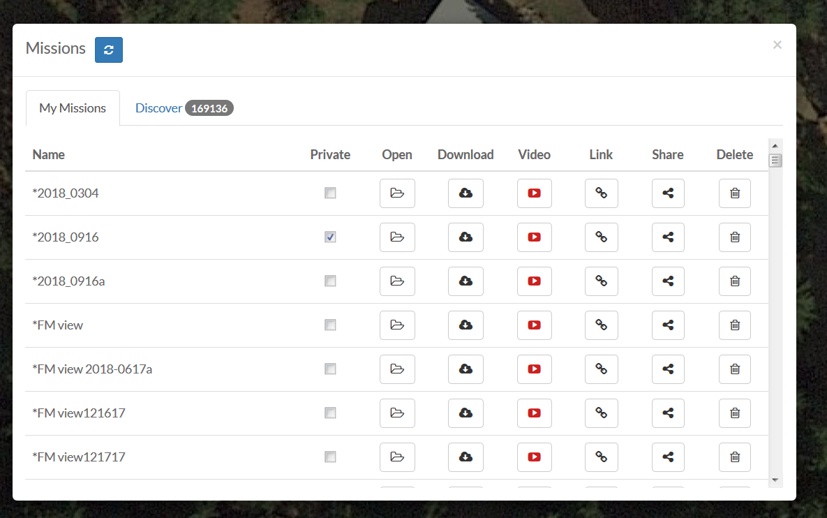

You need un check the private box.
Rod
What I do is open the mission hub, make sure it not marked private, open the mission, then copy the URL from the browser, and then past it here, instead of using any of there provided buttons.
Then it always works.

That works, now lets go back a couple of steps.
Answer for post #3.
This mission you have shared was the one you made on your mobile?
