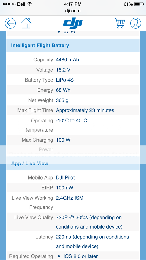

P3 flight battery will be a 4S 4480mah 15.2v

I also believe a 4S LiPo is rated at it's nominal voltage which is 14.8v not 15.2v.

Yup 4S is 14.8v but oddly enough, I got the voltage from the DJI website.
Acknowledged.
Seems fishy to change the nominal volt/cell rating method between P2 and P3.
Maybe to 'sound or look' better???

Yea I know.
I've been using LiPos for about ten years and those numbers are atypical specifications.
Look up any 4S LiPo [nominal] voltage and get back to me.
DJI has decided to spec. it at a different charge level.
This same level would spec. the P2 Batt. an 11.4v, atypical.

Yea I know.
Hmm, one question would be, what would the nominal voltage be on the new LiPo chemistry that has a peak charging voltage of 4.35v/cell instead of 4.2v/cell?
These have been showing up in phones since early 2013 (Oppo Find5 had a 4.35v cell, so does Find7 and Sony Xperia Z3) - these cells might have a 3.8v/cell nominal rating instead of 3.7.
At least some people rate the 4.35v cells with a nominal of 3.8 instead of 3.7 - http://www.highpowertech.com/product_096ffc299200f517.html
That might be another reason DJI broke compatibility, if they switched to a new chemistry, they would have had to stick with incompatibility even at 3S.
