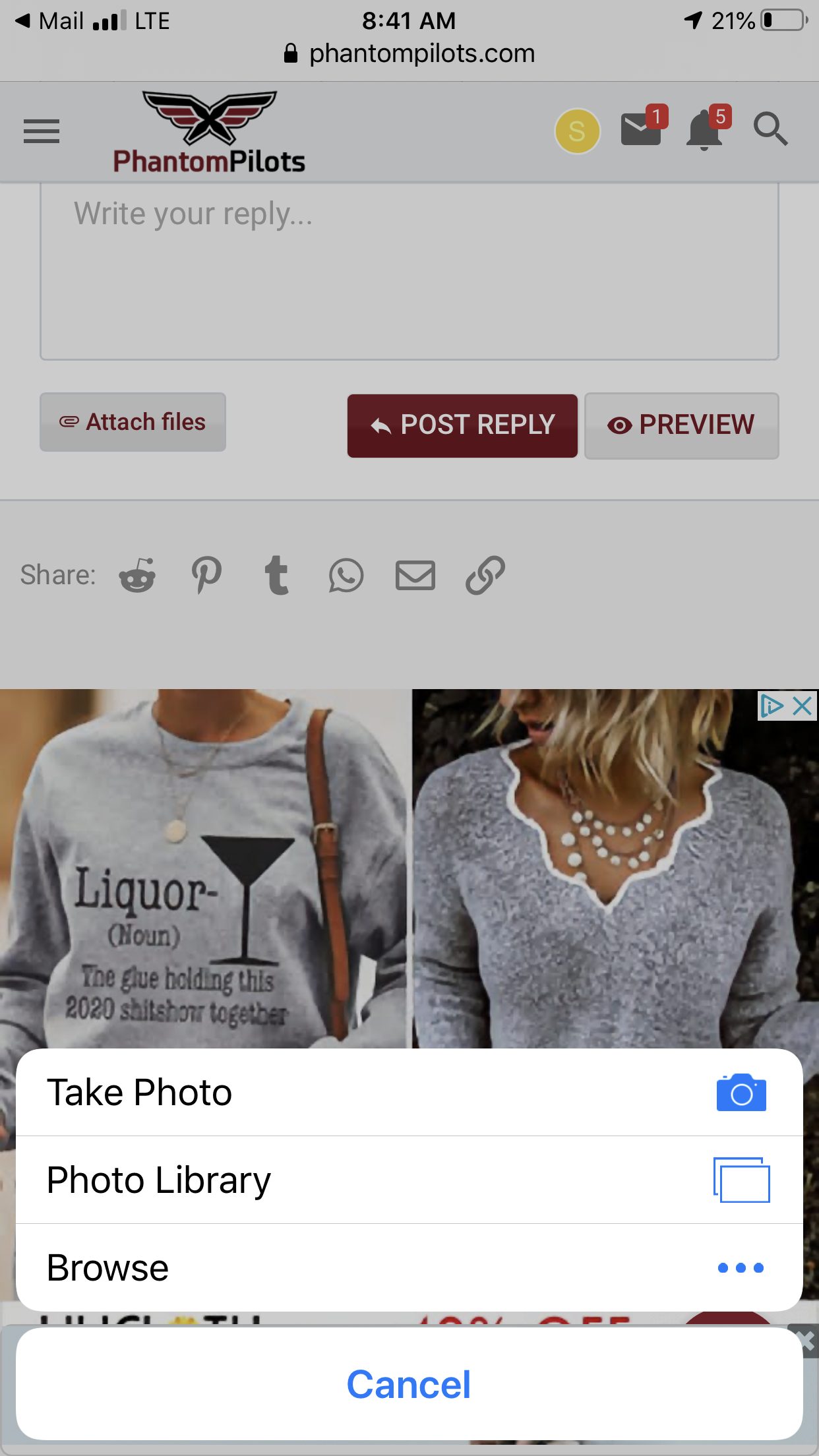

I need to host photos on-line to view?
Can’t “upload” ?

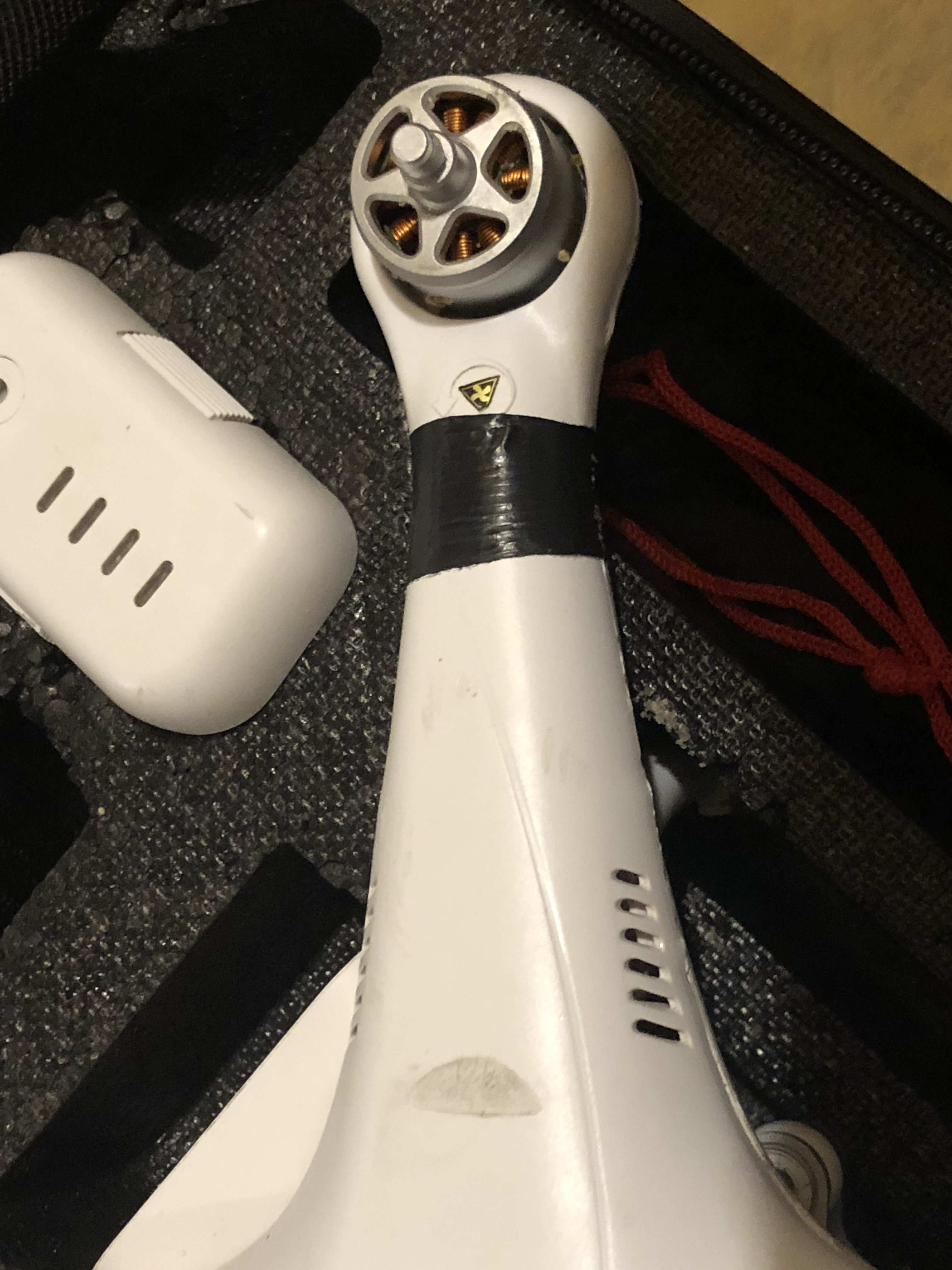

Anyway, that first photo looks to me as if you may have had significant cracking under that motor. I say that because we've seen photos of motors coming loose when the cracking under the motors has become too bad without intervention of some sort. Prior to the crash, did you have the dreaded cracks under your motors?

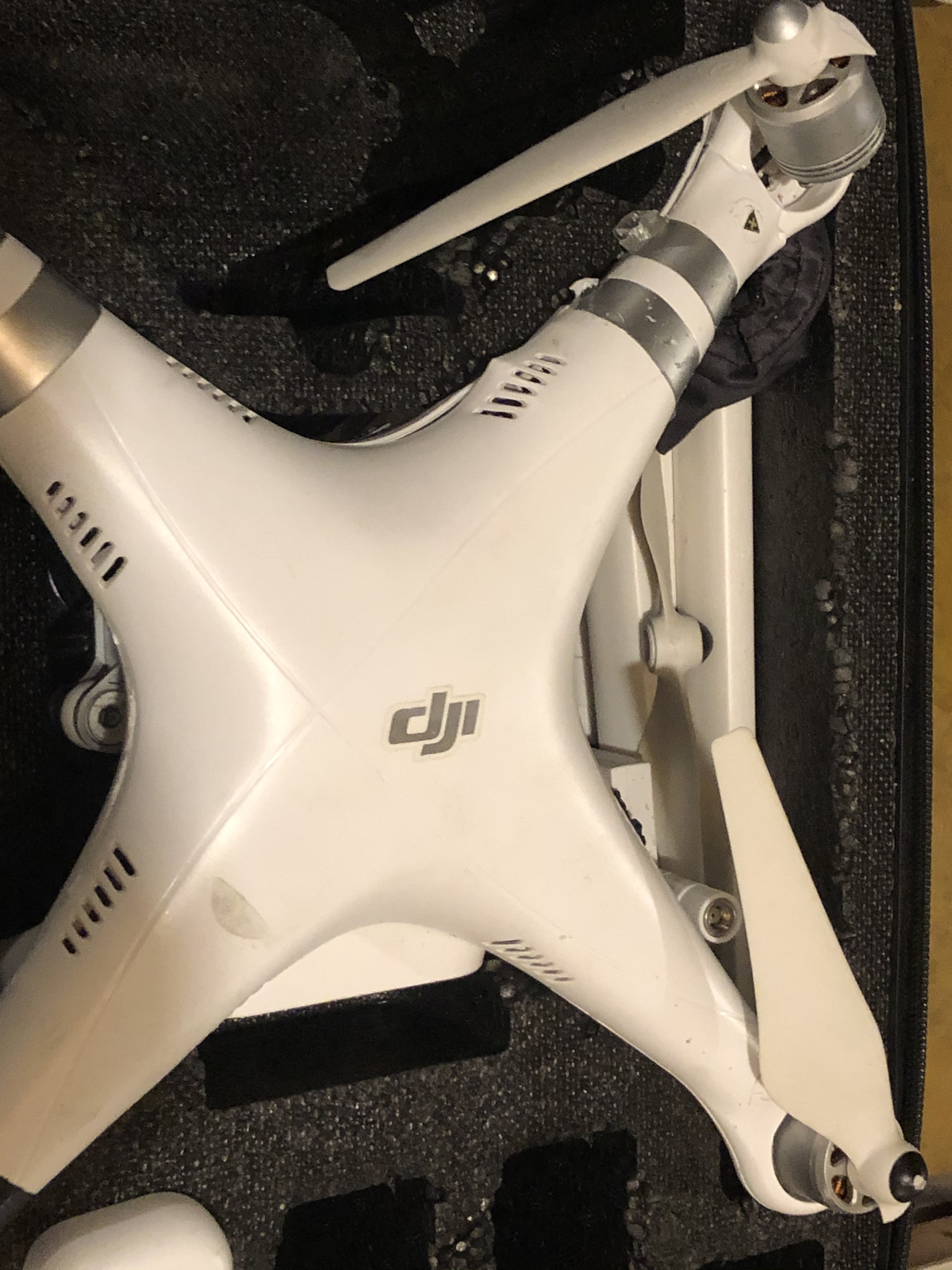

I dont suppose you have the ends by any chance, bit confused because you mention a impact before it went down mayby, its possible too that motor broke its frame on ground impact cause these a mark on the motor,,unsure till you find end to check if any mark or dent to show that it did snap,,one prop mayby but 2 props at once break similar area is ,,I not sure if silver top prop break from touching the broken black top prop but finding a end might solve that,,
Reactions: JoBe
Both of those fractures look like just that, a complete snapping off of the blade, not initiated by a stress crack, the beginning of which would have had a much smoother appearance.
One silver, one black so they were next to each other. It is distinctly possible that the one motor came loose, tilted, causing the two props to impact each other.
The distance between the blade tips when mounted is just 10mm so it would only take a very small movement of the motor to bring about contact.
A look at the broken off blades would confirm this.

I do not see an “upload” in the iPhone app for pictures when signed into my account. < EDIT solved: see below post >
Not sure on the Motor body arm “crack” but should be able to point out / take photo at home.

My bet is still that the shell had existing and significant cracks under the motors (which is not unusual) and that during flight a motor broke off of the shell. The photo shows what looks like to me are broken shell parts still attached to the motor. I guessing that the motor still had its screws in place. After the motor detached, likely the props hit each other or the prop on the detached motor hit the shell and the other prop broke on impact with the ground.

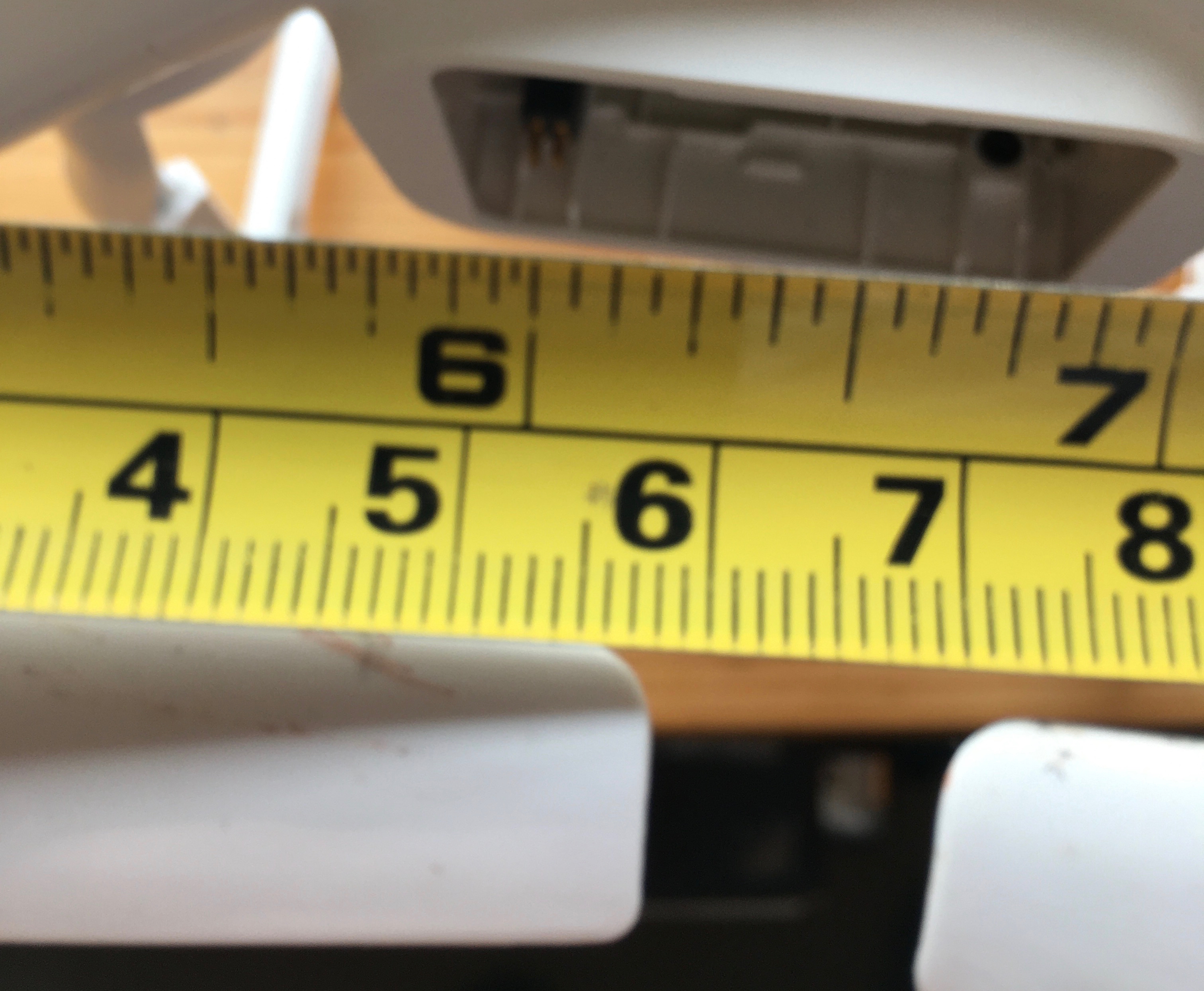

I was near the drone today so I took some more photos to eliminate arm flex and contact with body as a reason as in the second photo, its happened before I owned it.
