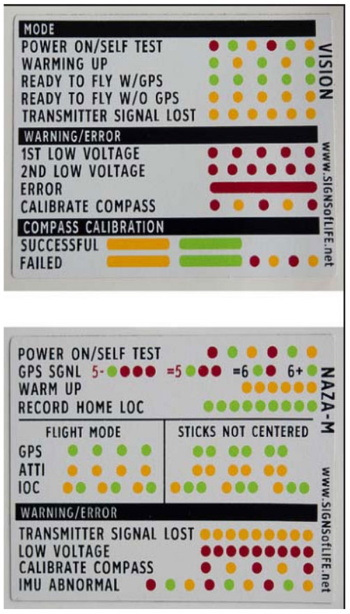

I don't understand this.... I had a full set of greens and 'home lock' had confirmed. Then [in flight] I got fast reds for a moment or two. The craft flew normally though and the LEDs went back to greens. ,,,There is only one status led on phanton
Monte55- another name I remember from the early P1 days!
Yes- I'm talking about the single status led- that changed from slow greens, to fast reds, and back to slow greens.
And then I took no chances and landed ASAP.
If this help
