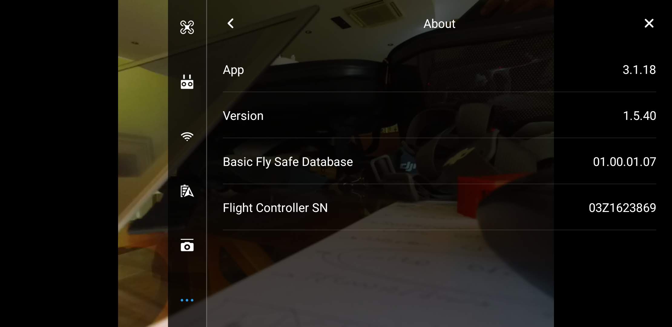

Hello guys!
On this picture, my current configuration.
I live in Italy, so my drone was in CE mode.
Thanks to you, from some time, I can fly regularly over 3 km (without any changes to the antennas).
However, I have never verified the maximum distance that can be reached.
Below is a test flight done this morning
As you can see in the return there were some more troubles
